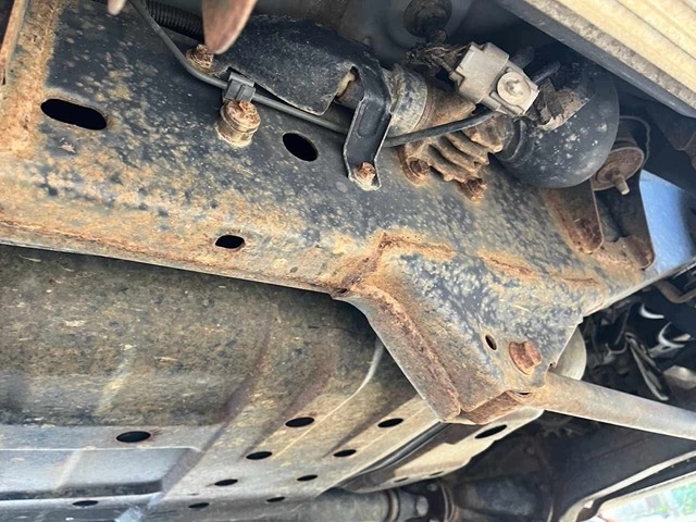

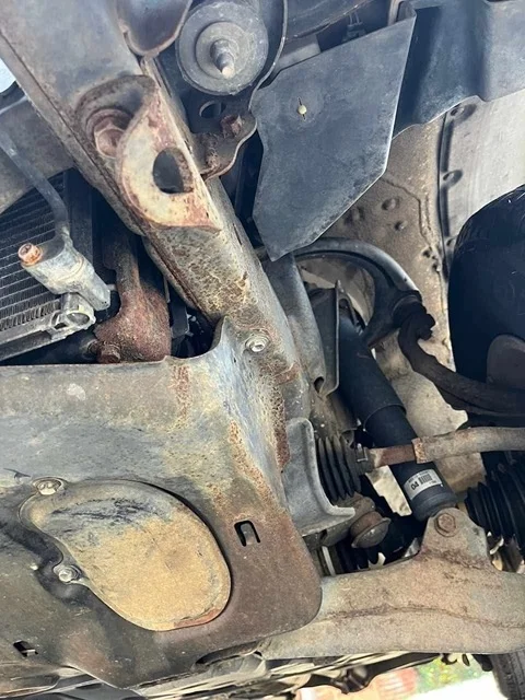

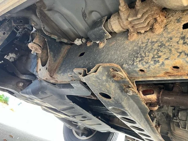

Good evening folks. I am on the hung for a 100 series and am looking for some advice on some rust on a frame. It looks mostly surface, but a lot of the bolts have rust as well so that gives me pause. It looks like the steering rack may have a wet boot in one of the photos and in another there is a connector by the globe that is disconnected. The price seems good at around 10k for 280,000 miles and the service history is not too bad on the Lexus site. This has supposedly been a southern car.

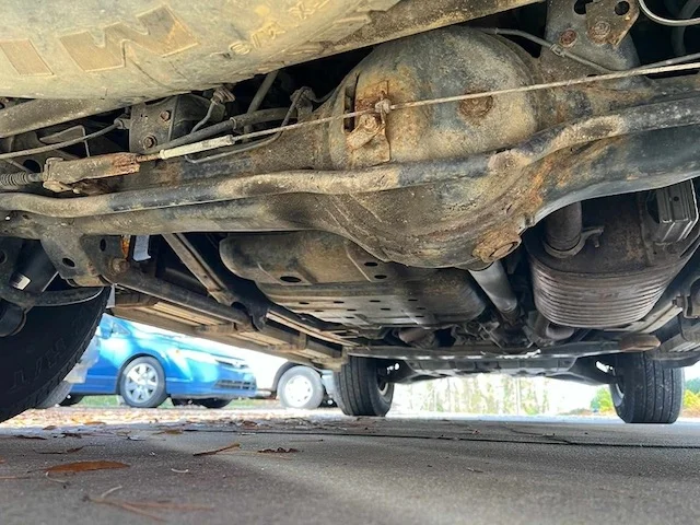

Surface oxidation... easy-peasy cleanup... Drop the spare tire and check the carrier and the crossmember just above it to be sure they are structually sund.
Thanks for the reply. I agree that it looks mostly like surface rust. I will check the support under the spare and make sure it looks ok.
In the 3rd picture you can see a connector that is unplugged. Is that related to the AHC system?

If that's truly a southern truck, it's been outside at the beach alot. Look at the cargo tie down hooks in the rear floor.

A lot of those bolts are going to break when you work on the rig. You probably can't even get a wrench on the AHC bolts. When they do break, you'll be stuck with having to drill out and re-tap the hole into the frame. I'm not sure I totally agree that it's surface rust only, as the radiator core support looks a bit compromised, as well as the body mount bracket. The welds on the bottom of the frame also look pretty rough. It's probably worth it to put a inspection camera inside the frame and see if it might be rusting from the inside out.
I'd probably pass on it for ease of wrenching unless it's a smoking deal. It appears the PO never washed the underside of the rig and the rust isn't going to get any better. If it is a smoking deal and you do get it, I'd thoroughly pressure was the frame and coat it inside and out with Fluid Film/Woolwax. That approach has preserved the frame on my GX470, which was somewhat less rusty than that LX, but not exactly mint either. And be ready to deal with breaking fasteners (I've broken a number myself).

The plug looks to be in the area where the running board lights hook into the harness. AHC is further back, if I remember correctly.
Don't be afraid of a little surface rust on bolts. Heat or PB Blaster will loosen those up without issue. It's a 20+ year old truck that has been driven and used as intended... expect imperfections and issues. Garage queens with perfect interiors, exteriors, floor pans, frames, nuts, bolts, parts and such... sell for over 50K, 24k-Mile 2007 Toyota Land Cruiser UZJ100 - https://bringatrailer.com/listing/2007-toyota-land-cruiser-33/ and 21k-Mile 2001 Toyota Land Cruiser UZJ100 - https://bringatrailer.com/listing/2001-toyota-land-cruiser-54/ and even they have "a little surface rust" that some one will complain about!

The rust on the AHC bolts is not surface rust. The bolt heads themselves are more or less gone. Those aren't coming out with some PB Blaster. They'd need to have the heads ground off, have the bolt drilled out, and then re-tapped. The flare nuts on the AHC lines are the same - no ways those are coming out.
This is coming from someone who has broken a number of rusty bolts on my rig. At this point I've turned just about every bolt underneath the rig via a full suspension replacement, exhaust replacement, etc and Woolwaxed/Fluid Filmed it, so I'm more or less past breaking things now.

You guys see the front tow hook/ recovery point is completely bent in. How does something like that happen?
Since it doesn't appear to have been impacted (i.e., hitting something), I'm betting it was used to either pull the LX out of something or pull another vehicle out, and side-loaded. Those "recovery points" are really tie down points when these rigs are loaded on the ship to their end-market voyage. They aren't designed for recovery and definitely aren't designed for side loading.
