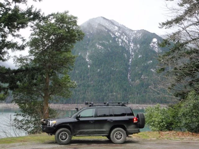

On a side note, JB any pictures of your 200 with the new shoes?
Sbly
Sbly: If I decide to turn my 200 into a dedicated trail/tour rig, mine will be the white version of yours. Impeccably done from tires to roof rack.

If I can help just let me know. As for my truck, I wish I could take the credit for my build but to be honest it was the a combination of Iron Pig Offroad, and everything I read hear on MUD that helped me get it put together. It was guys like chimyz and JB who laid the ground work and provided a lot of the information.

Thank you, that would be most appreciated. That said I'm probably a ways off to be honest, it's just that seeing your truck fully decked out has always gets me planning.
