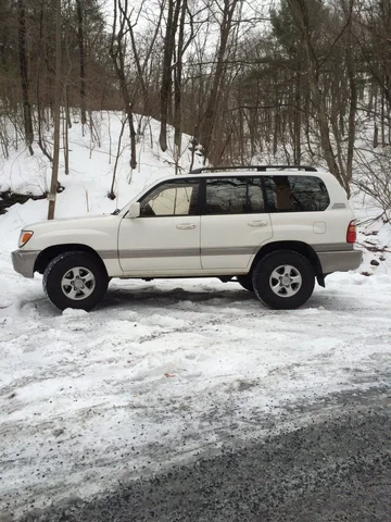

I have a similar but not identical setup to yours. 865s in the rear, stock original t-bars, nitrochargers all around. Early Slee blueberry bumper, no winch. The springs, shocks and a t-bar adjustment happened at approx 165K. Approx 175K right now.
I left a rake of about 1.5" lower in front. The ride is fine. Not plush of course but who would expect that? Leveling or close to it will give you a much harsher ride up front, and push your t-bars harder, so I would plan on a rake of 1.5" or so.

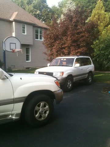

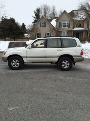

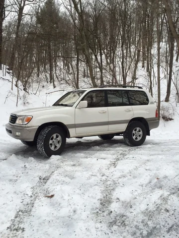

Thanks for all of the responses and suggestions. The suspension is finally on and I have to say.. best $500 I've spent in a while. The improvement over my worn out stock components is night and day. The ride is certainly firmer but its not jarring by any means. I have not gotten a chance to test it out on anything more than a dirt road however I have to say the product is well worth the price if you are looking for a suspension upgrade. I'm actually not overly cautious cornering anymore. Originally I was scared about the 860's however the truck actually sits nicely and more importantly does not sag at all when loaded!
Looking forward to getting out there this summer and hopefully attending a trail run event or two hosted by some of you guys.
The rear probably went up over 3 inches and the front t-bars came up about 1-1.5 with some cranking room left.
Pics:
