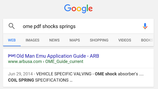

Sorry for the confusion, what a ride this has been. Hope this helps. Below is how I found the pdf, if I figure how to get the link I will post it.
http://www.sleeoffroad.com/installation/ome_spring_specs.pdf
