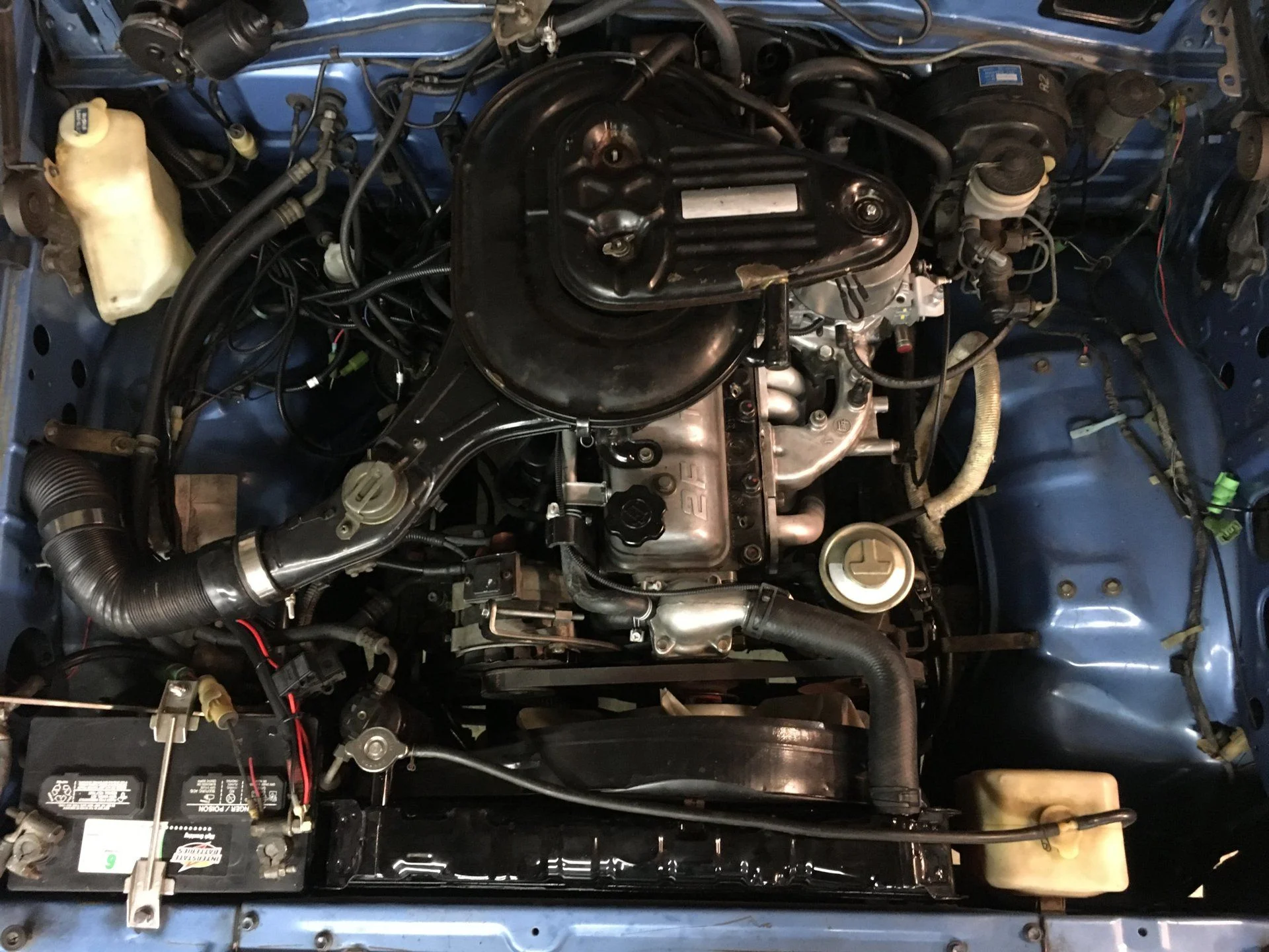

I have to chase down a manifold/adapter leak that’s causing this high pitched noise you hear in the background but it’s just purring away seating the new motor.
My mechanic friend suggested I let it Idle for 15 minutes and then let it cool good to oil the new motor.
Good news is, I should be able to chase this down pretty easily on Friday and start driving it some.

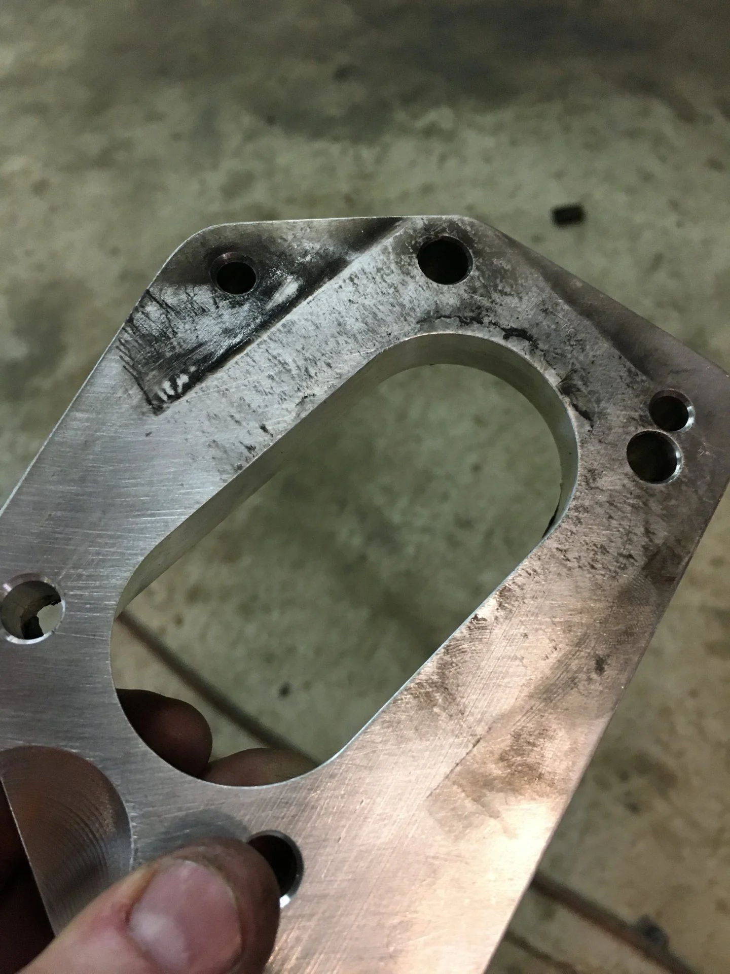

Ive isolated the leak to the base of the adapter with some targeted carb cleaner. I don’t remember what kind of gasket was there. May be a Toyota paper carb gasket. If so I’ll replace that with RTV to cover and inconsistencies

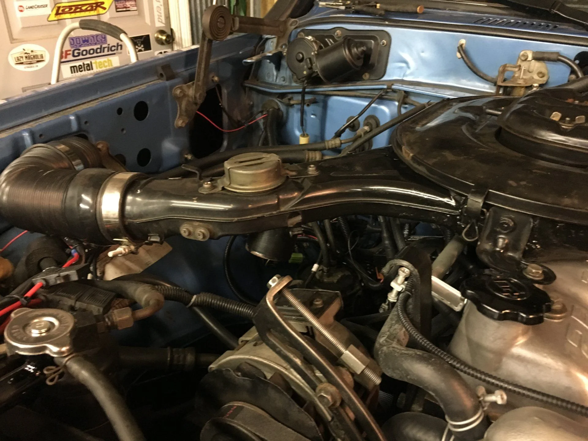

I buttoned up the engine bay.

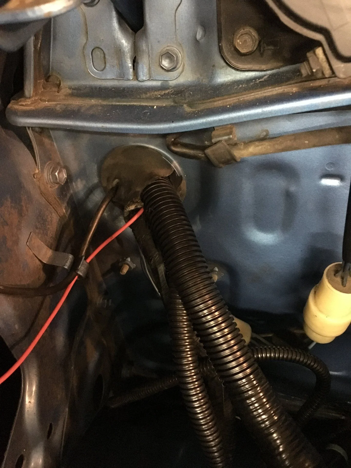

Installed the grommet. Installed the washer res. Installed the snorkel tube.

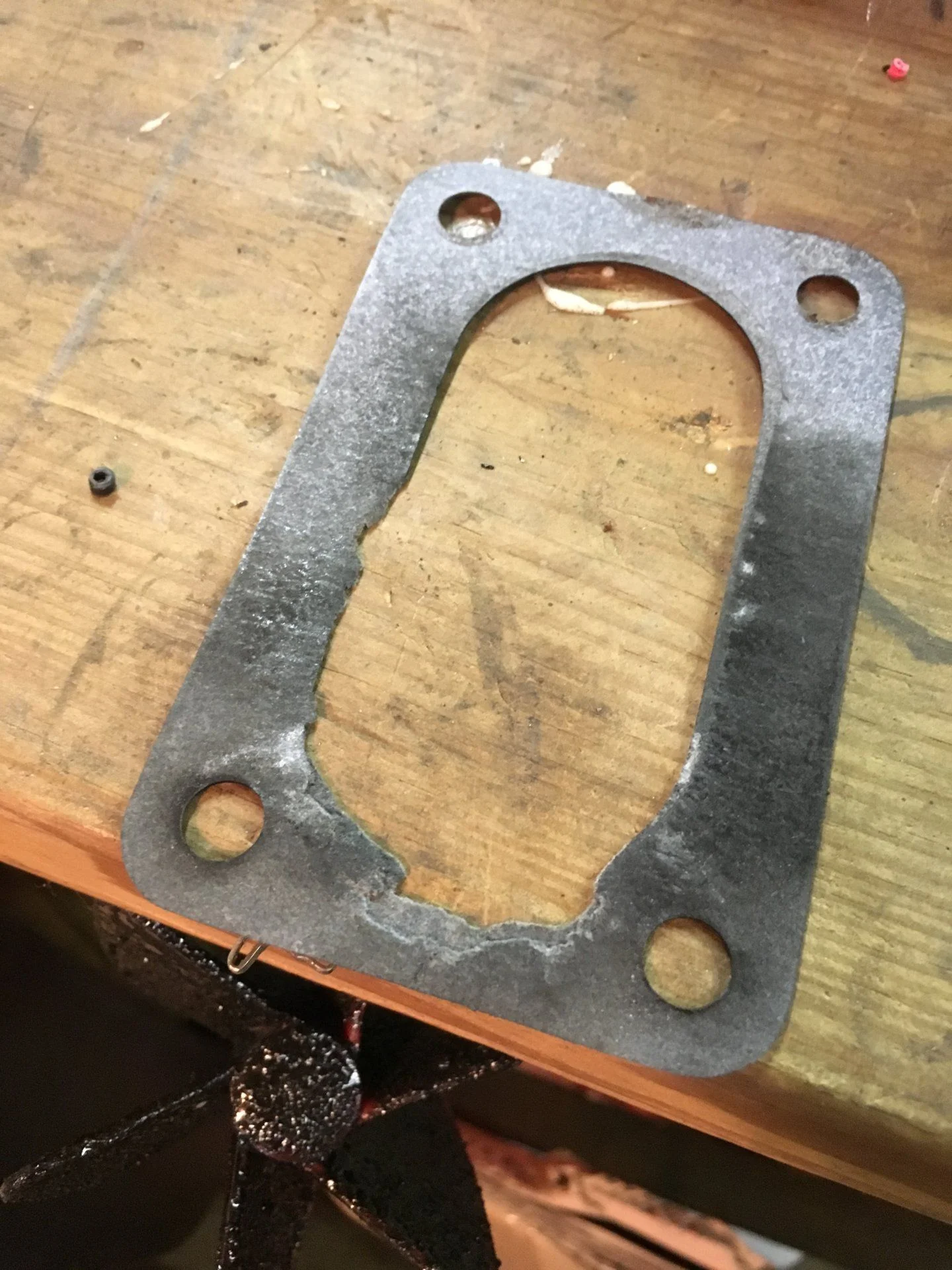

I took it all apart and sure enough, the manifold gasket was already toast.
You can see where the gasses were passing.

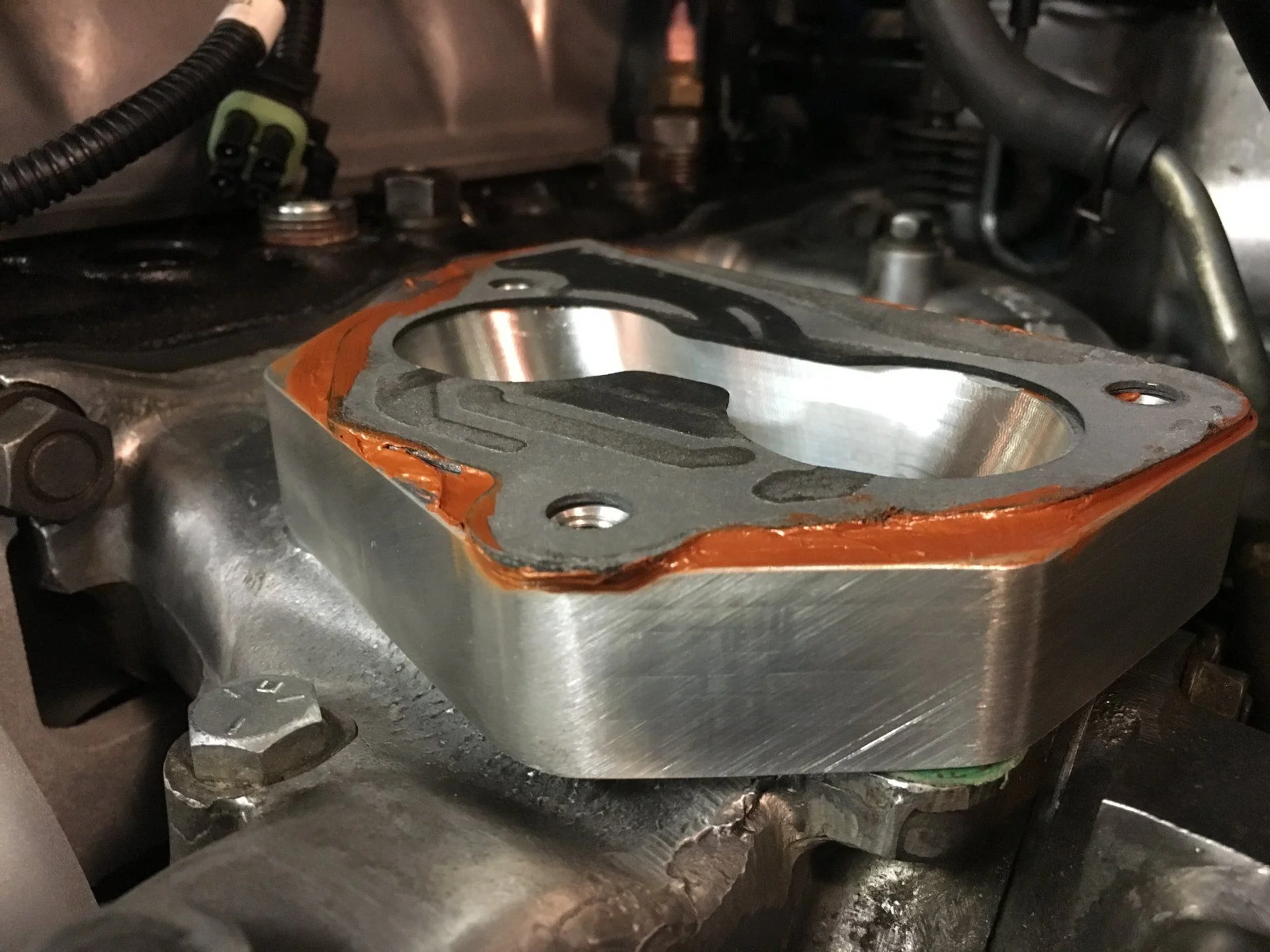

I found a new carb/intake gasket that was much thicker and installed on super clean surfaces.
I filled the screw holes with RTV, installed the paper and RTVed the edges all around.
Buttoned it up and it’s almost right. There is still a slight whistle and if I push real hard up and toward the motor it goes away.
I wonder if Ramflex makes a thick intake/carburator gasket? These thin paper ones are just not very good for mating these old parts with new parts.

Nolan you know what? I think I might have had this issue as well. I vaguely remember the countersunk bolts for the adapter were too long and bottoming out in the intake. Any possibility you're having same issue?
This is a yes. They were just flush. I added RTV to seal them.
When I get more gaskets from AFI I will cut them down a hair and retry.
