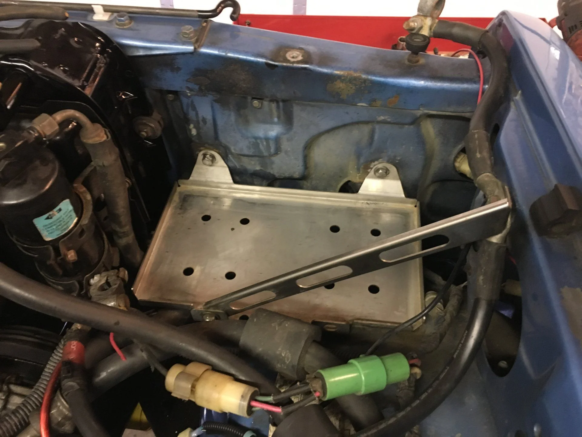

I’m not sure if Dearborn is still alive but his Stainless tray and
Battery wire kit was/is a work of art
That's a stainlesstrays.com tray. They are excellent. They are made by a guy named Noell, and I think he's in Reno. Absolutely the last battery tray you will ever need. I notice he's all out of 60 trays right now-hopefully he will make more.

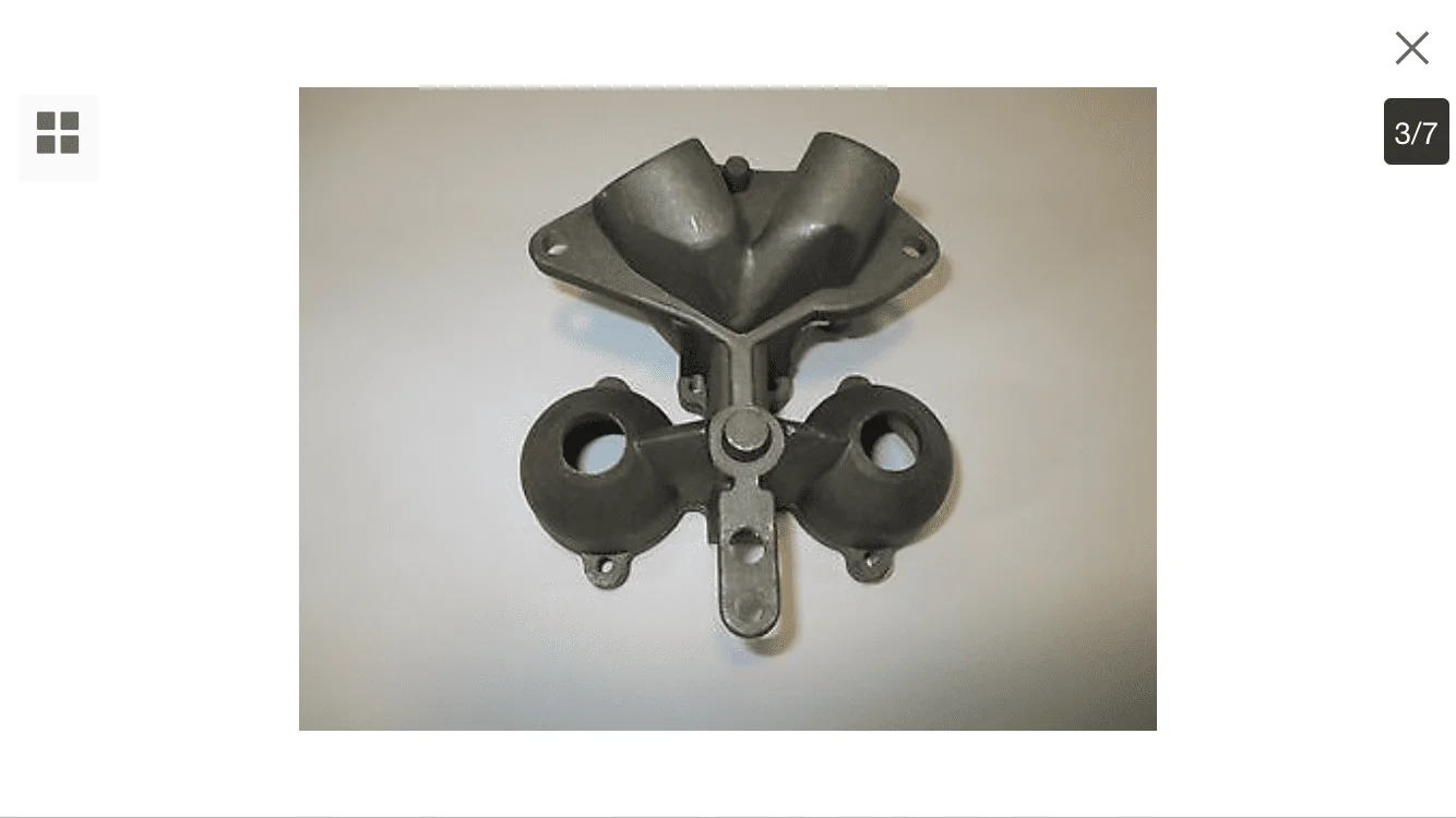

Even if the TBI housing was not
Broken

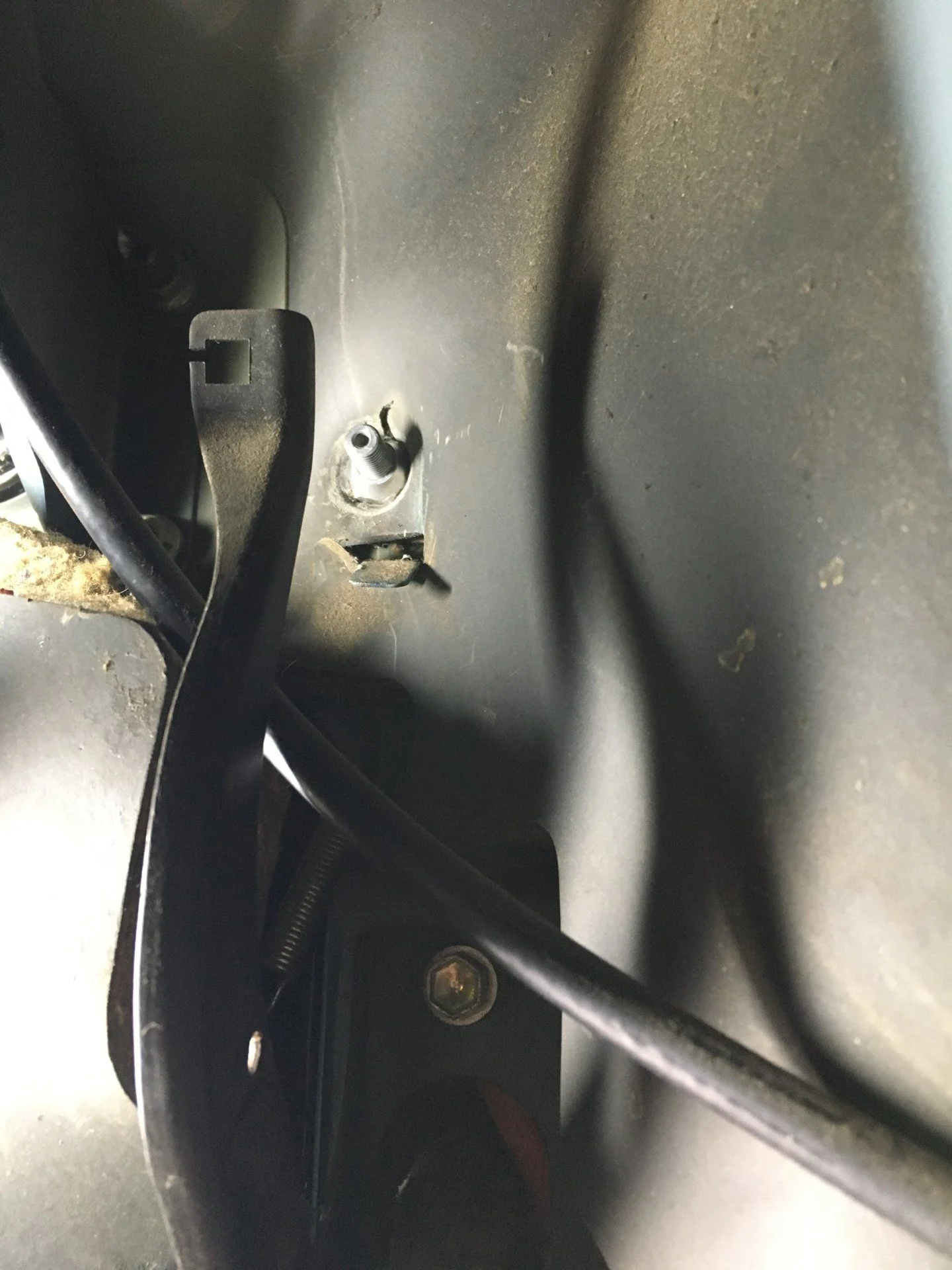

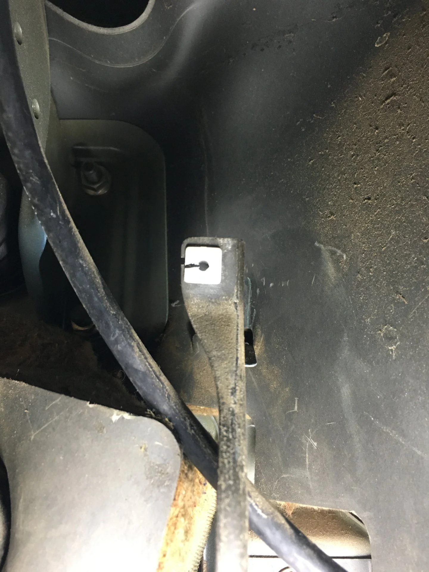

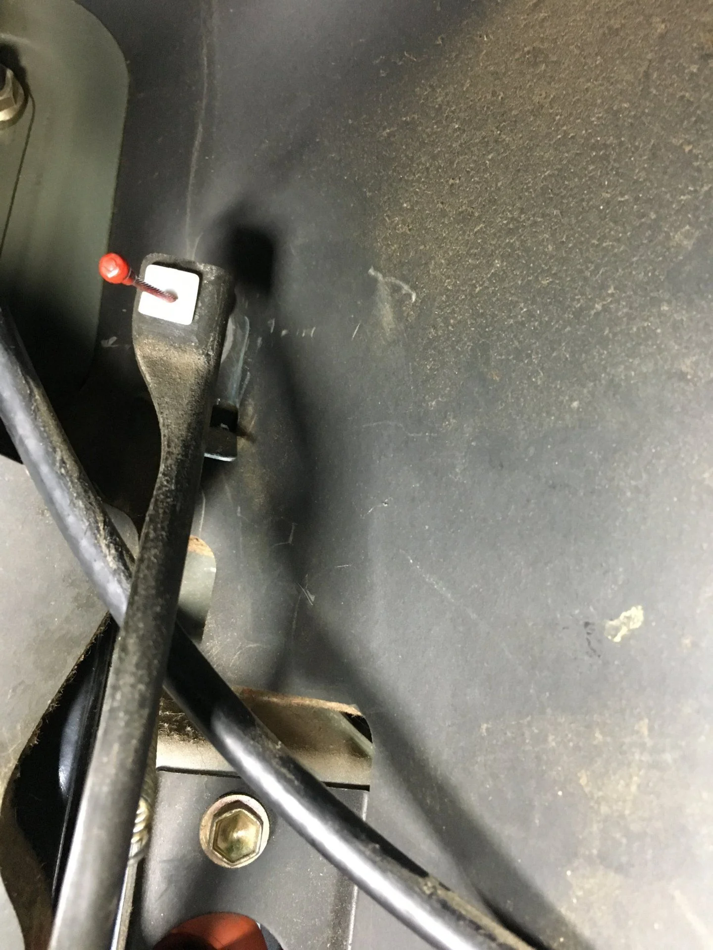

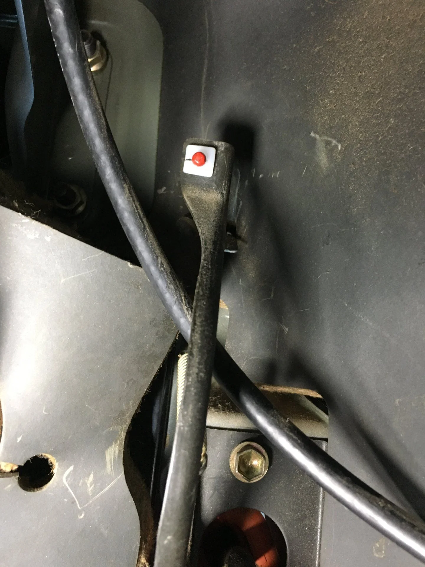

Here’s how we hooked up the throttle cable...
First, drill a hole in the firewall behind the hole in the hand throttle arm in the FJ60 gas pedal, sized for the throttle cable end.

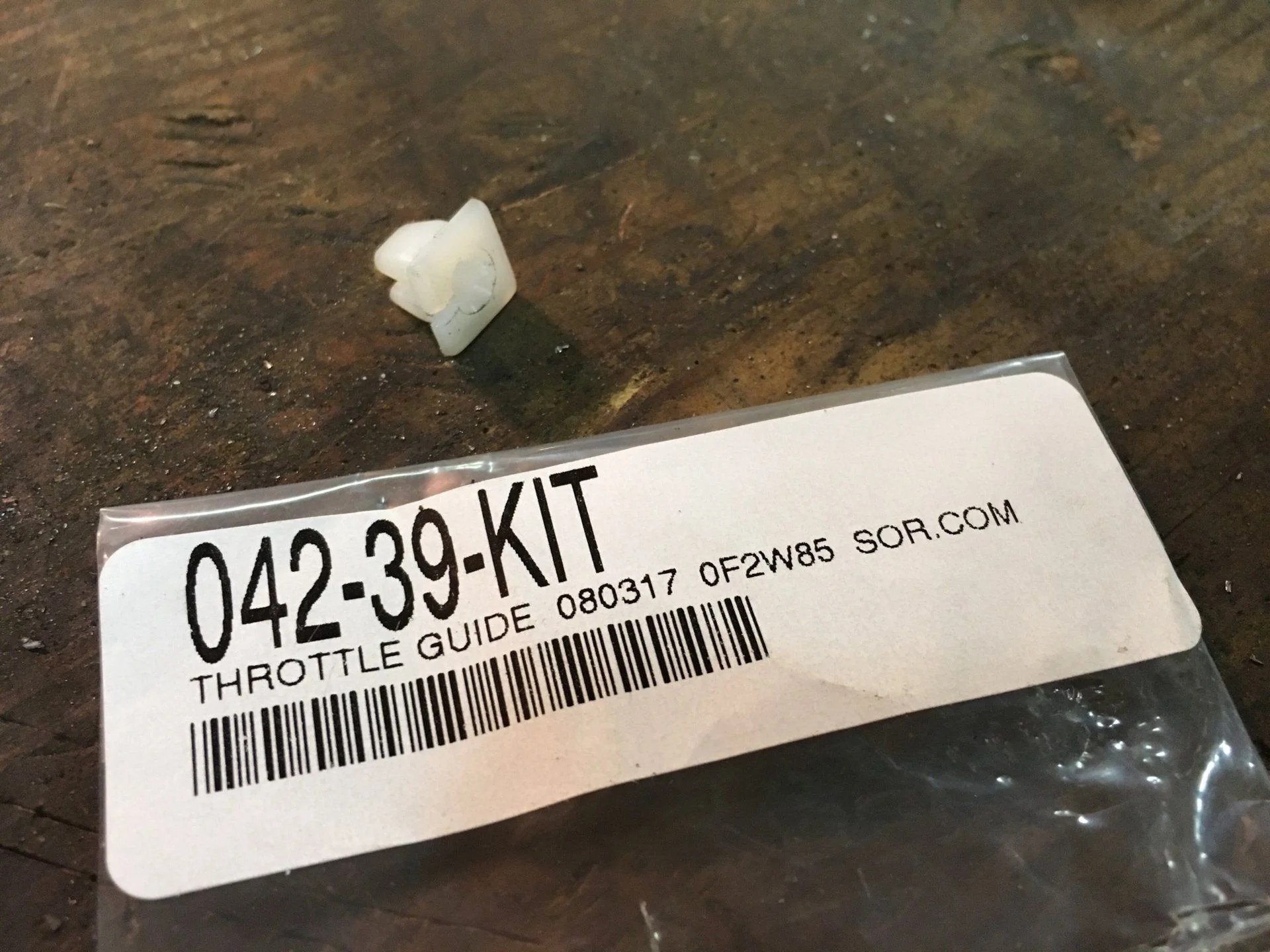

Then, you’ll need the factory plastic clip that is designed to clip the hand throttle cable into the top of the gas pedal (discontinued, only available from $OR):
This clips into the pedal:

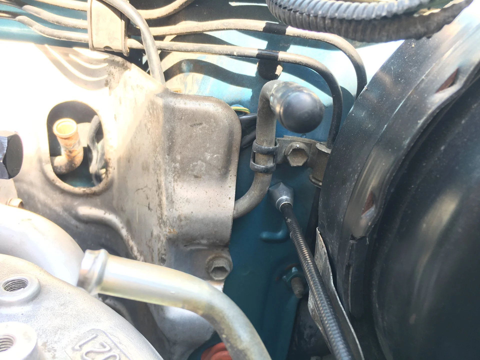

View from the engine side of the firewall (you’ll have to clearance the brake booster heat shield with a hammer):
continued...

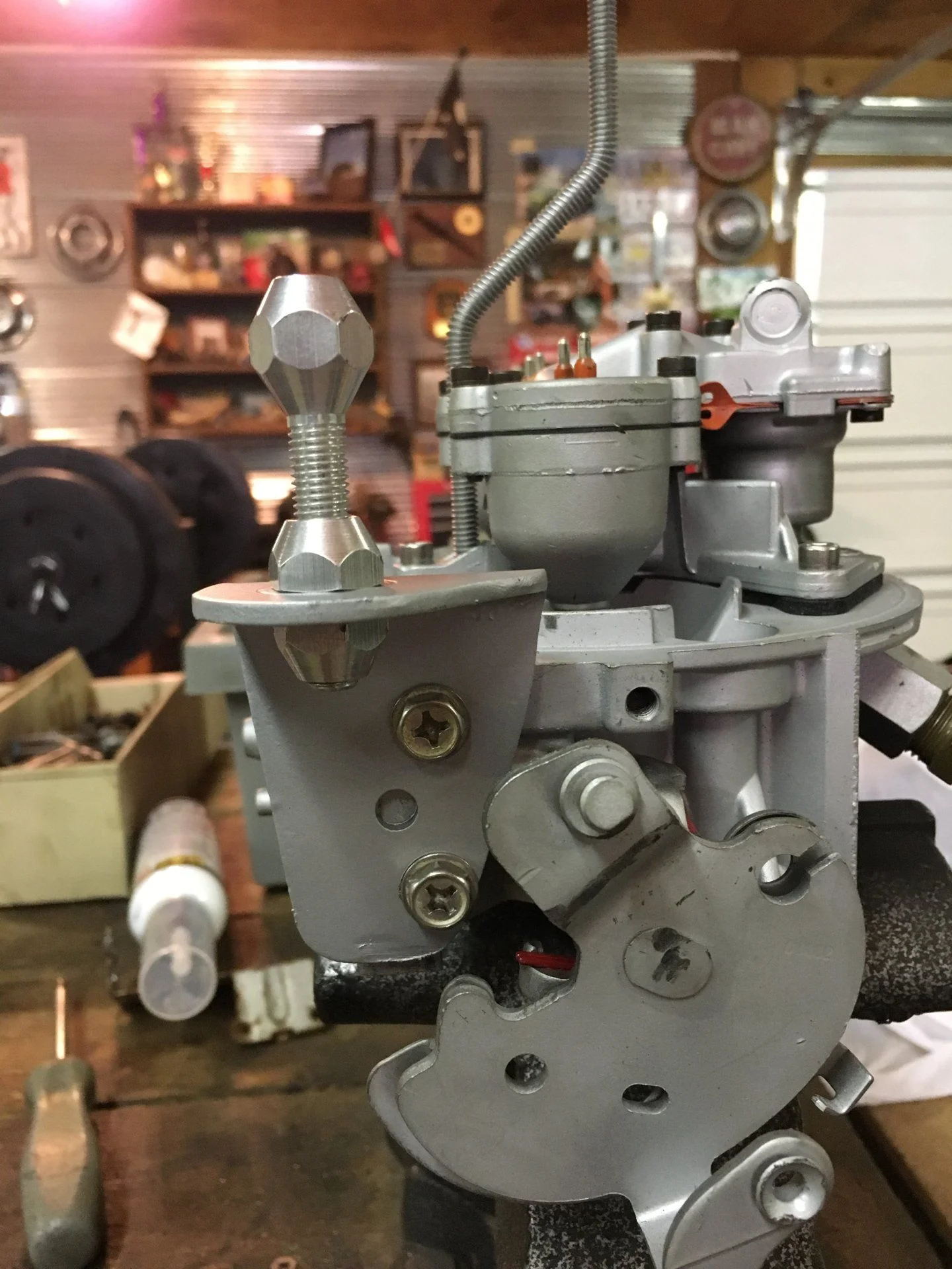

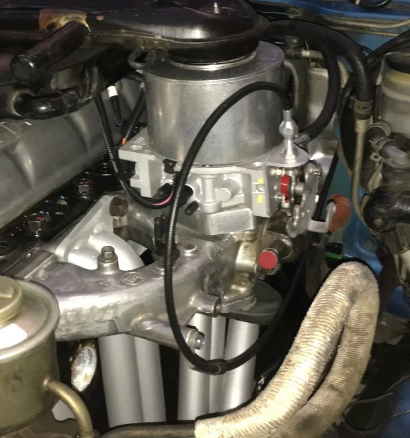

You’ll need to fab a cable bracket for the TBI:
Next, feed the cable through from the inside, passing through the plastic pedal clip:
Pull tight from the engine side:
Connect to TBI & terminate with a cable stop from the Autozone help section. Repurpose old cable clamp & mount to intake to keep cable from flopping around.
Done!

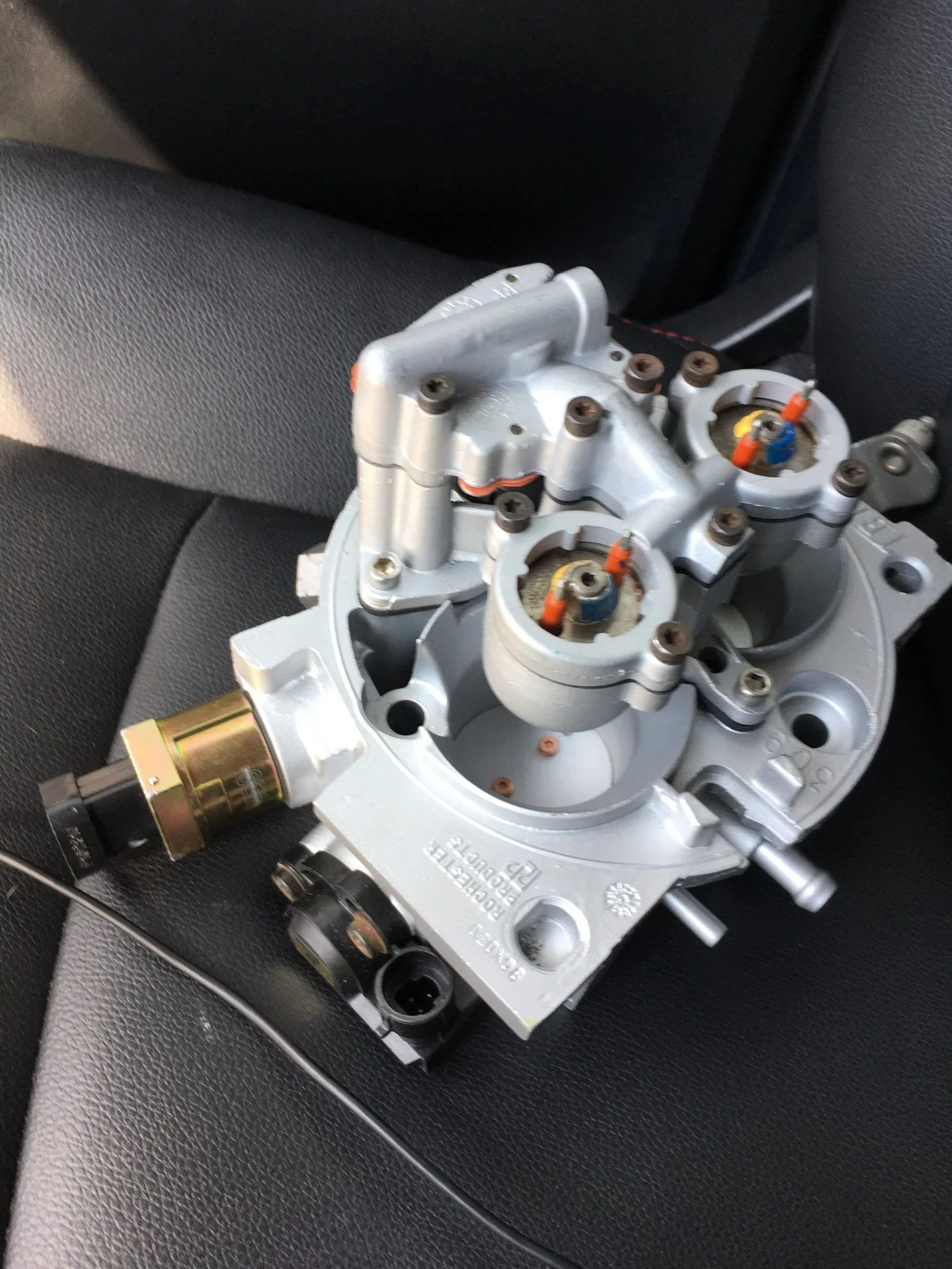

[QUOTE="wngrog, post: 11226680, member: 1427"
A local guy I barely know but have been in close contact with during the build has offered up his AFI throttle body to me until they fix mine and return it. He bought a kit when I did and is waiting on the local machine shop to finish his motor. Thank you @maxbob002[/QUOTE]

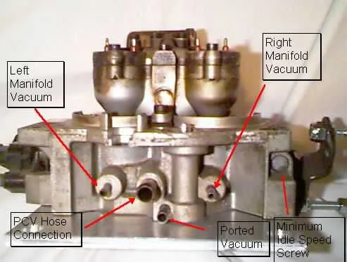

The ported vaccuum is where charcoal canister goes as best I have found searching around.
Dammit. I did this EFI and DUI to get rid of the STUDID VCV......
God almighty. Really? Why does a charcoal canister need all that crap?
Or maybe that's where the charcoal purge VCV 's' port needs to hook up....hahaha!!!:rofl:
Similar type clips are used to hold screws for mounting headlight bezels and turn signal lenses. Maybe one of those could be modified to work. If the right size, or close enough, only a notch would need to be cut through one side to accept a cable.
