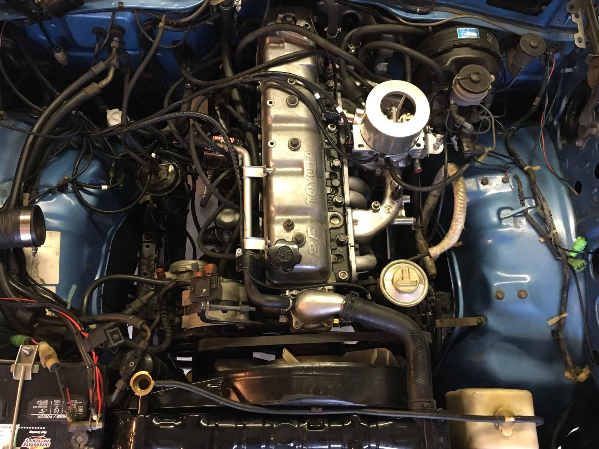

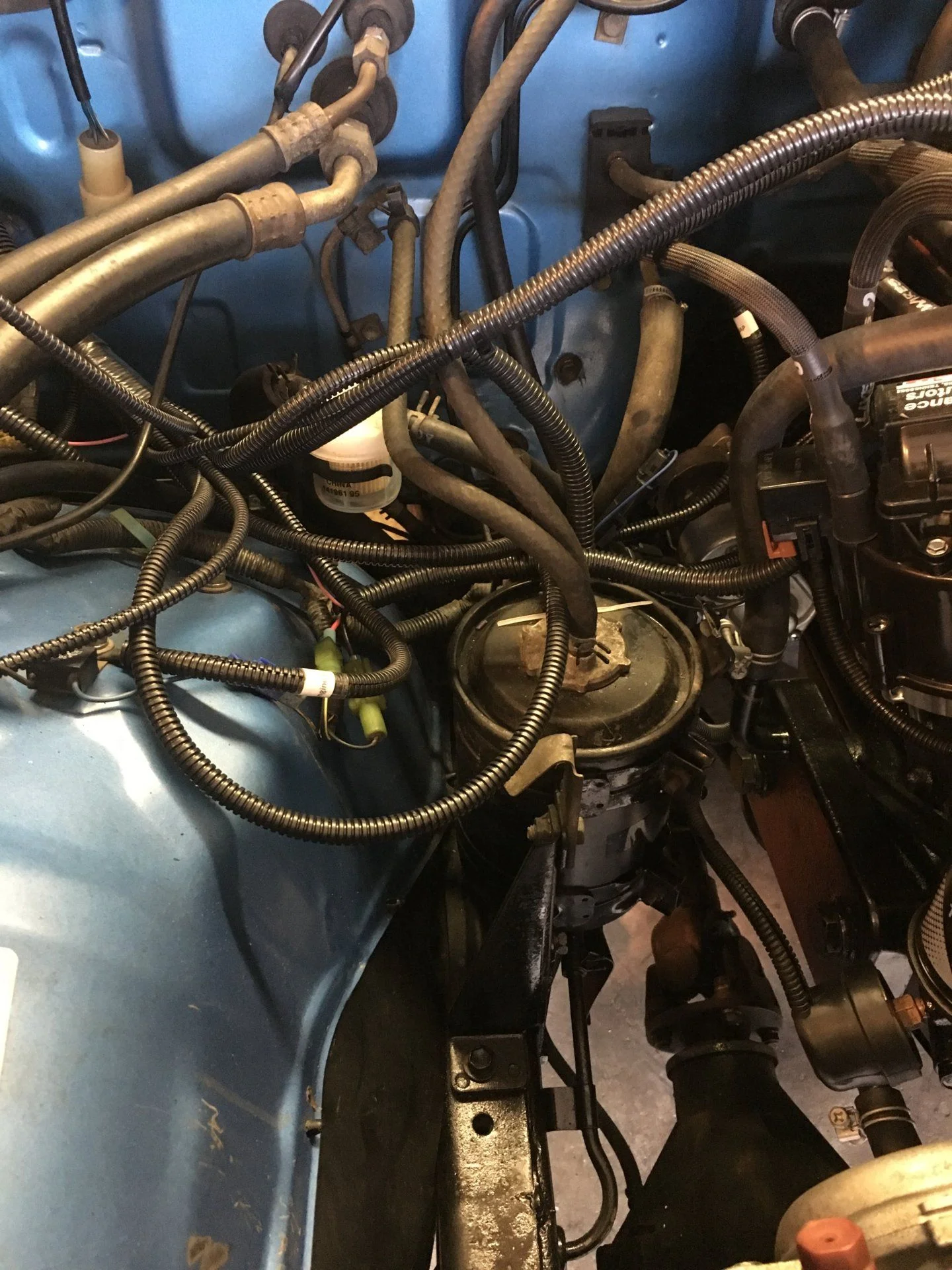

I took the good TBI home and stuck it on.

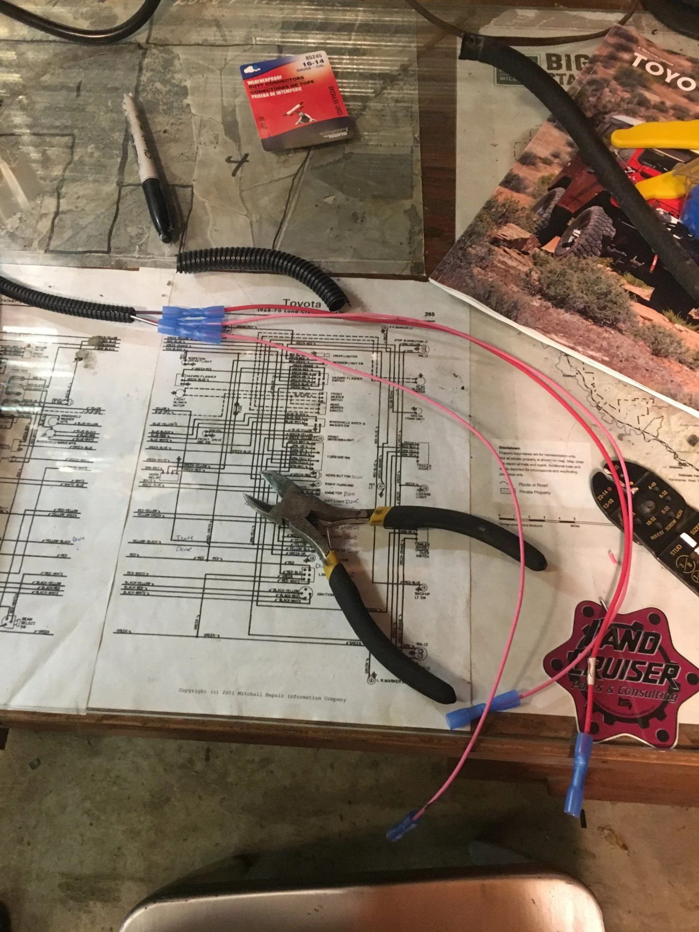

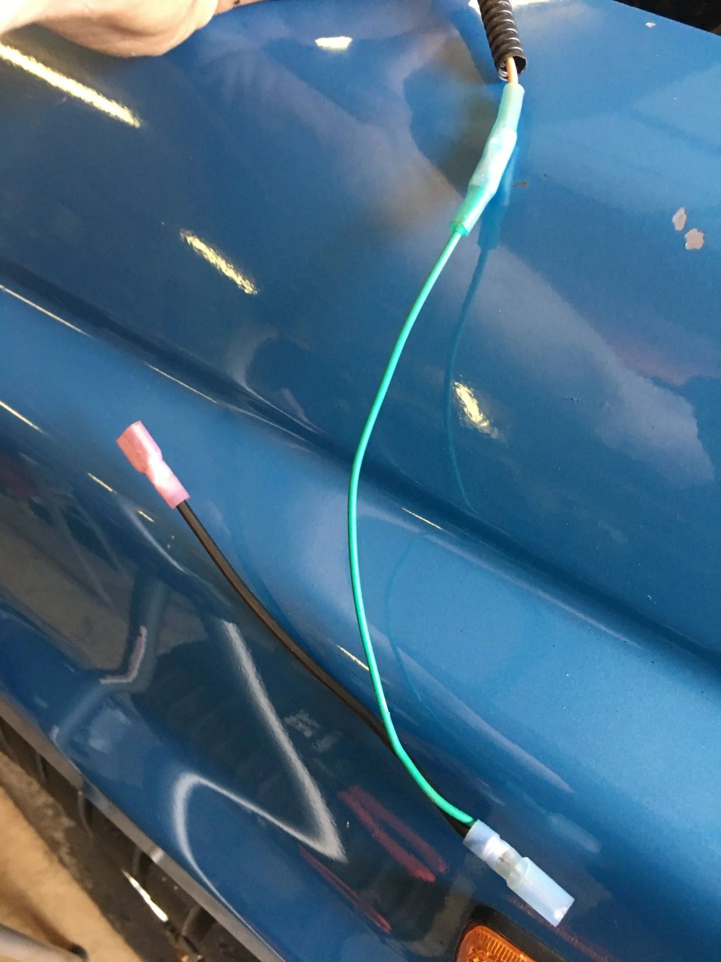

I think AFI makes the harness with the intention that you mount the computer on the drivers side because a couple of the sections were too short. ECT and O2

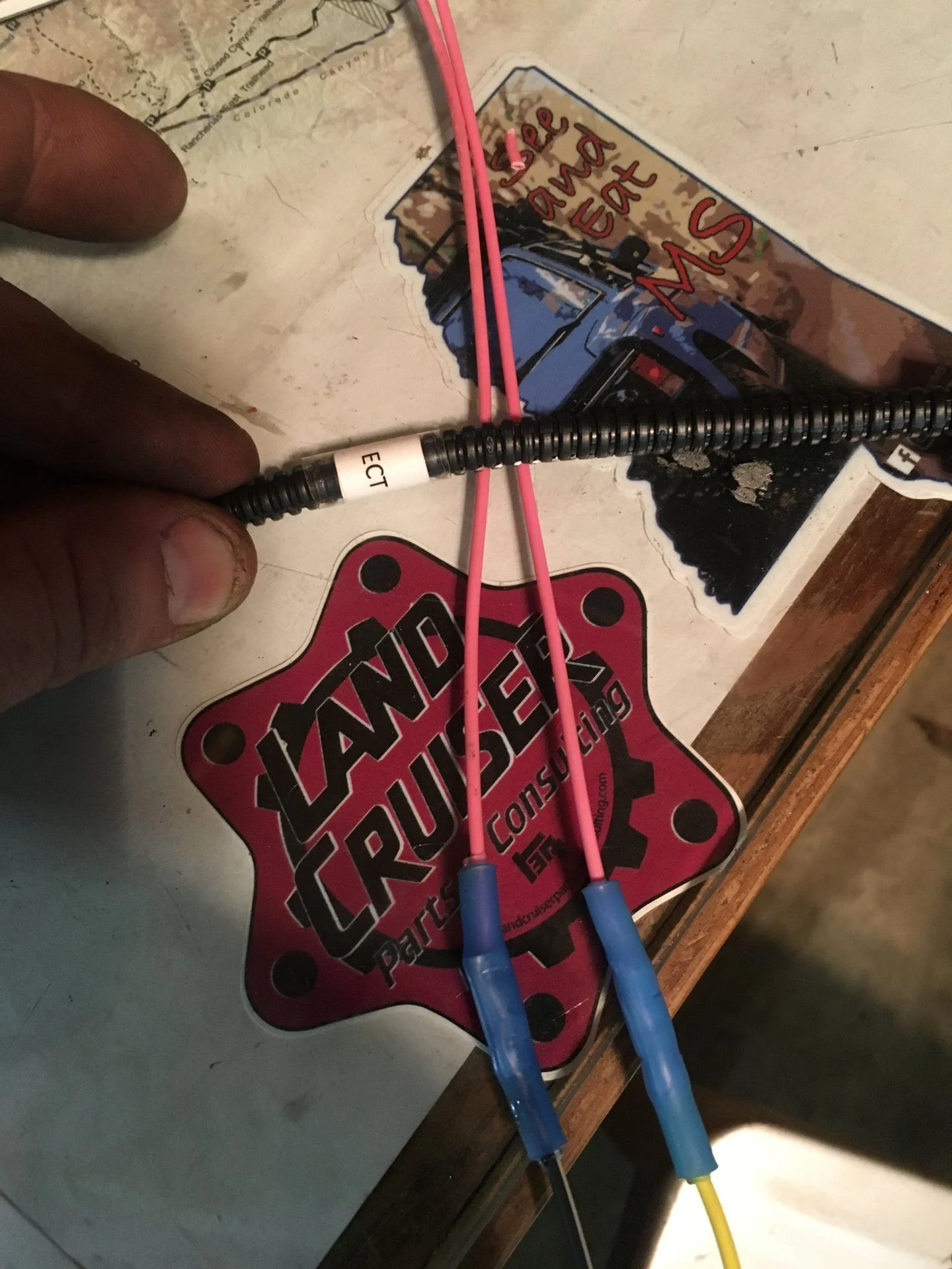

I added 15” to the ECT and ran it down the water tube to the thermo housing
Next I added 18” to the O2 sensor and ran it under the motor between the clutch cover and oil pan

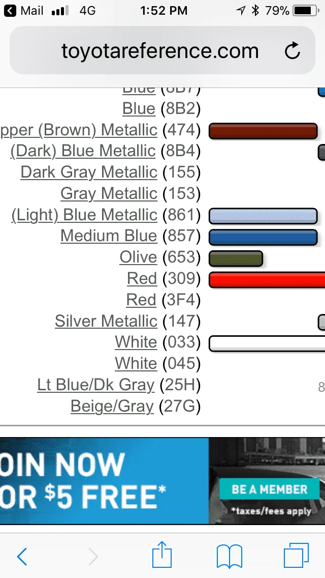

At least you can just repaint the hood now instead of the whole truck.
Yep. I really didn’t want to do all that. I like my beater 20’ truck
I’ll take the bumper off and let him spray it and the valance and the fronts of the fenders that are buggered up

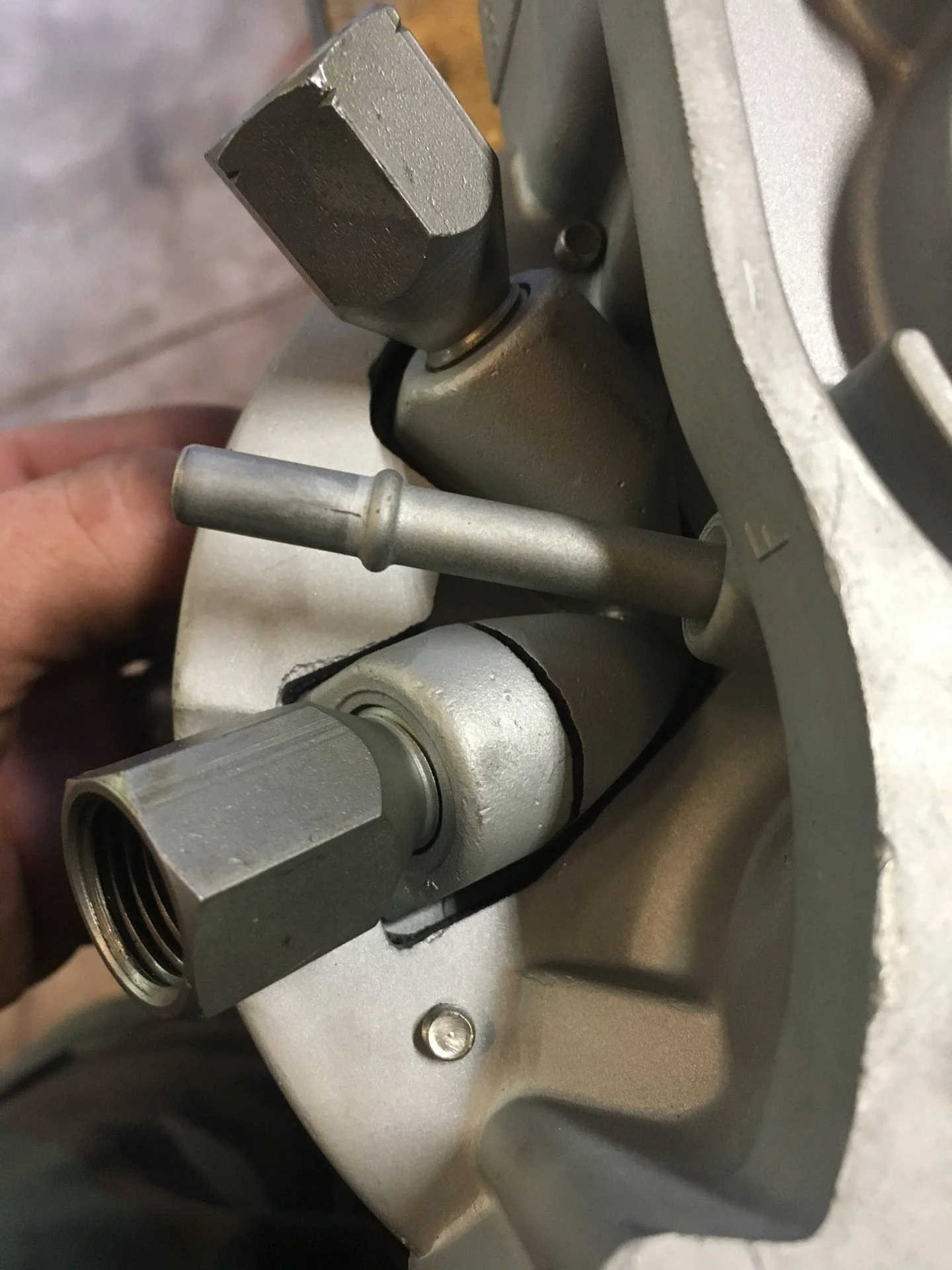

The only thing I discovered is that this is a 85+ which uses a smaller radiator cap than the 84. It also has a cooler integrated that I would not use for anything personally.....I plugged mine.

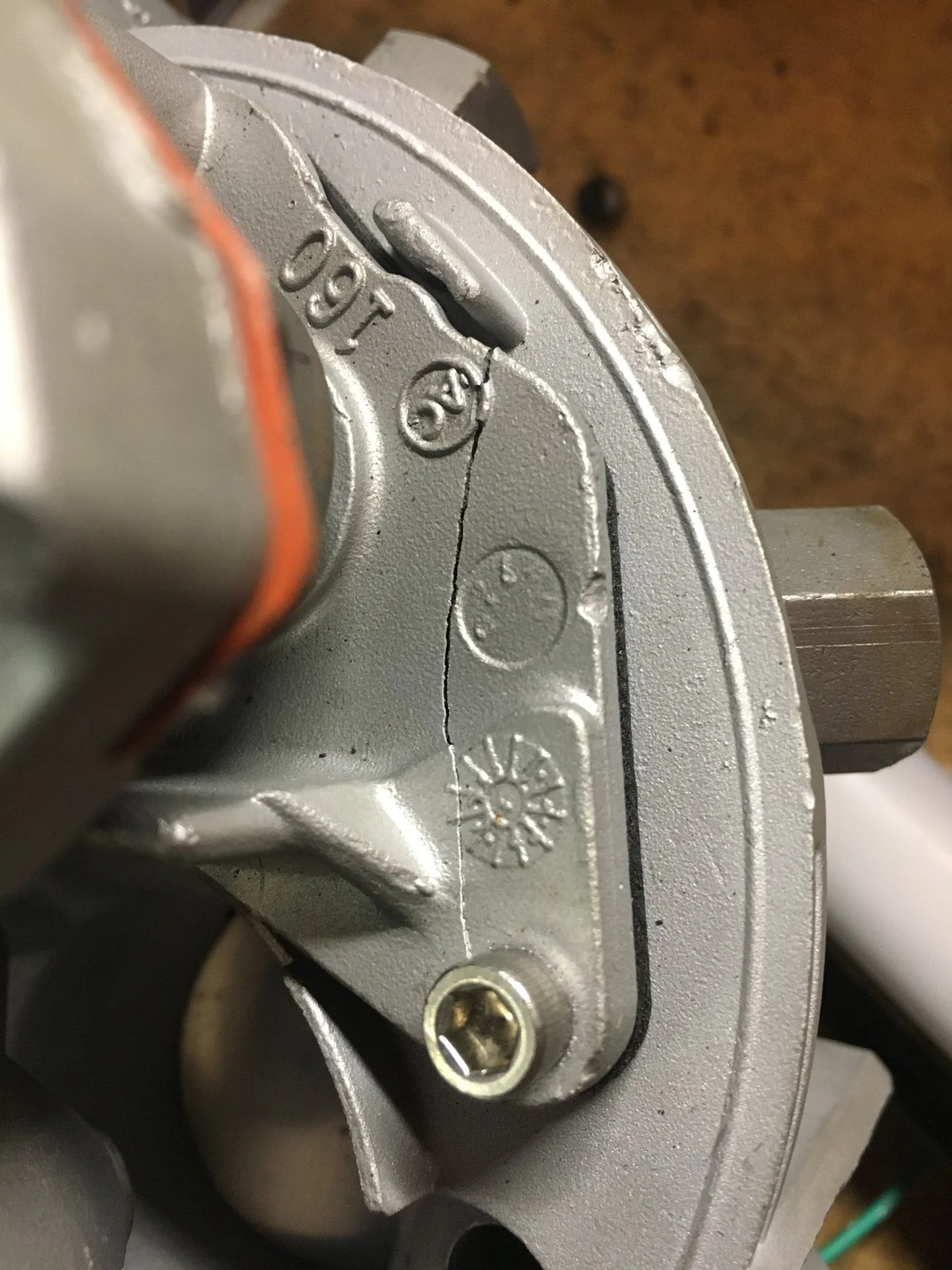

AFI is going above and beyond to fix the broken part FYI. They offered to just send the injector pod out immediately but since the part is going back to @maxbob002 i wanted them to build it back and test it. He said he had never seen such a failure.

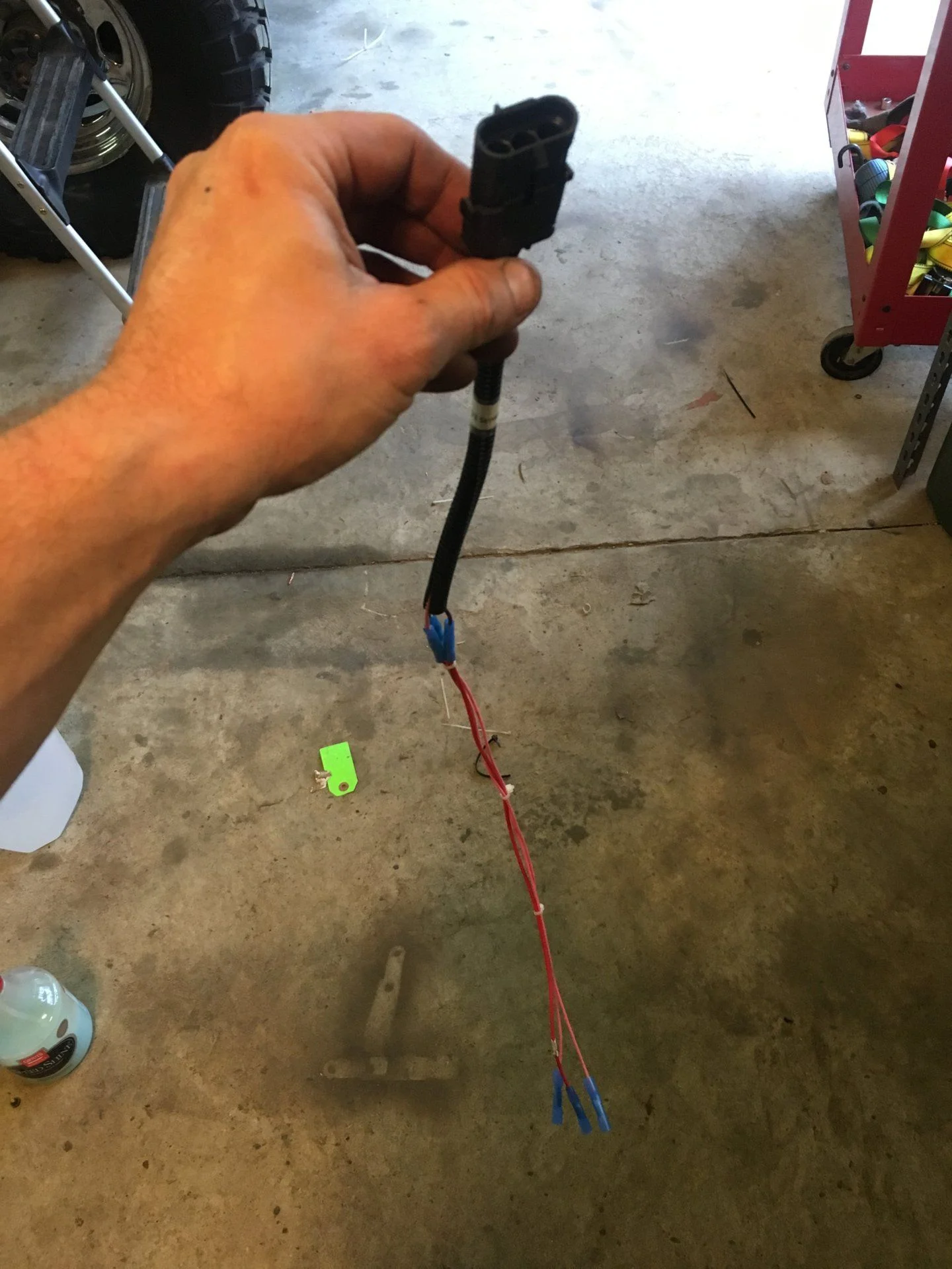

I got the last pigtail wired in. I just made a jumper patch to bring in the crank wire sensor to the alternator.
