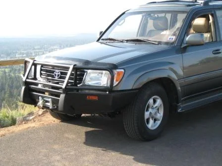

I have watched the forums for a while and never posted. However, literally yesterday I just added an ARB front bumber with the Tmax 9000 winch and I added Bilsteins a month ago. I can tell you that I can feel the difference in the front end. I like the new shocks. While they are a little stiffer it seems like the response on them is better.
The front end is definately heavier with the ARB and it feels a little like it is nose low from the sight profile. I have not adjusted the T bar at all. I guess it should be and if I dont, will it have an effect on the front tires? I tried to post a picture but my file size is too large. I can change it if anyone wants to see.
