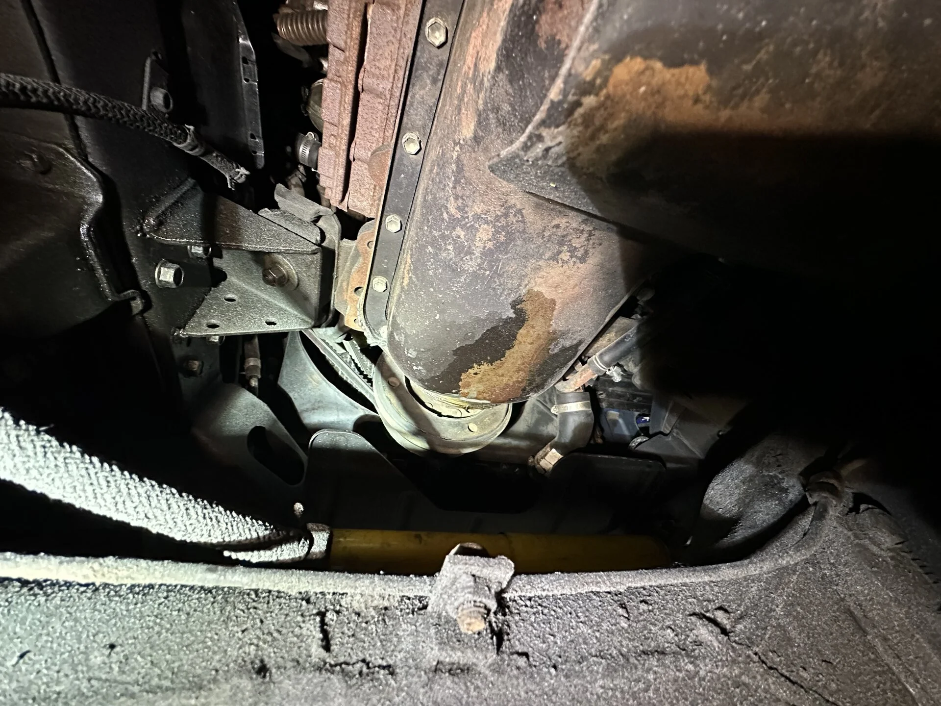

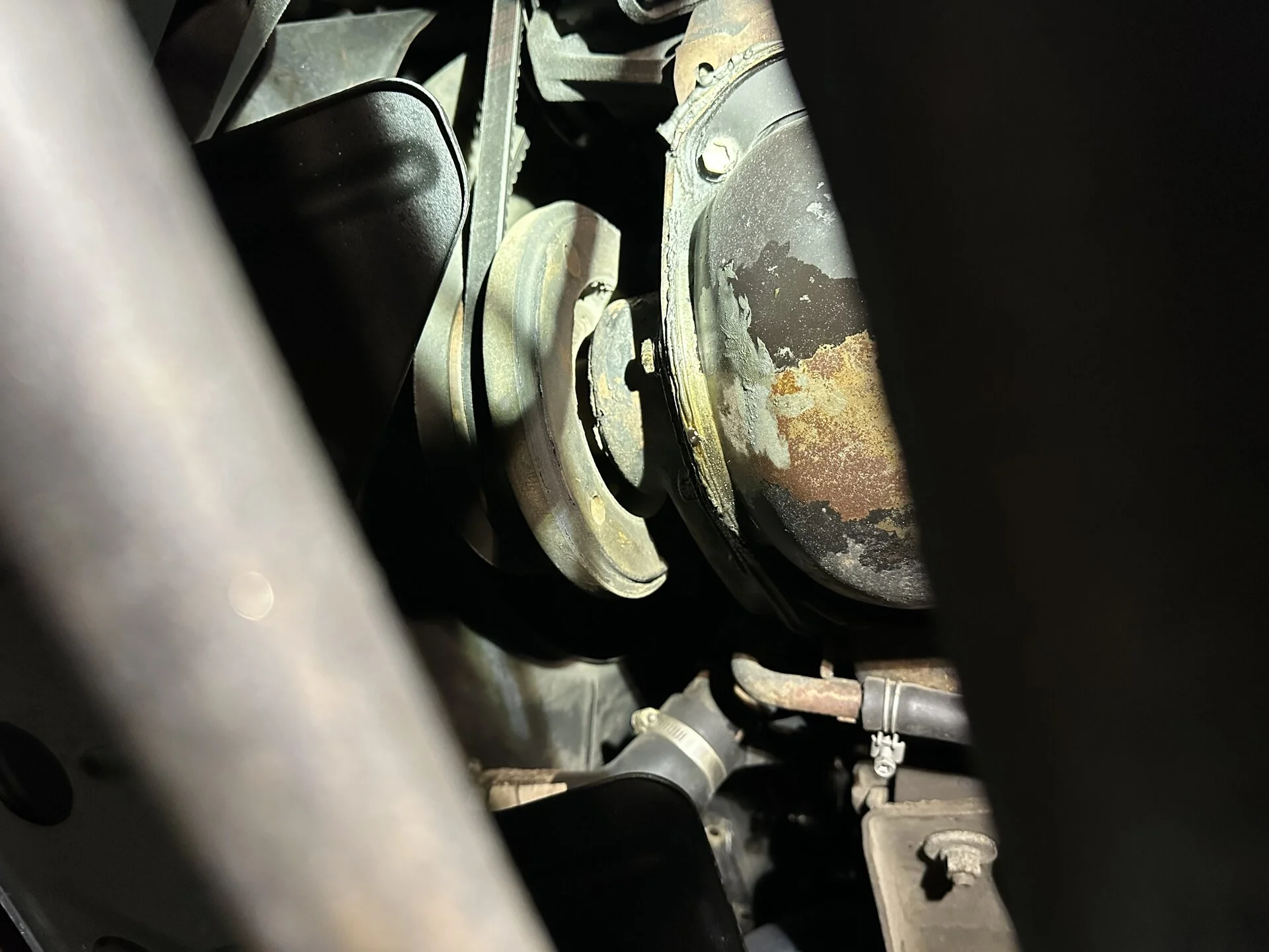

I have a small leak coming what I believe to be the front of the oil pan. Will I need to replace the whole pan or just get a new gasket? Thanks in advance for your help.
Try tightening up the bolts all around the pan, go easy, not gorilla-style.
If it still leaks, order up a new gasket and plan to remove/replace the gasket when you are due for an oil change.
Also could be front main seal on crankshaft, or leaking from timing plate cover.
Try to isolate EXACTLY where it is leaking from. I doubt you would need to replace the oil pan.
