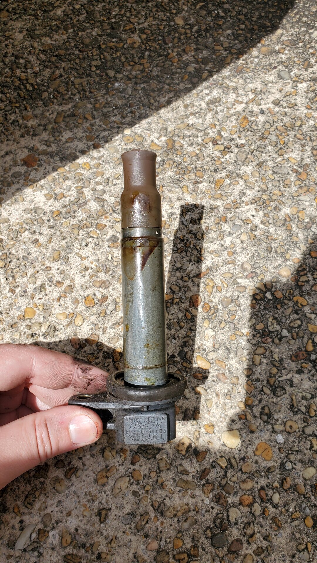

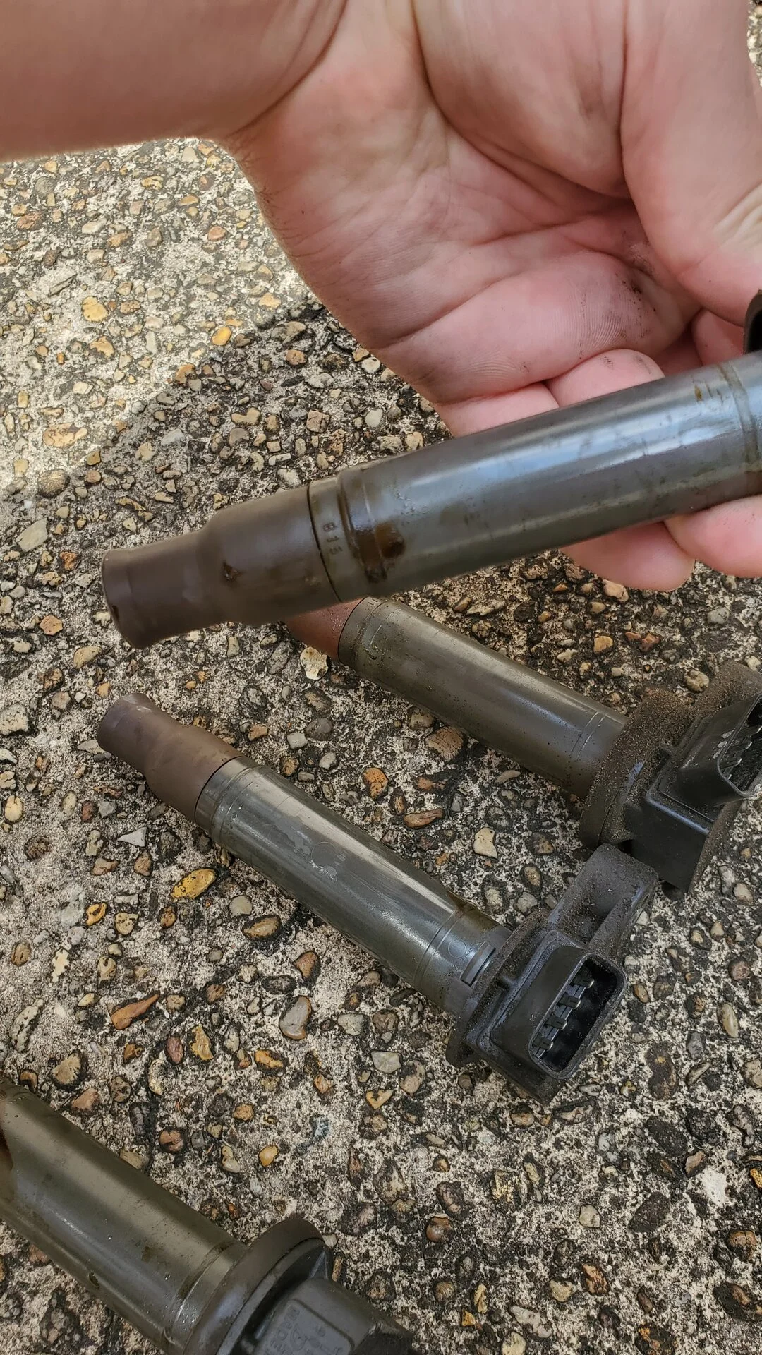

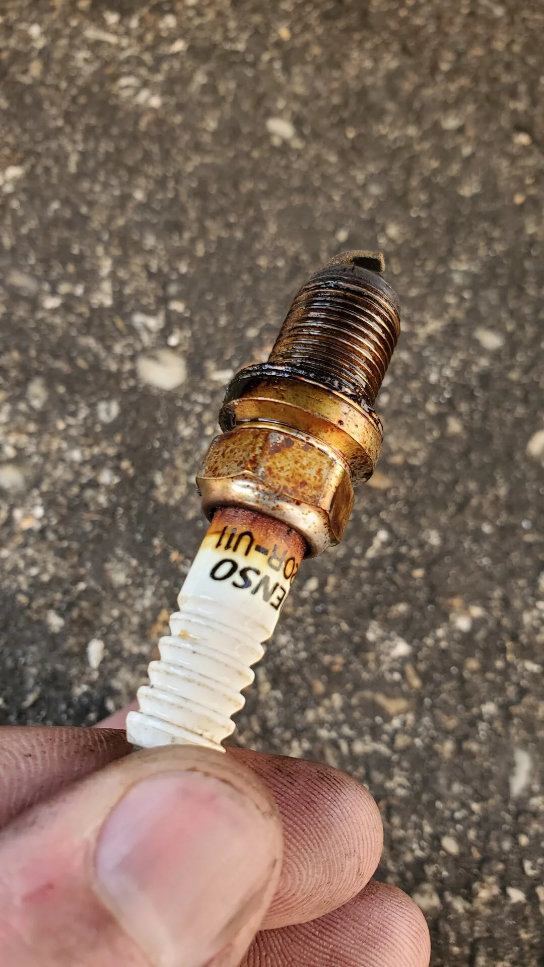

I was getting a misfire on cylinder 4, so I ordered coils and plugs figuring that was the issue.
When I tore it apart, this is what I found. What could be causing my plugs and coils to look like this? From a quick Google search, I found o-ring failure? Looking for guidance, as I don't want to put news plugs and coils in if this is the culprit for the failure.
Also, the coil boot was brown and looked to have overheated. Which if I recall, is a sign of oil getting to the coil/boot? Trying to get this up and running, as it's my only vehicle. Thanks for any help! 🤙

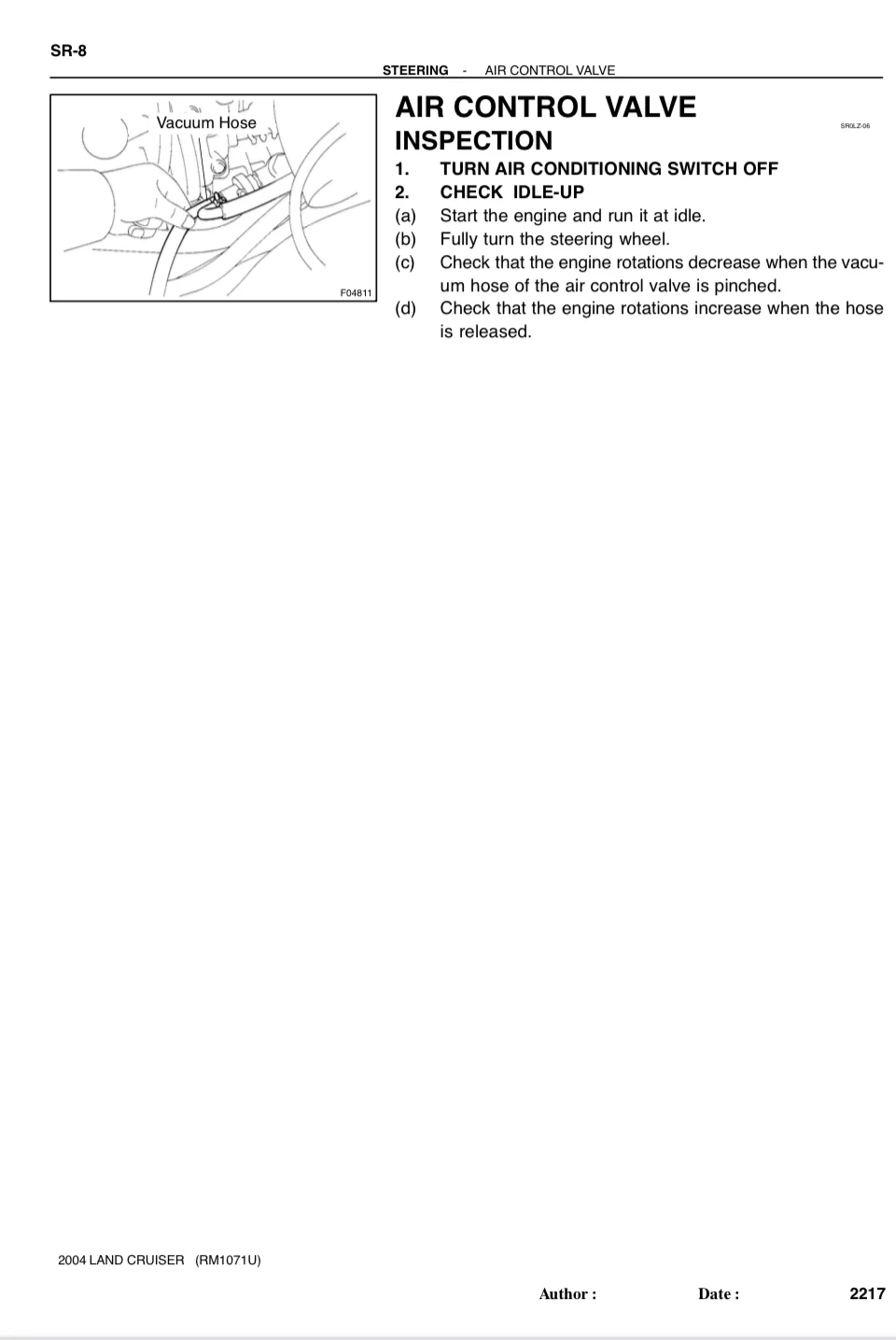

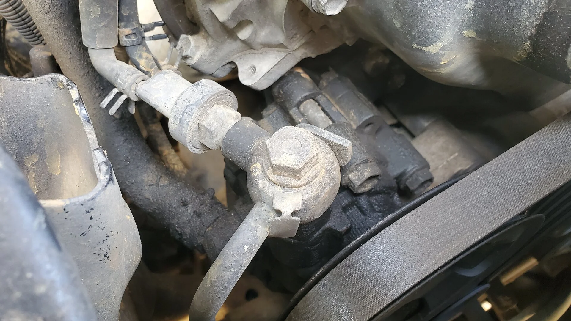

If it does end up appearing to be coming from the combustion chamber, try pulling the hoses off the idle-up control valve that is mounted on the power steering pump. It is possible for that to fail and to cause power steering fluid to back up into the engine. But if that is occurring you would notice the power steering reservoir being low.
Would a malfunctioning idle-up control valve cause a small leak in the power steering pump? The pump shows signs of a leak/weep. And how would I diagnose a bad idle-up control valve? Drive around without the hoses attached?

The backside of the pump has the hoses that were mentioned. They are connected to a brittle piece of plastic so be careful , mine broke very easily. Its an easy fix either way.

That is 100% oil getting into the tube from the tube seal in the top of the valve cover. They are most likely hard and brittle as charcoal. It probably doesn’t actually hurt anything, but it is messy.
The brown boots are probably original. I think they started life that color.

But just got in from finishing up. I ended up replacing two coils (boots were brittle and cracked) and 4 plugs. All the plugs were pretty rough. The other two coils were decent enough to get a seal on the plug and will run those until I can get valve cover gaskets and plug tube seals.

FSM describes a procedure to test function of idle up valve—
Thanks for the FSM post. I'll give this a try when I open it back up this weekend. I'll let you know the results.

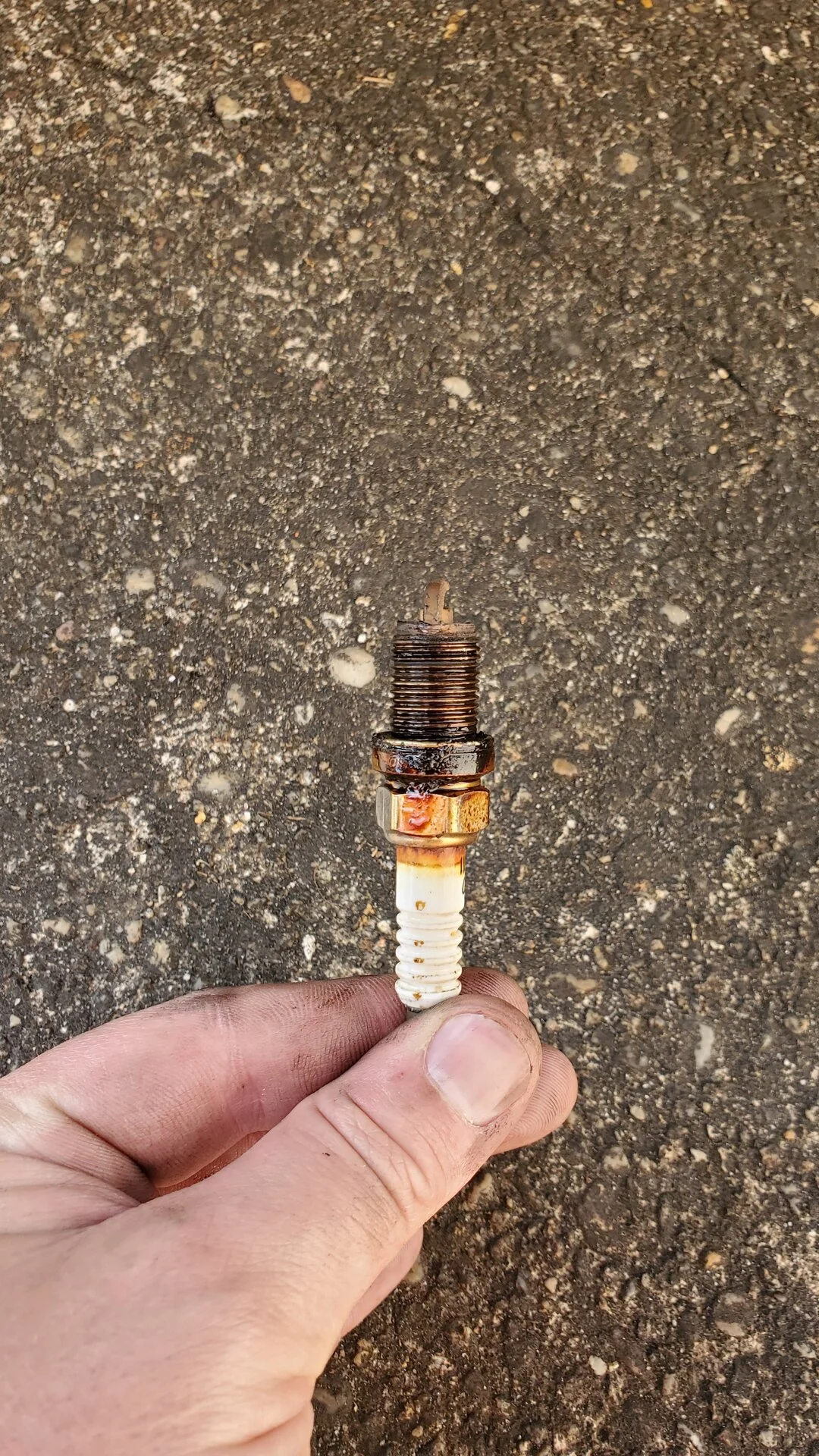

To me that is a classic symptom of the spark plugs backing out and leaking combustion gases, oil leak is secondary.

Yup, either this or leak from above. Clean it up, monitor and check it after a few drives. Buying a box of coils online is not that expensive, imo.
If it continues, check into the valve cover gasket and spark plug tube seals within the valve cover, and use stock Toyota gaskets for these replacements. You will also need the valve cover bolts, etc for the proper torquing.
