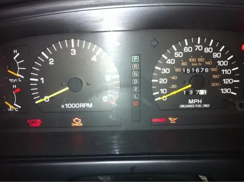

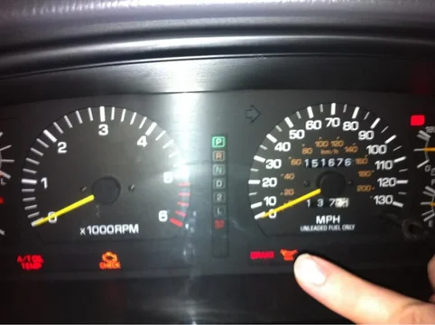

Dumb question. Where is the oil light? I've never seen mine. Maybe im not looking good. Does it come on with ignition on?
Here's a pic of my instrument panel while the ignition key is in the "accessories" position. The low oil level indicator light is to the far right, next to the parking brake indicator light.
x2, the light just reminds you to check the dipstick. The dipstick is more accurate.
I've known a few dipsticks that haven't been very accurate. :lol:
Thanks. Gonna check now ;)
