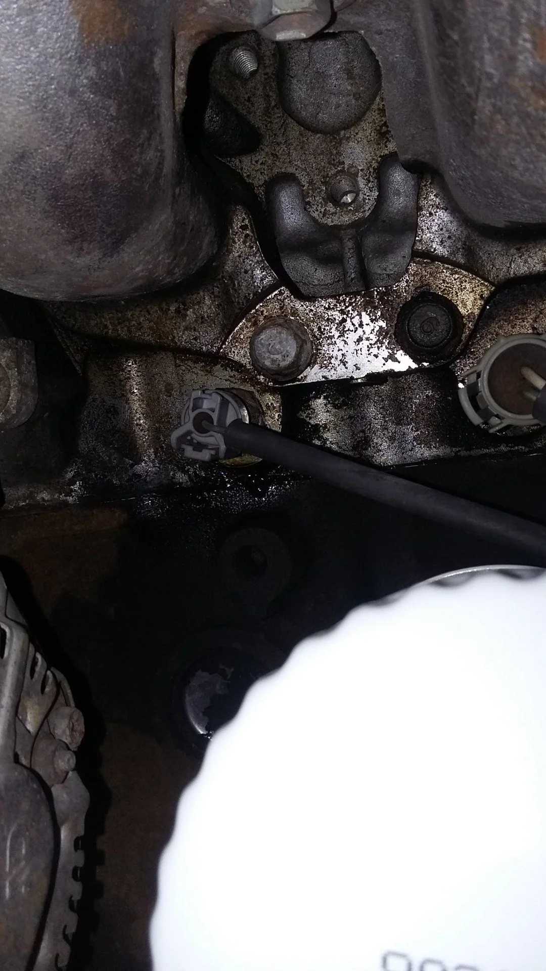

It's hard to get my phone at a low enough angle, but the seepage is coming from right under the coolant temp. sensor. I've been looking at head gasket pictures and wondering which holes oil goes through, maybe one is close to this location? Anyone know?

What does it look like above the intake runner? Is it possible that the VCG is weeping and that it's hard to see the oil until it puddles on the top of the block?
I'd clean that area with a degreaser all the way up to the VCG really well and then keep an eye on it. If the oil returns and the surroundings are spotless you will be better able to pinpoint it's source. There are enough trailings on the head in that picture to lead me to believe that the oil is coming down from above but it's hard to be certain from one pic.

Agree, running to there, gravity makes it run down, the fan blows it towards the back. My bet, valve cover gasket, possible cameo appearance from the distributor o-ring.
I had the same problem on my 97 right after I bought it. It ended up being the rubber o ring on the oil filter squirting oil up near the sensor. When I changed the oil I realized that the rubber was hard. and the oil filter was not quite hand tight. It took me days of head scratching to figure out.

I was going to say that this just looks like where the puddle stopped since there are oil signs all around that sensor.
