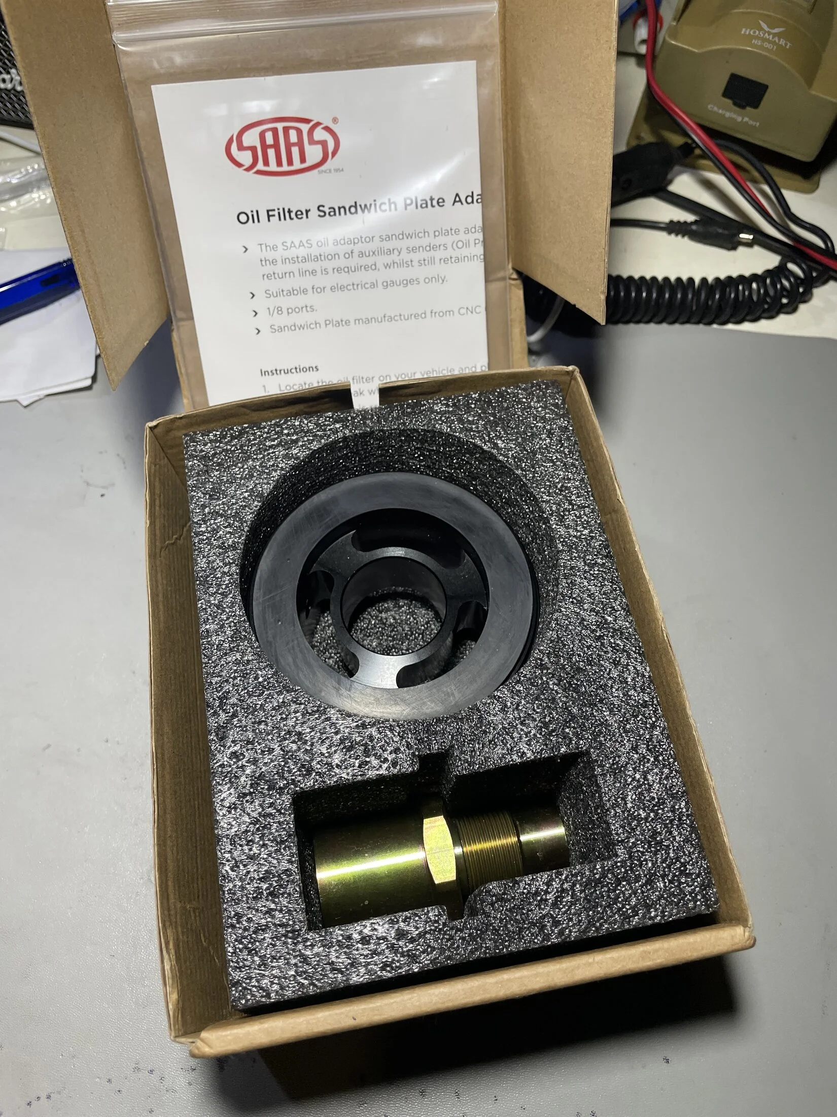

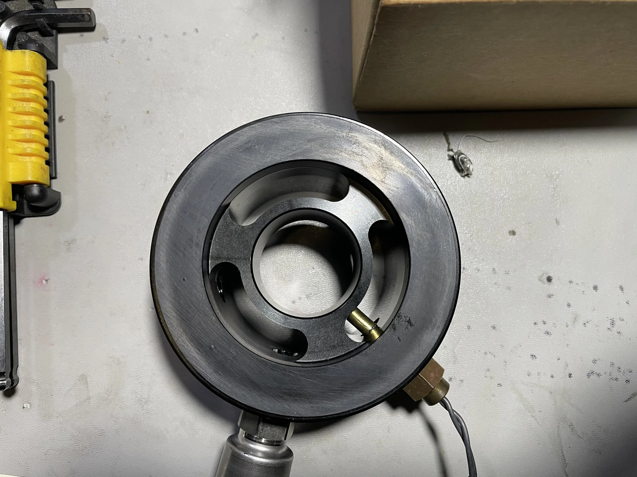

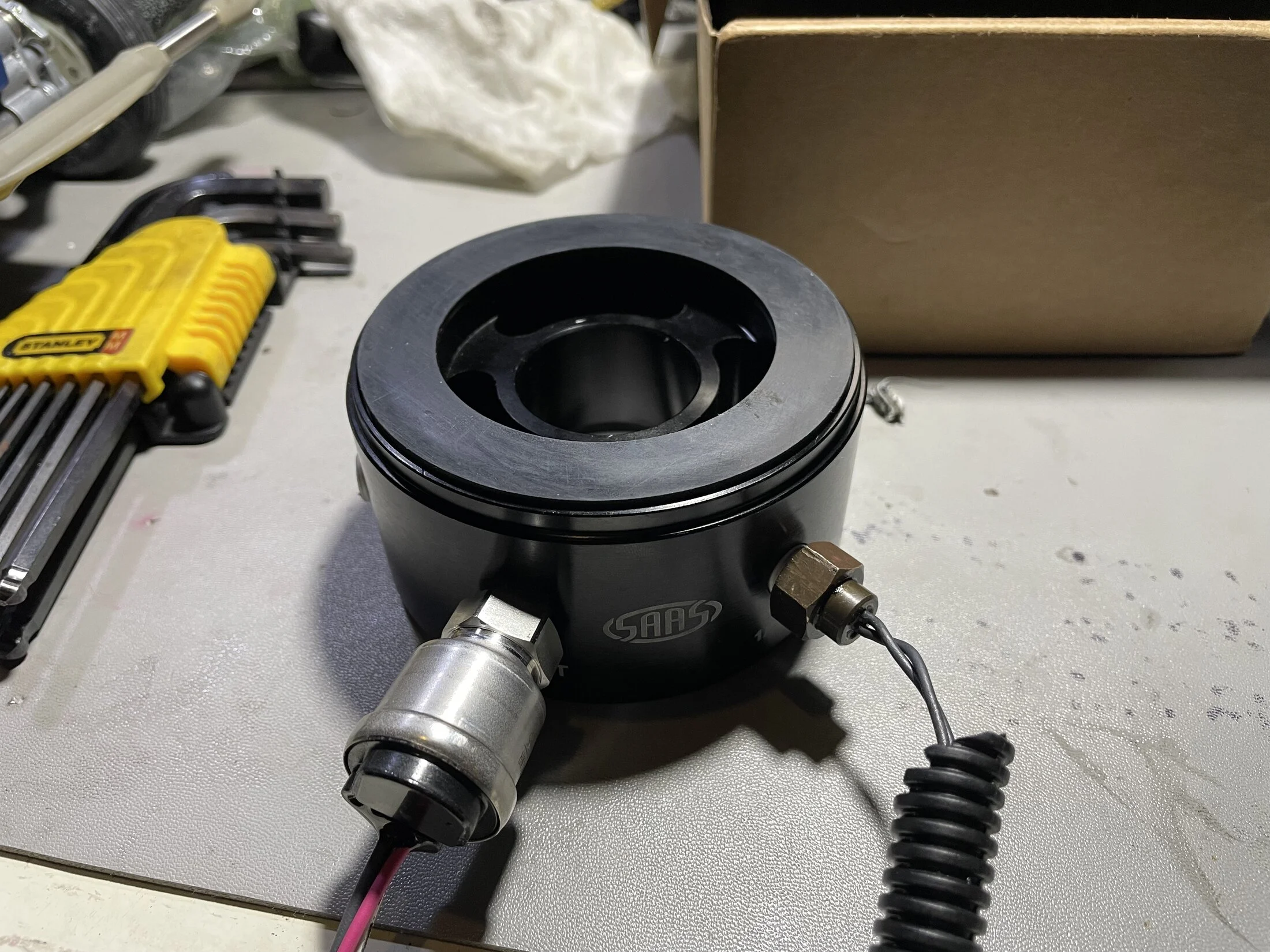

I got the SAAS SGAP6-2415 from ebay. I haven’t installed it yet. I have Defi oil pressure and oil temperature sensors installed so I can monitor them on my Defi FD display. I previously had the tee on the oil pressure port but the oil temp reading was too low. I also couldn’t swap the temp sensor for the bigger pressure sensor because of clearance issues with the starter.
