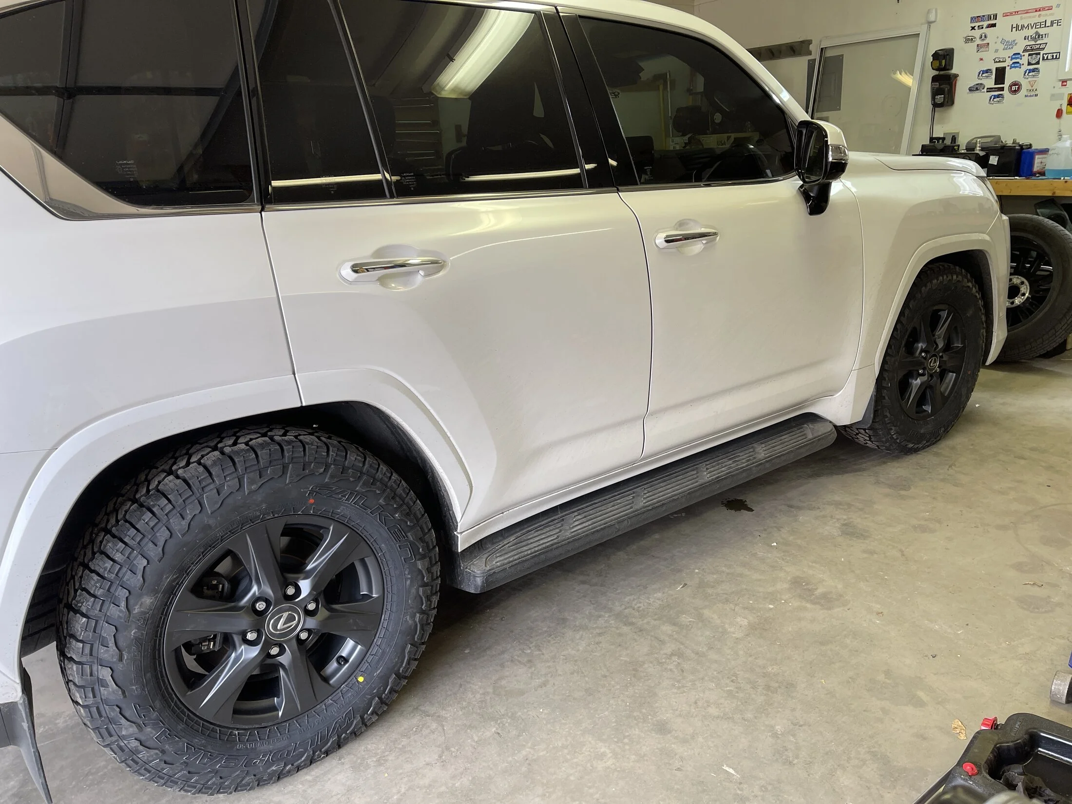

I think I'm going with the OZ Racing Rally Desert 18" matte black rims and the Falken Wildpeak AT4W.
Yeah those are cool. I would run the +25 offset and 285/65/18 Falken AT3 like the trd pro sequoia uses if you aren’t off road a lot, or the Yokohama X-AT if you are.
Post pics when you get them. Curious to see how they look.
Stock is +55 offset and the OZ are +45 offset which to me seems just right. I am getting these for snow and rain and very limited off roading, so from my research the Falken Wildpeak AT4W are the best possible option for snow and rain, and they ride almost as quiet as the massive F-Sport rims.
This is the size of tire: 265/70R18 Falken Wildpeak AT4W

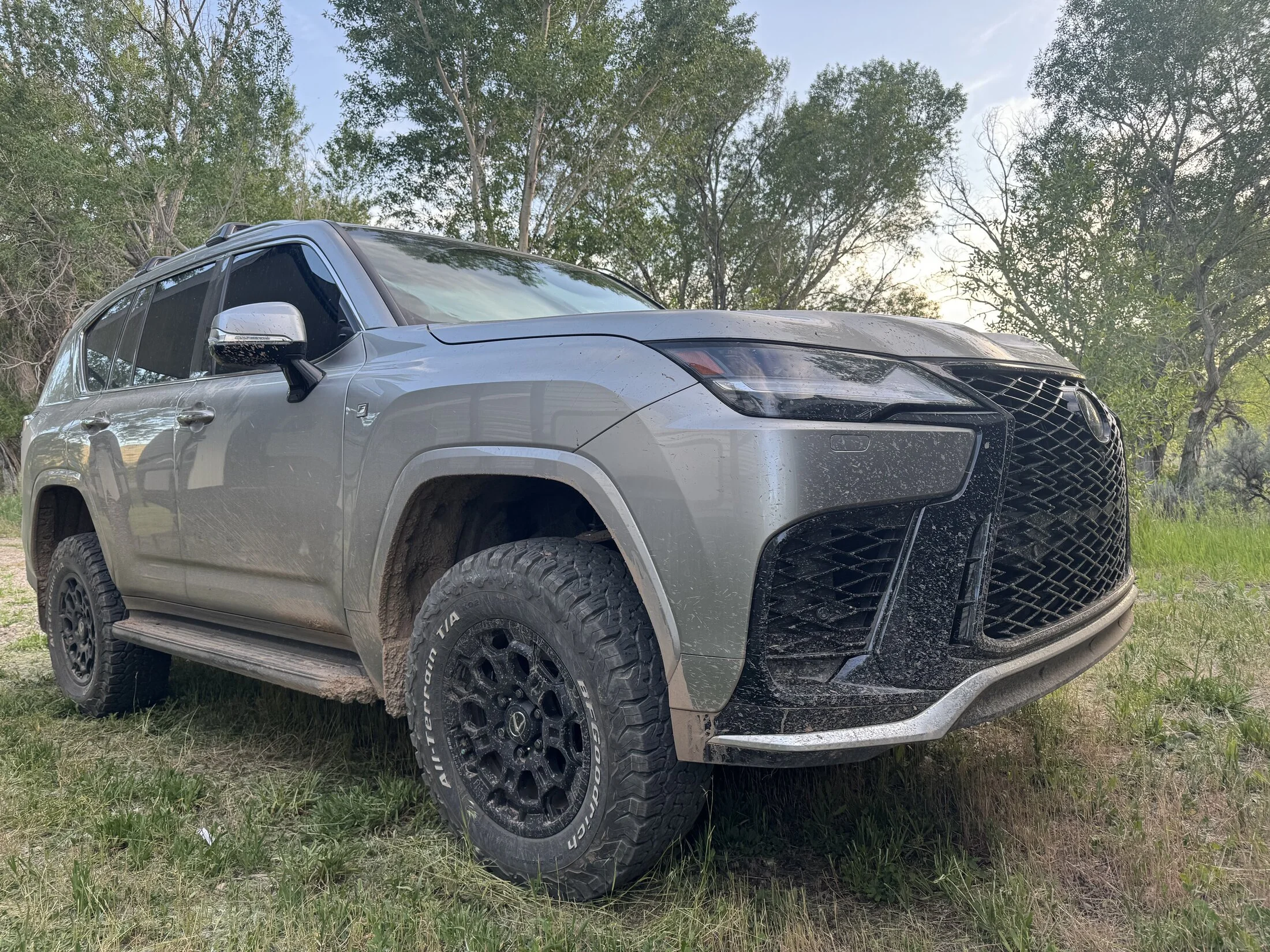

Any reason you're going with that size tire? The 285/65R18 is the same diameter but almost an inch wider. I'm running those on a 47 offset rim and they fit fine. In fact, I am planning on going up to a 285/70R18 as I want to go bigger.

I would run what this guy has in an SL tire that meets your requirements. To me that looks like the 25 offset and 265 wide tire. Judging off mine.
Disclaimers: that 285/65/18 Falken at3 was designed for Toyota with weight reduction in mind. So its abnormally light and really doesn’t look that aggressive. When I bought mine I spoke with Sumitumo America in Ca. about it, but I went a totally different direction on this particular 600 (will do something different on my 700 too).
I also have little experience with snow but those 265 tires I mentioned have the snowflake and mountain rating.
Personally would do the 265 on 25 offset or 285 on the 45 offset.

I already placed my order and am not getting the Yoko or anything else.
I think my choice is the best of all possible worlds for my application, and although the LX600 comes standard with XL tires the SL is the better move.
Cool post pics. Thats the factory TRD Pro size that comes on this chassis so good move.
