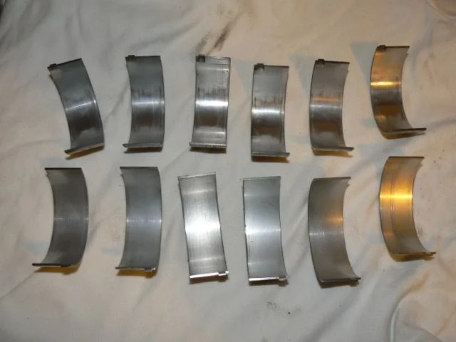

ACL BEB photo after 70,000 kms
Jan 8, 2009
61
439
North Saanich, BC, Canada
I replaced my 1HD-T BEBs about 70,000 kms ago with ACL bearings. My engine is out on a stand while I swap it to a different truck, so I thought it would be a convenient time to replace the bearings again instead of waiting to 100,000 kms.
Here is a photo of the bearing wear, just in case anyone is interested.
wear on them seem excessive for only 70000k
I have rebuilt motors with 700000km plus and they looked better than the top row of bearings.
what grade oil do you use?
I think they are perfectly fine. We took a set of those bearings out after 100 (yes, a hundred, not a hundred thousand) miles and they looked almost exactly the same. My guess would be that this is the initial wear in that happens right away and then they stay like this for a long time.
cheers,
jan
Looks like 1HD bearings to me that are 3/4 the way through there service life of 100k kms. Still cant believe how hard that engine is on bottom end bearings.
I've been waiting for someone to take a set of the ACL bearings out after some miles. There was a BEB thread a while back (don't feel like finding it) where it was asked if they need to be swapped again with the ACLs or if that was the permanent fix. There was no definitive conclusion. I'm looking at that and still don't really know the answer...
My stock bearings were trashed at 110,000km. I'm at 240,000km now, and wondering if I need to address this or not.
This does raise a lot of the same questions that have been asked and answered..
Guess first question is oil service, type of oil and driving conditions..?
In Oz there is a few trucks with 1hz that have turned a million kilometers but I have yet to see a 1hdt or FT do this.? I am sure someone who surfs the net a bit more could answer that question.
To me those do not look that bad at all, typical wear. I would guess you could torque them into the con rods and have them measured.

I changed oil every 5,000 kms and filter every 10,000 kms religiously for the entire life of those bearings. Always used Shell Rotella 15-40.
Do you have a good caliper to measure the bearings on the center and sides?

i would say that wear is normal for bearings, there is no delamination but a bit of scoring showing. start changing the filter every 5000 as well, put the top bearings on the bottom and bottom on the top and reinstall.
the load is pushing down and the one side looks like new.
flip and check again in another 100K and lets see how they look.
but then for $60 ... why not go new?
From what ive read the cavitation only happens at the highest load point which would be the bottom of the bearing exactly where the most damage is seen in the pics. I would also say go for new as rotating the old bearings will have the net affect of increasing the overall bearing tollerance and might actually exaggerate the cavitation causing the new bearing wear to accellerate. It might be worth looking into the actual bearing tollerance and seeing what high performance engines run as far as synthetic oils to see what they run and match it. I wouldnt go with alot of guess work unless you plan on opening it up frequently to check on it.

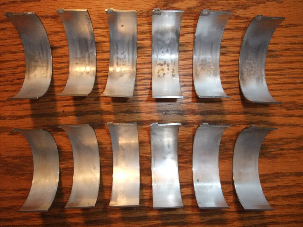

This is always an interesting topic especially for those of us interested in seeing what kind of high mileage we can get on these 1hdt engines. One of the guys I wheel with has 350,000+kms with only the regular engine PM stuff. BUT ... that engine is an FT which doesn't really count.. Everyone else is around the 200k mark and no one has had any issues with BEB's. I'm the only "paranoid" one who has changed them. ;)
These are mine after 210,000kms. Very respectable I thought and didn't really help my case in preaching the "change the BEB's or else" to the group.
Everyone runs 15W40 Waco’s dino oil....no synthetics!! My truck always has as well but it hasn't spent too much time up north in the real cold I don't think.
