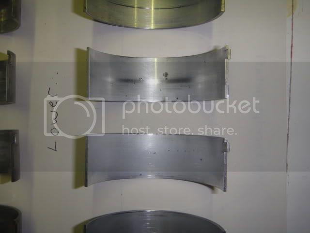

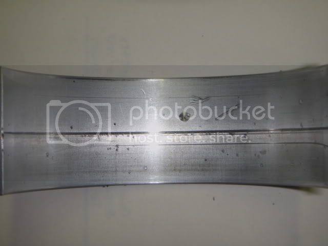

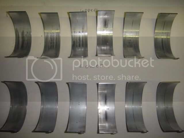

Well I did the beb's this week and the results are a bit dusturbing. I have read a lot of posts and havn't really seen any this bad, let me now what you think (front on the left)
didn't look like any chunks were missing- I still have mine- all were good except 1 which was worse than yours.
Glad you changed 'em?

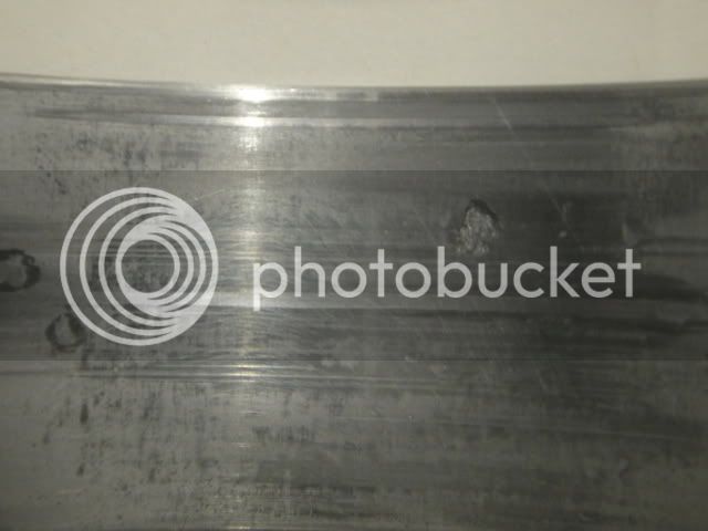

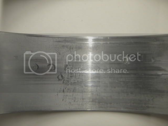

pics don't dp the depth of the holes justice. I was surprised the one in the last pisture wasn't at the way through, it was deep!

the delamination has started, i have seen worse on vehicles with much lower mileage ...
it is a crap shoot, some don't show any wear at all and then there are those that tore out the bottom end.
i would say good thing you did them.

After reading and seeing Daves 2000 (thanks Sir) pix (swarf) Long shot in my eyes , but were all due to our opinions,i can't say that swarf is the killer of those brgs. I have seen swarf damage , from steel and cast , Very radial .
If the brgs that get replaced from the original straight aluminum style as they look here to a 7 style layer aftermarket style and last , then im leaning towards dry start galling of the aluminum pits.
