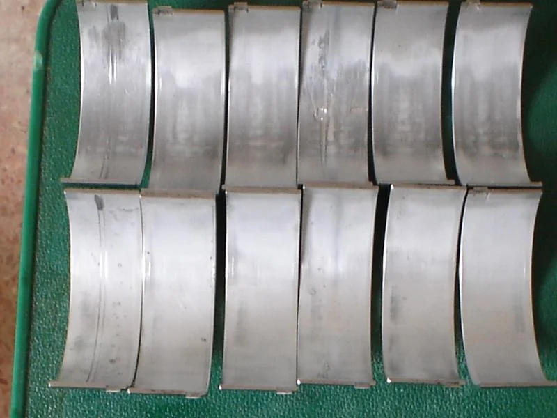

I have only to offer my pics as perhaps evidence of this, my car has a FSH and it appears the engine has not been opened up at any time in it's pampered 16 year life, again looking at the pictures number 4 again rears it's ugly head with the other bearings in very good condition. Number 1 shows some very minor marking and the others show acceptable (if any) wear at 184,000 miles.

Picture 1 is of the bearings removed from my car yesterday, 1 - 6 left to right, upper row are the rod shell bearings and the lower row their opposite, apart from some colour changing I was hard pressed to tell new from old in particular the non thrusted side or cap bearings, if the bearings were constructed of a problamatic material why is there no evidence of the others breaking up?
Just for the record I would add that changing the bearings has made no visible difference to my oil pressure readings and there was no visible damage to the crankshaft..
