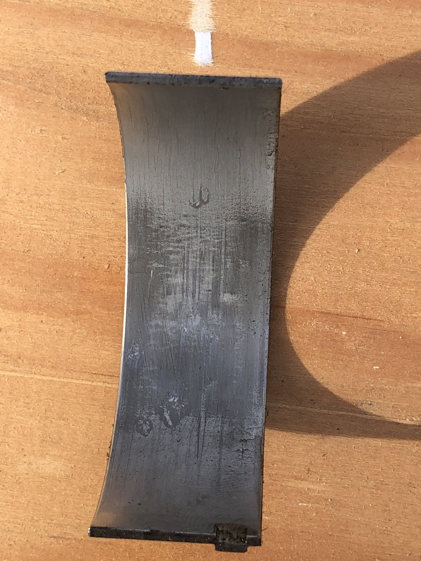

Replaced the BEB in my truck awhile ago. The FIPG material lead me to believe they’d been untouched since new. Roughly 170,000 miles on the truck. What do you guys think?
I’ll try to post some additional photos of #2 and 6. There’s some scoring and one spot of de lamination on those, but otherwise I think they look pretty good for the mileage.

Mine had less wear and no scoring from memory. More importantly, how does the crank feel?
The 1hdt bearings are famous for deteriorating and the crank being fine.
with the shape of those bearings, I would plasti gauge just to be safe.
Yeah, those aren't great, it was definitely time to get in there and change them. I'd also plastigauge every single one as you reassemble
They seem to be just showing wear rather than serious delamination. Is there a brand stamped somewhere on the bearings?
Thanks for posting the info and photos. As you mentioned, looks like one is starting to delam and perhaps the beginning signs on one other. Having them done means you know what you have now.
