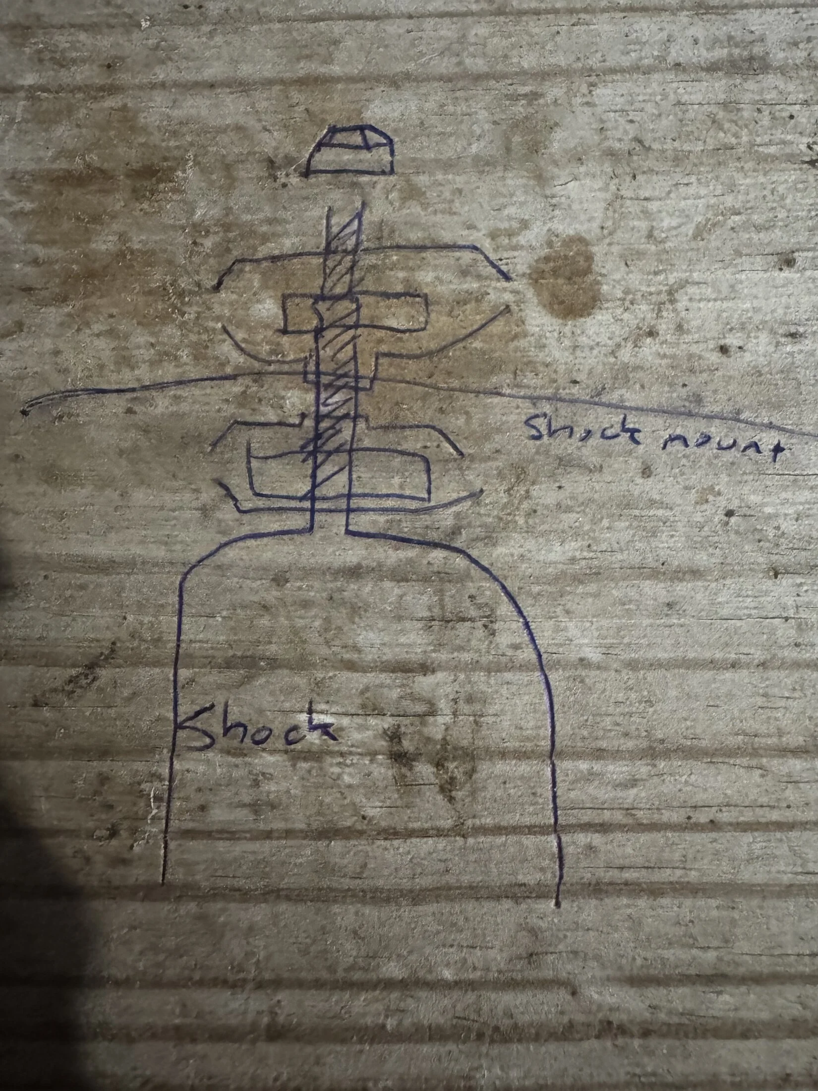

How did you orient the washers? Two centering washers up front, or just a single lower one?
Excuse the drawing, my 5 year old could probably do a better job. Shock-> non centering washer-> bushing-> centering washer-> shock Mount-> centering washer-> bushing -> non centering washer-> top nut.
From watching a couple of videos, I was expecting to need to compress them but didn’t end up needing to. Maybe there’s a slight difference in bushing thickness throughout the manufacturing process, not sure.
