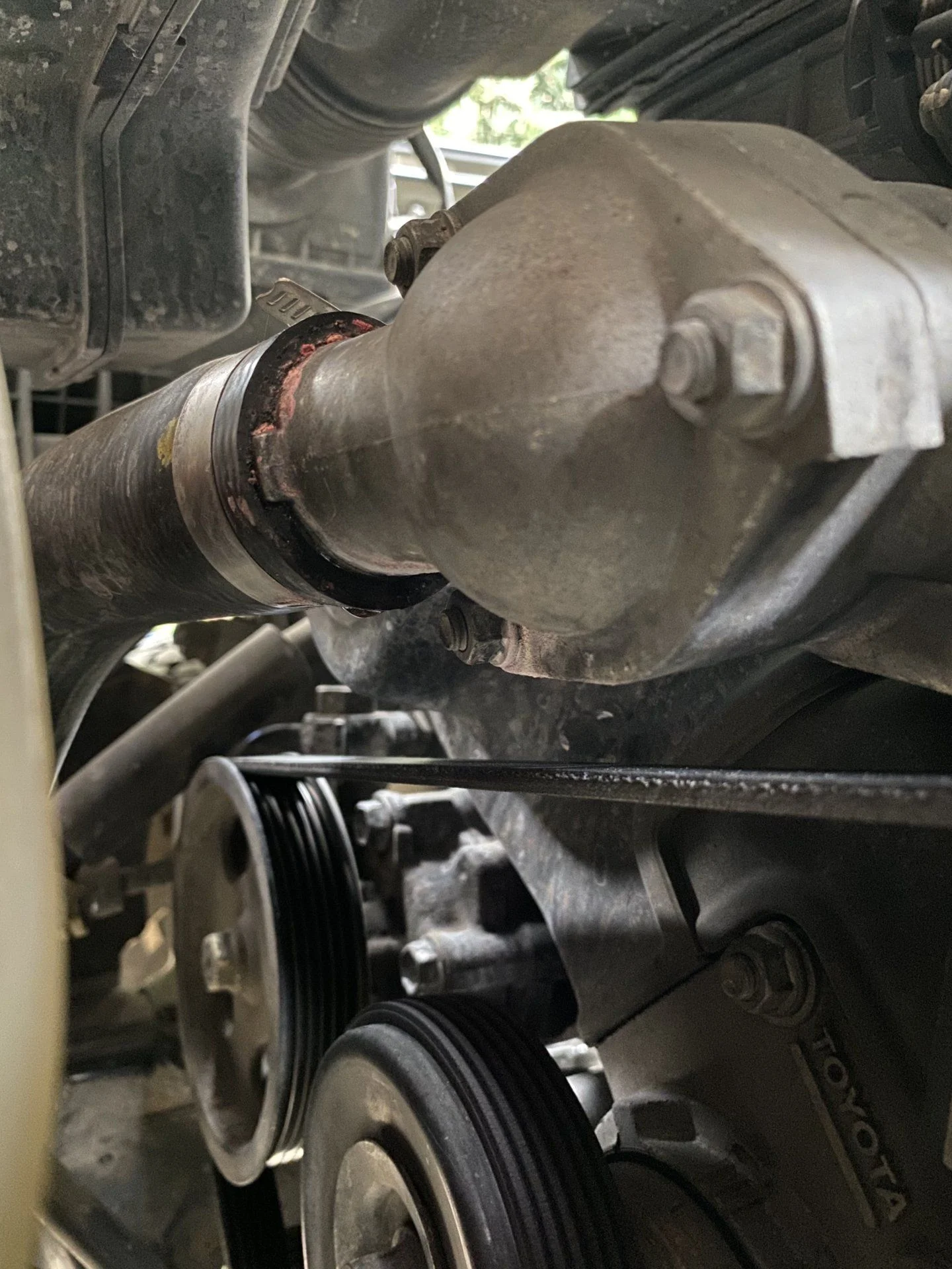

I'm planning to replace radiator hoses #1 and #2 (and generator drive belt, and tensioner pulley bearing, and potentially thermostat and gasket) because of a coolant leak.
I ordered OEM clamps as well. Looks like the PO replaced the OEM radiator clamps with stainless steel 028 032/57mm screw clamps (like these). OEM clamps are spring clamps.
Any thoughts on reusing existing screw clamps instead of switching to the OEM spring clamps? I'm pretty new at this, but the spring clamps "feel" like they might not work as well. Then again, the screw clamp is the one that is failing.
