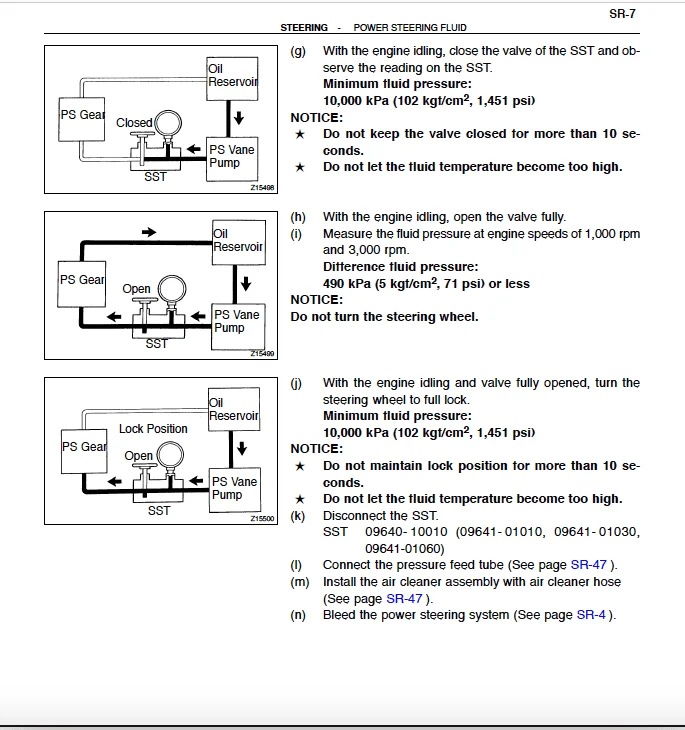

Per @abuck99 2004 FSM
The above would seem to indicate a proper system is running at just under the recommended 1500psi of pressure. What I find surprising is that going from 1000-3000rpm should only increase pressure by a maximum of 71psi. On my 80 series bumping from idle to 1400rpm creates a drastic difference in line speed on the winch. Of course that is a vane type pump.
