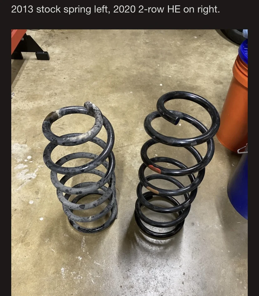

That is a great deal. And yes the front suspension is the same as a base model. The front wasn’t taller, but people did observe the rear tended to sit about 3/4” taller than a stock base model.
2020 HE rear springs appear to be a lower spring rate than US base model springs, probably because there is no third row. Definitely a smaller diameter wire, can’t remember whether the number of wraps was the same.. this is important to total spring rate. At the time I didn’t have access to 2020 part numbers to see whether there were ROW trucks with the same springs to compare common features. I also haven’t gotten into what 2021 3-row HE rigs came with.
Whether HE rear springs would work in your truck will depend on your setup. Most people building out HEs ditched the stock springs anyway.. so between that and the limited production numbers not much feedback on how they handle load compared to a base.. but even a base is marginal when loaded up.

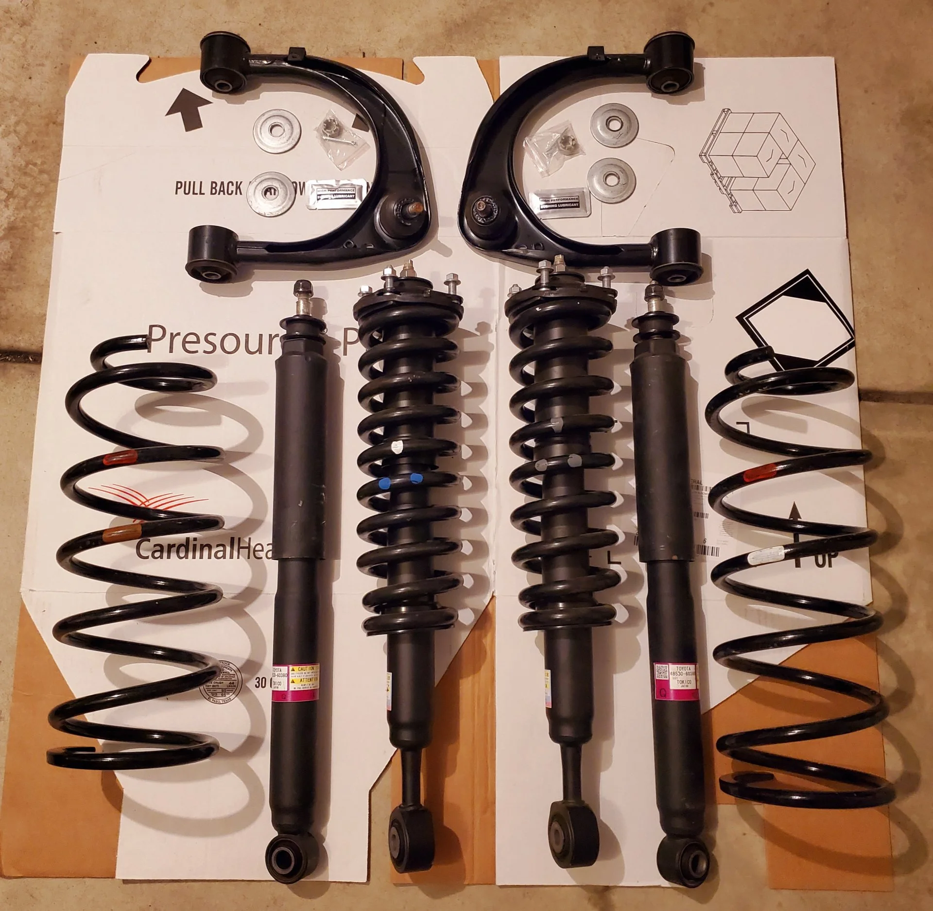

I used a 2021 LC Heritage suspension that was also swapped with only 500 miles on it. All the part numbers were the same as the ones found in my 2008 LC. One thing to notice is the color of the 2 painted lines (blue and purple) on the rear springs. I installed the front struts OEM spacers and the car is level now. ~20 inches from center hub to wheel well fender at front and 20.5 inches for the rear axle. I have removed the 3rd row seats. I have a winch mounted on a TT hidden winch mount. Also, I have ARB skid plates.
Note: I have seen pictures of the rear springs with different color of paints (orange). Maybe those springs are different. I added a screenshot from another post too

I did not have the part numbers for the 2008 springs and I do not know the spring numbers for the 2021 Heritage. Everything else ACA, front struts, shocks front and rear were the same numbers when compared to the 2021 heritage numbers.

FWIW, I have a 2013 with 85K miles on stock suspension. With 3rd row removed and OEM front strut spacer, I still have ~1” rake.

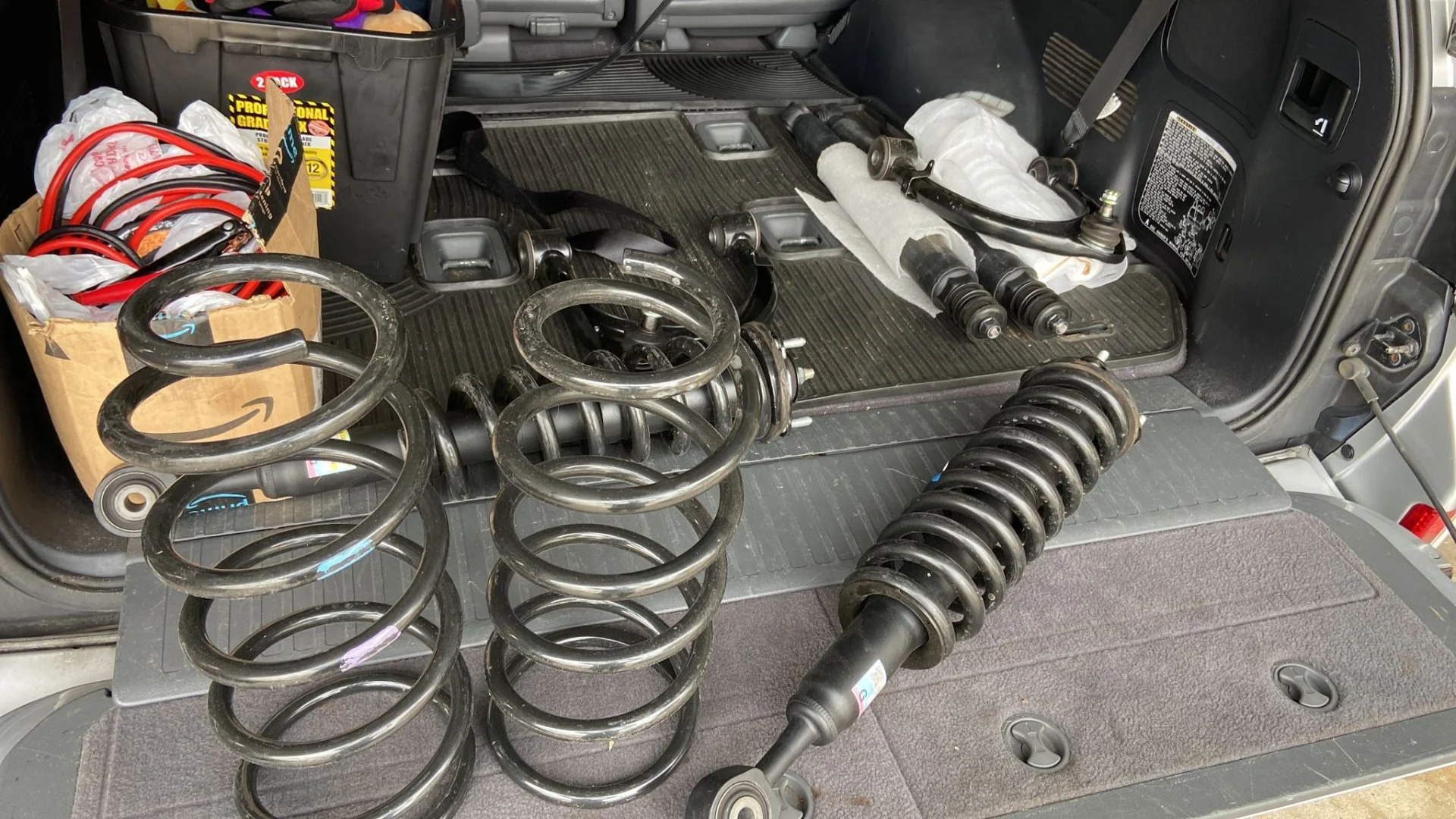

Just got back from picking all this up. $300 well spent! Heck, one UCA alone costs what I paid for everything in the picture. Now it's time for some fun🤘
Can anyone tell me which spring and shock go to what side by looking at the painted dots on the coils?
By chance does anyone know the part numbers for the rear shock bushing's and the cushion retainers I will need for the top rear shocks?
Longer rear spring goes on the gas tank (passenger) side in the US. Fronts don't have any difference side to side. You can reuse bump stops, etc. Hardware is cheap.
