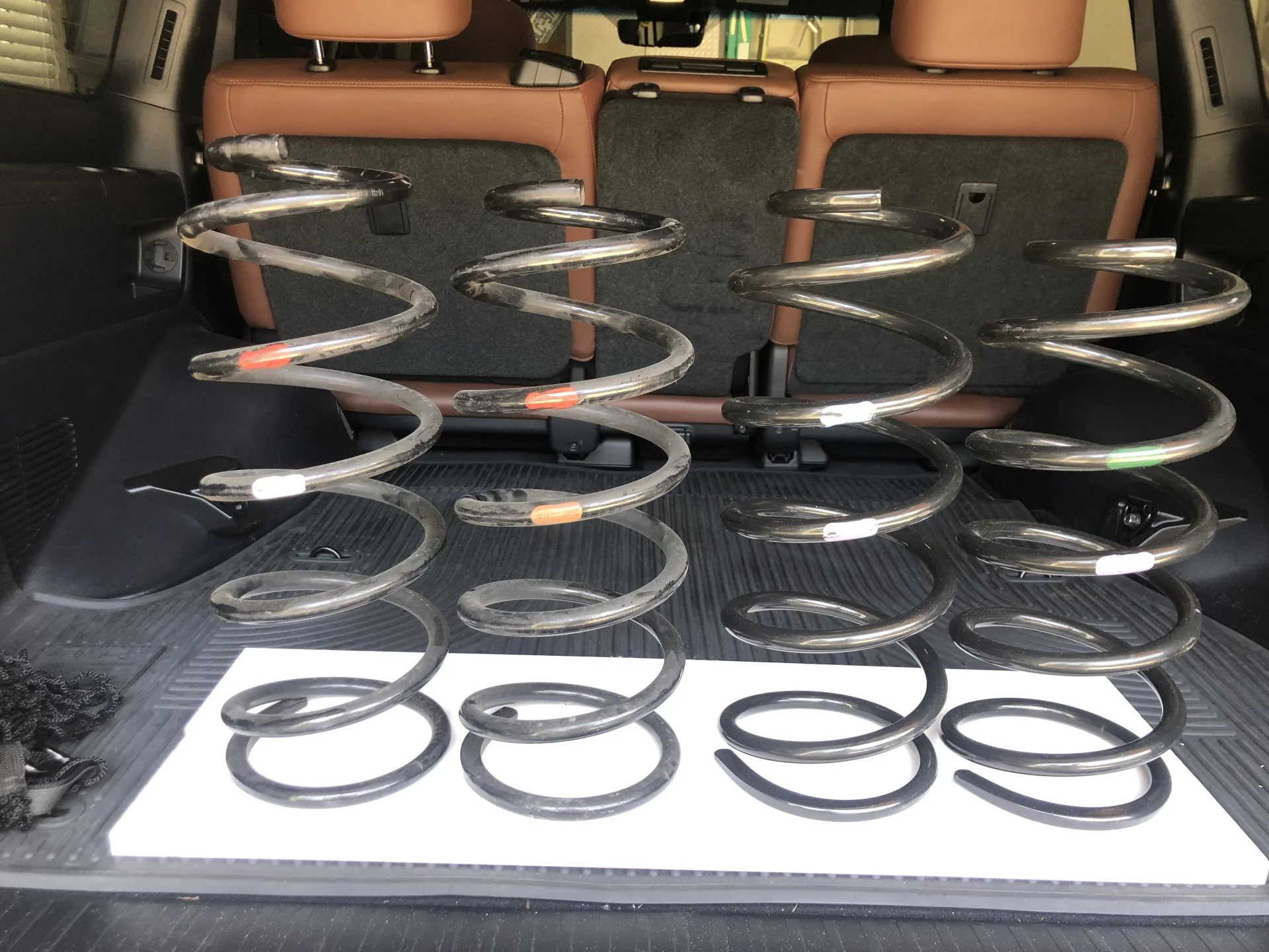

Front springs do have different part numbers, but I don't have a way to figure out which color dot goes where. Maybe a question for someone with a HE still on stock suspension. The shocks use the same part number so that won't help you figure out right/left.

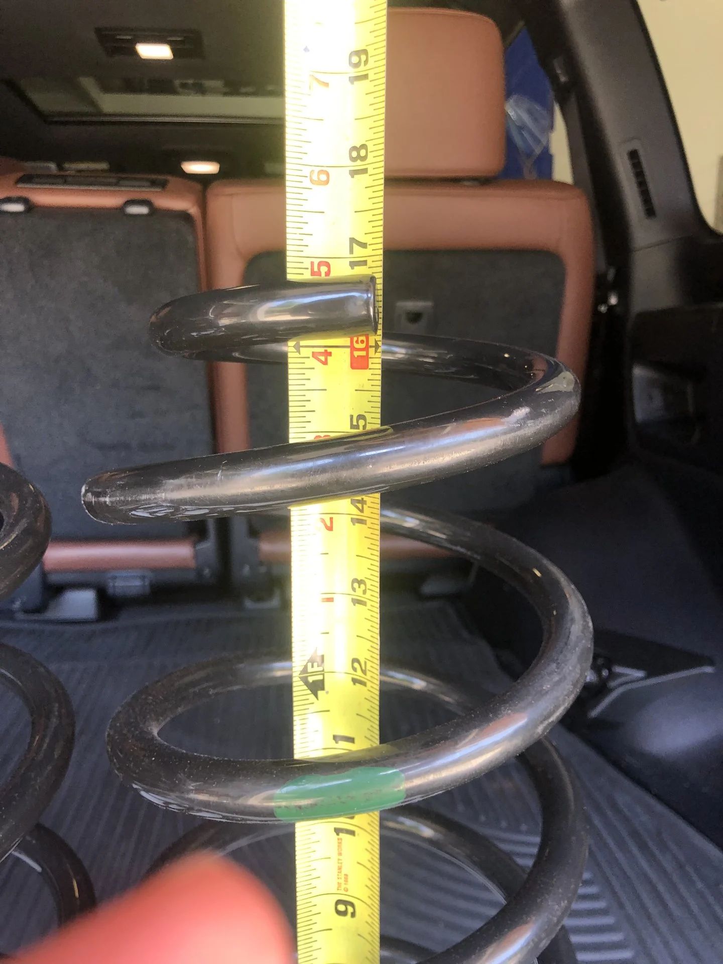

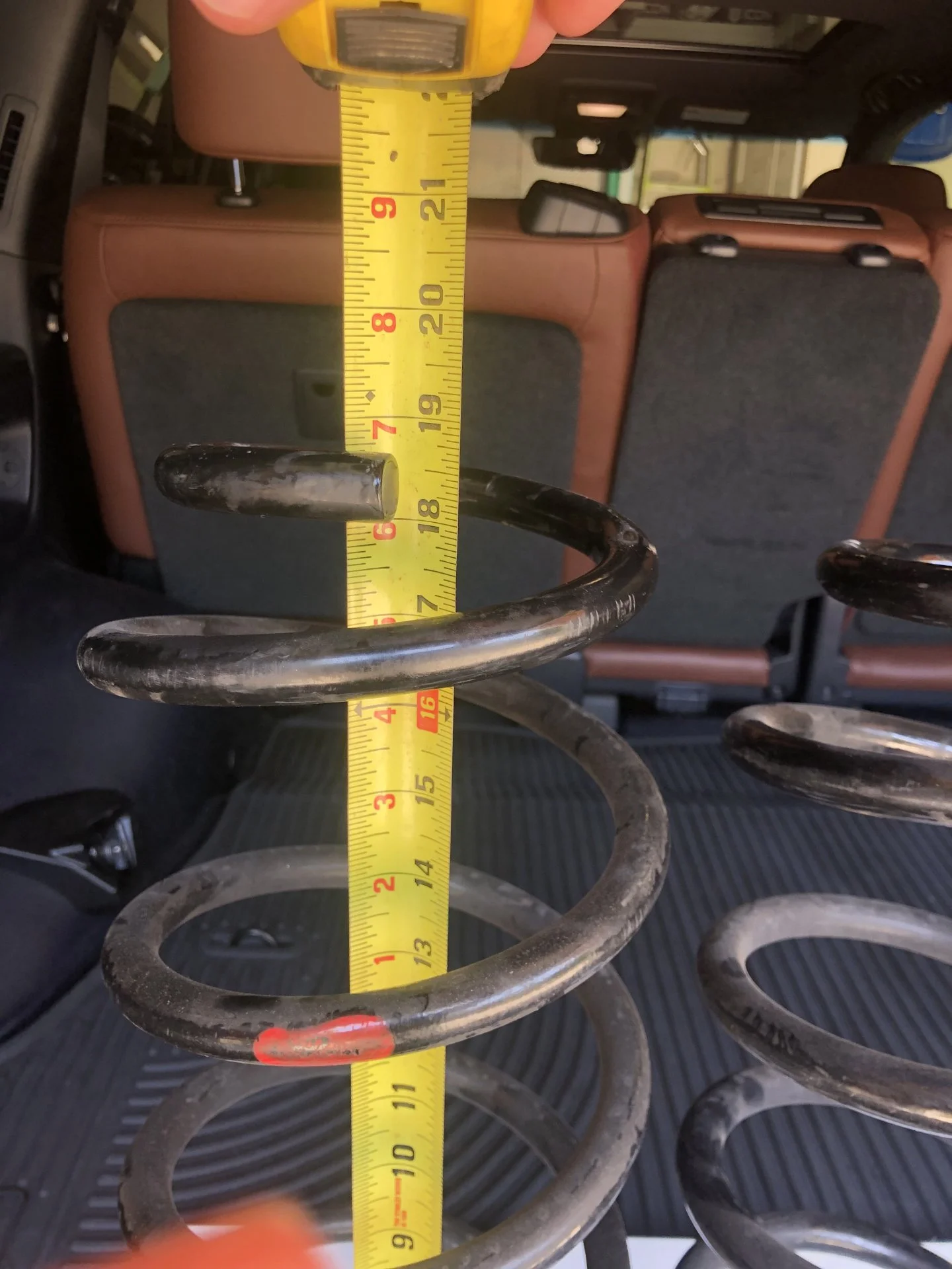

Thanks for those part numbers bloc. I actually ended up just getting the stock rear springs over the heritage springs. I wish the springs had tags on them with the part numbers like what OME does vs. the painted dots. Ill shoot the guy I bought them from a text and ask him if he knows what year L.C. these stock rears springs came off of. Front shock wise, I'll post the part number for the front shocks when I get home from work Sunday. This morning while on break, I decided to see how much it would cost to get all these parts off of Toyotapartsdeal.com...and this is what it would have cost🙄

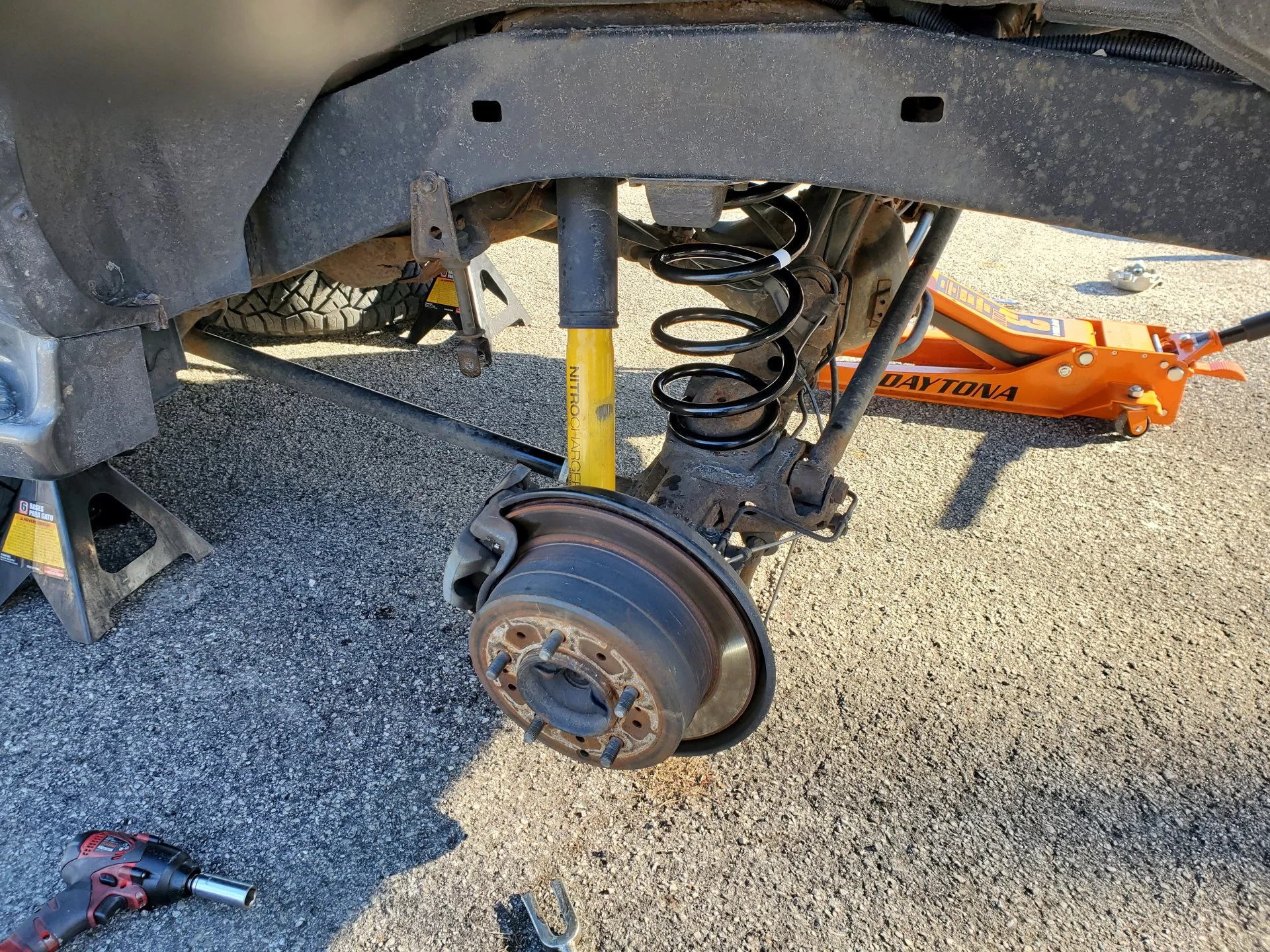

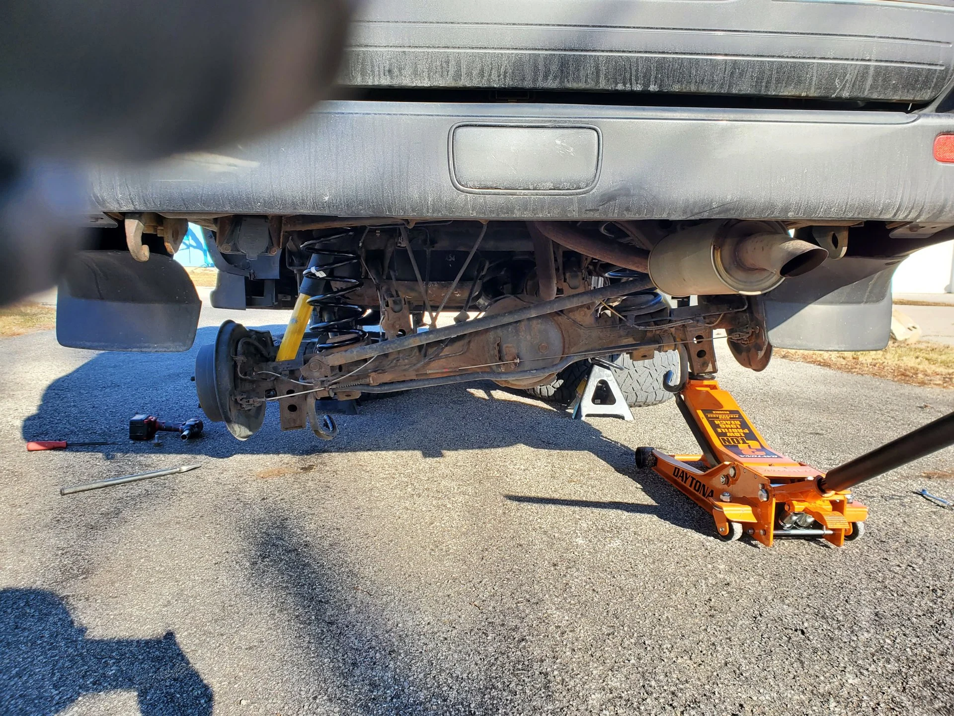

Question for you CharlieS. You mentioned awhile back in one of my previous posts. Using a small scissor jack between the rear diff and frame to remove the rear springs. Do you think with the KDSS valves open, and the shocks removed. I would be able to pull off using a floor jack and lifting one side of the diff like what you see in the pictures in order to get the springs removed? Or will it not work, since the sway bar will still be connected?
Sorry, not sure. I lift the vehicle from the frame. The us driver side spring almost falls out on its own. It is the passenger side that I use the scissor jack trick on. I can't visualize how the floor jack would work in that scenario.
Update: Not sure if the drivers side comes out so easy because my Kings have more droop?

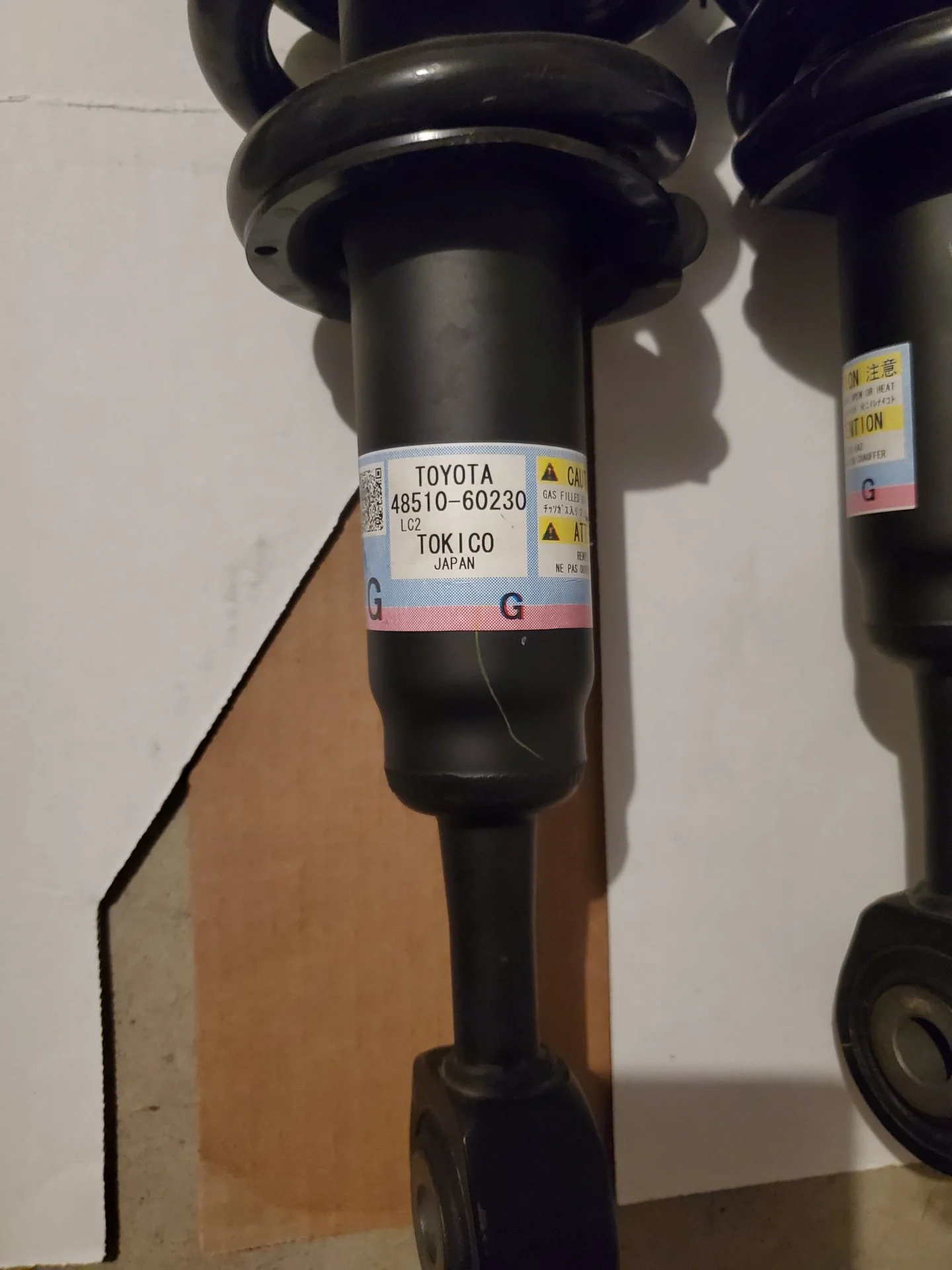

Here ya go bloc,

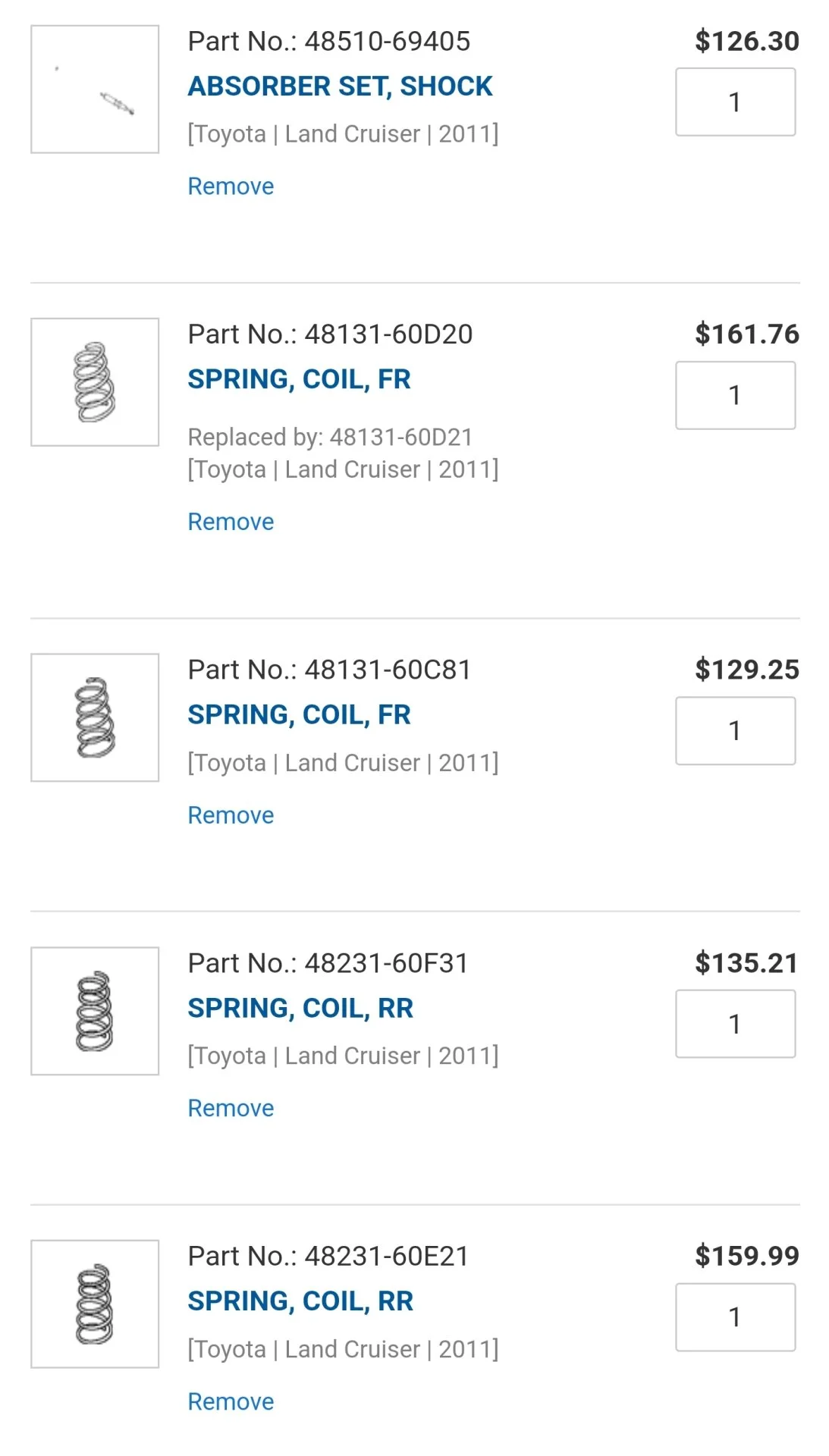

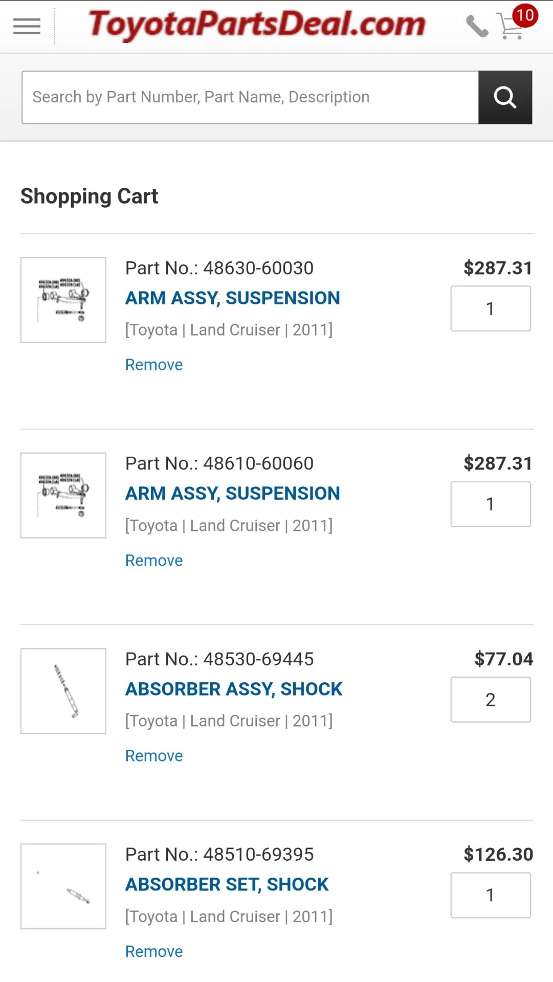

From the part number that is on the shock, they are off of a 2016-2018 Land Cruiser. Hopefully they will fit my 2011. When I typed the number in on Toyotapartsdeal.com, it said this part wasn't a match for the year of my vehicle.
It will fit.

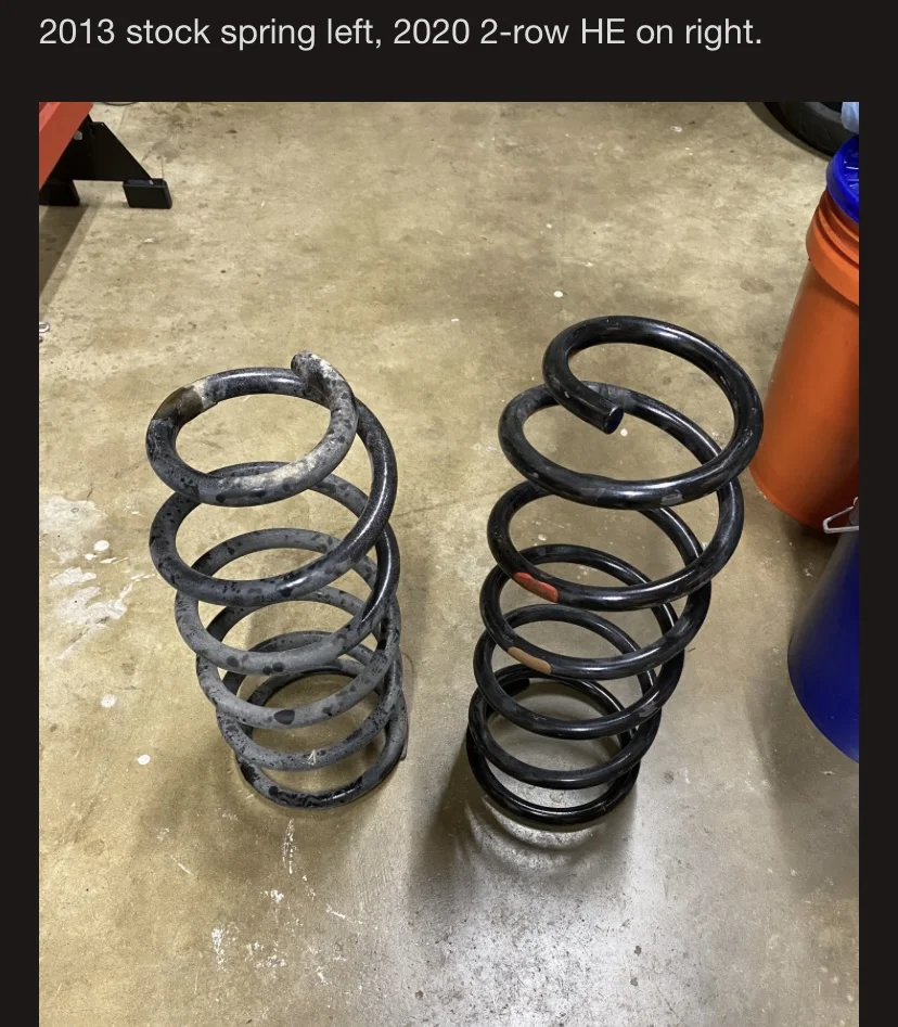

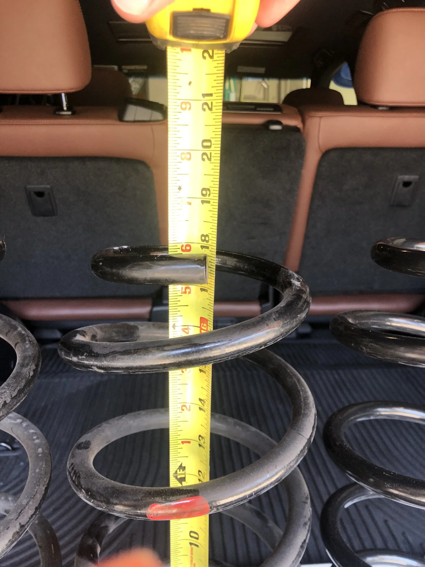

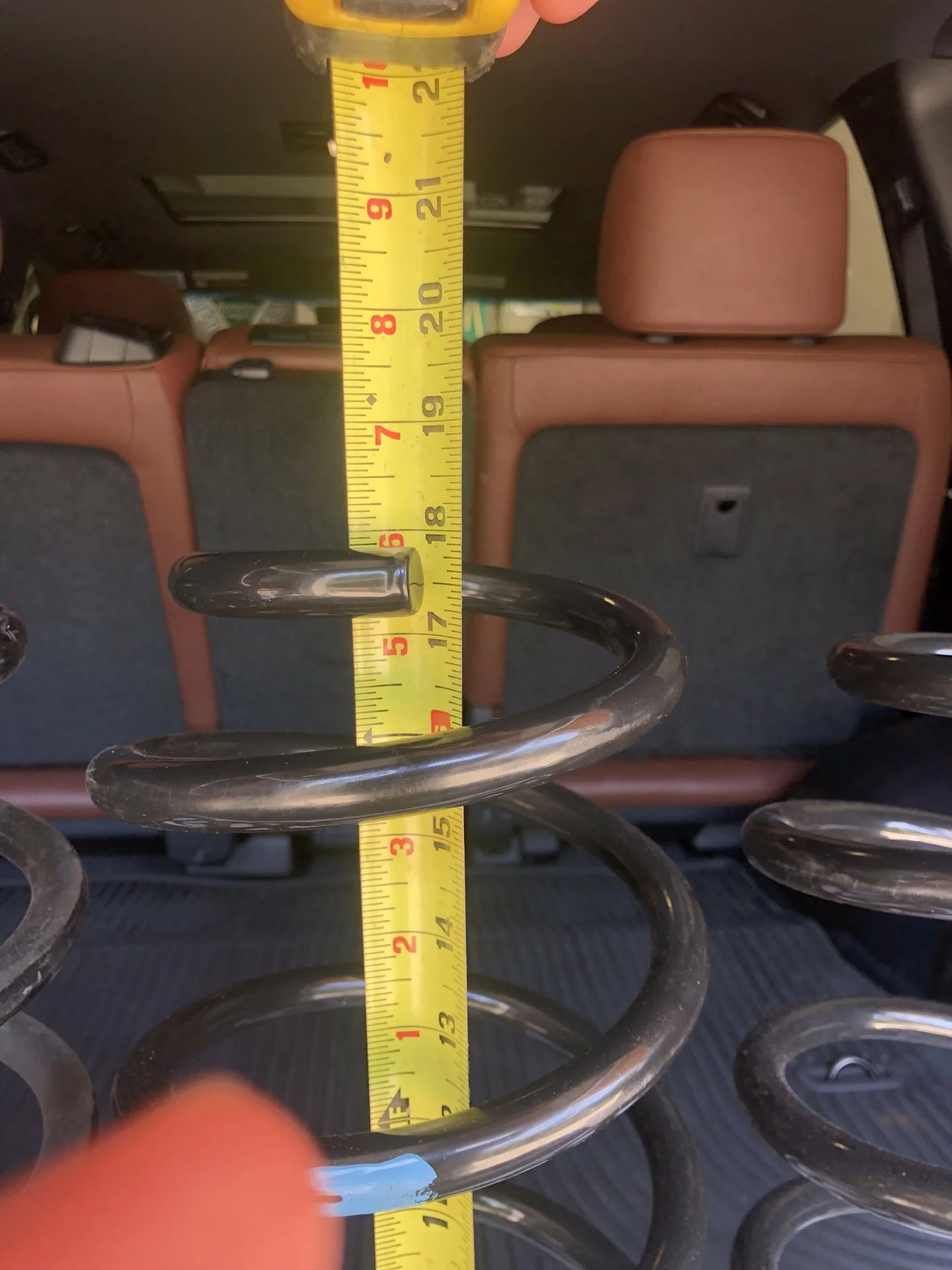

That would be my next question. Yes, I still have my third row. However I do not think the HE is higher on the back just due to the absence of the 3rd row. I am thinking this because of the picture below showing the HE spring taller than the base (I might be confused though). If I am mistaken, would removing my third row solve my problem and restore the rake?
I took that picture. The wire on the taller spring is thinner, which means the spring will be a lower rate. Basically, not as stiff. Without knowing the exact spring rate (we don’t), it is difficult to tell exactly what the installed length will be with a given weight on it..
Since the early HE doesn’t have a third row and isn’t expected to carry an extra few hundred pounds of people back there on top of the weight of the seats, it makes sense toyota would spec a lower rate (softer) spring.
To bolster the point about wire diameter and spring rate making appearances deceiving, you could have two springs with the same length, same wire diameter, but if one had more wraps than the other, it would be softer. A good analogy is the spring is just a long bar of steel.. the longer it is, the easier it is to bend. More wraps just means a longer continuous bar of spring steel.
I have a base 2019 and I’m looking to put HE rear springs as they are about 2” taller than my base with IMS Dobinson’s 1.4” coilovers on front to give me a slight all around lift while trying to maintain as much ride quality as possible. Based on what I’ve found out the HE edition comes with different springs based on 2 row or 3 row. I have both sets here for comparison see pics below. Set on left is from a 2020 2 row heritage measuring ~18-3/4” and 17-7/8” respectively. The set on right are from 3 row 2021 heritage which look to be are same as base model springs With same coloring measuring ~17-7/8” and ~16-3/4” respectively. As @bloc mentioned I also have no idea rate but they appear with naked eye to be similar in thickness.
I can’t speak for 3-row HE parts but I’ve personally measured 2020 2-row springs with a vernier caliper and they were 1.2mm thinner wire than a 2013 base spring.
