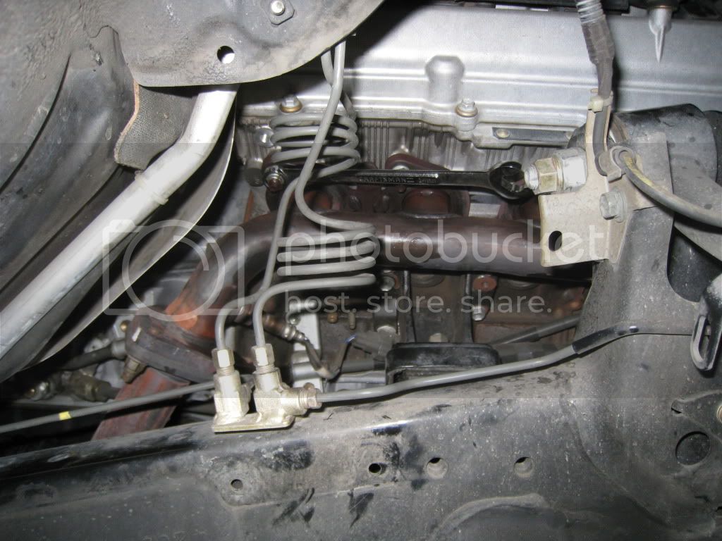

This is the PS O2 sensor - right above the frame rail, partially obscured by the brake tubing. It points forward (to the right).

So just a quick question... The O2 sensor in question here (bank 1, sensor 1) is located on the passenger side of the truck behind the plastic cover, and it's as shown here directly above the flange located on the exhaust manifold. This is bank 1, sensor 1 correct?

Hey, Oregon, those don't look like dt headers to me.
Ha! That was a pic when I was taking of the factory headers. Unlike Spresso, I didn't need air; my manly arms with a standard box/open were sufficient. ;)

To be honest, I don't know which one is bank one. Search for the link to download the FSM and you should be able to identify it, left or right.
Yes, it's directly upstream of the exhaust flange pointing forward. You can get to it without pulling the wheel, just make sure to put it on stands or the tire could pinch your head off if it came down.
