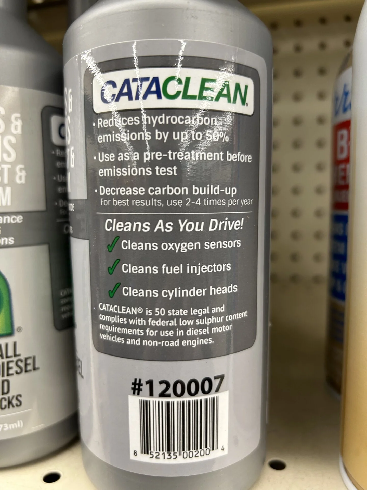

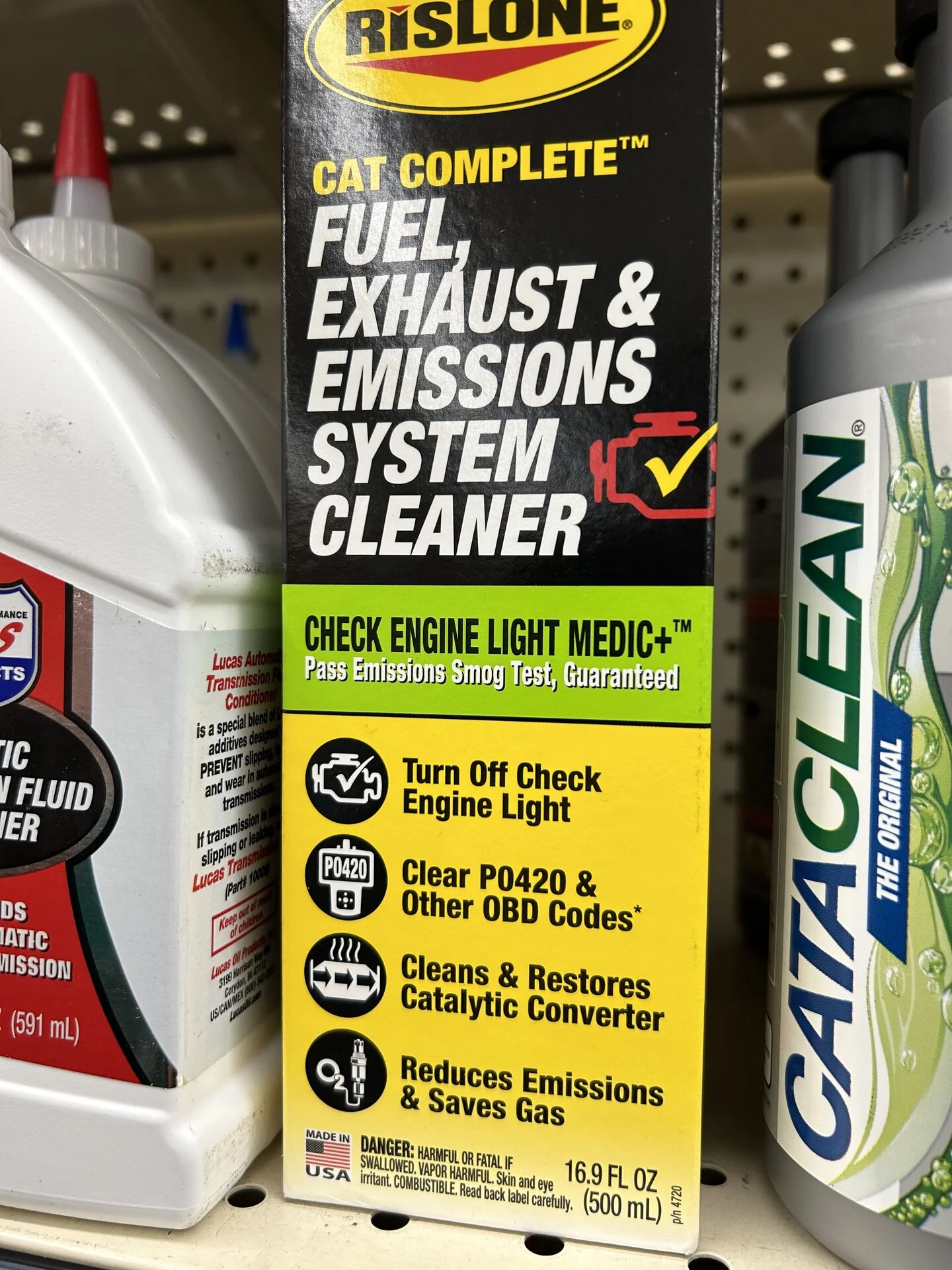

Just had another scan related to a check engine light and got this code P0171. O’Reilly said it was probably related to an O2 sensor. They suggested I buy 1 of the two products they sell before I replace the sensors (see attachment). Any thoughts on whether the products are of any value or whether the products could cause problems.

My question was about the cleaning additives.
Understand, reason I mentioned to check for any air/vacuum leaks because those are common and usually easy to fix. and the cleaning additives won't help if the cause is a vacuum/air leak. Might help if any fuel injectors are severely clogged. Either way, they shouldn't hurt so if you haven't used an injector cleaner in a long time, give it a try.
IME and FWIW, whatever the bottle says, like "add to (up to) 20 gallons" for example, I generally cut that number in half if I'm adding an injector/combustion chamber/valve cleaner. But if you're concerned call the manufacturer of whatever product you choose and ask what is the minimum amount of gasoline that needs to be in the tank when using their cleaner.
Generally those cleaners are all very similar, IME the difference being in the amount of PEA or similar chemicals in the product.
You may also want to clean the MAF sensor using an appropriate MAF cleaner.

I typically recommend NOT pouring stuff in the gas tank, down the intake or in the oil.
These things can wash loose stuff you don't want coming loose and it will mess with sensors, cats, plug injectors, and cause bearing damage (added to oil)
Fleet trucks don't add stuff in millions of miles.
Buy quality products on the front end and do regular PM.
You can do whatever you want, but it's not uncommon to need to replace O2 sensors.
The more you drive it, the better stuff works.
