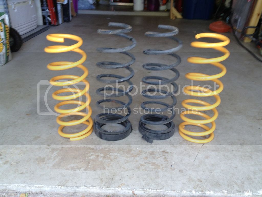

Out with the old and in with the new. I picked up a set of Ironman rear springs and swapped em out with the 12 year old stock ones today. I have a set of the 30mm Slee spacers that were on the old springs.
Side by side I didn't think they would lift my truck that much so I added the spacers to the Ironmans and finished the install. My guess is that the old springs compressed more than expected and the new ones don't.

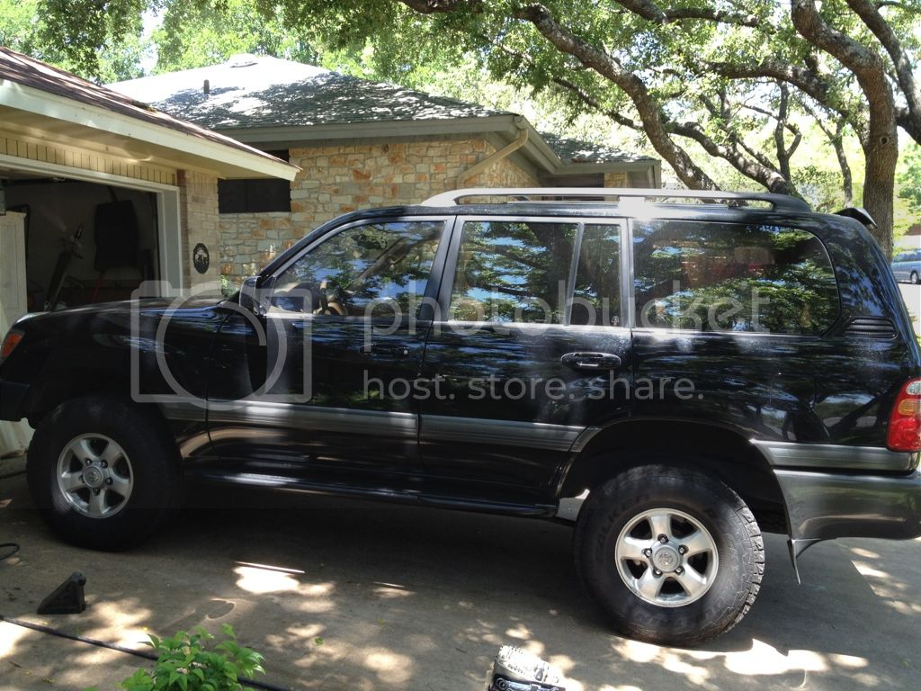

The result was a 2" increase and a stank bug stance that doesn't feel good while behind the wheel.
Measurements are 21.5" front, 24" rear...center of hub to bottom of fender.
Removing the spacer will still give me a gain of almost an inch over the previous setup and 22" center to bottom.
What are your measurements?
