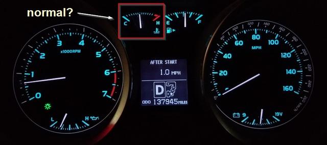

Evening all - had to replace my radiator due to the 'cracked radiator' common problem.
Since I never paid attention to it before the stupid thing cracked, I was wondering if this looks about right for the normal operating temperature.
Info: 75-80-degree outside temp, driving in normal conditions for about :30min when pic was taken. Used the factory 'Asian Formula' properly mixed pink coolent.
Thanks - Patrick
Same as mine at operating temperature, just below midway point.

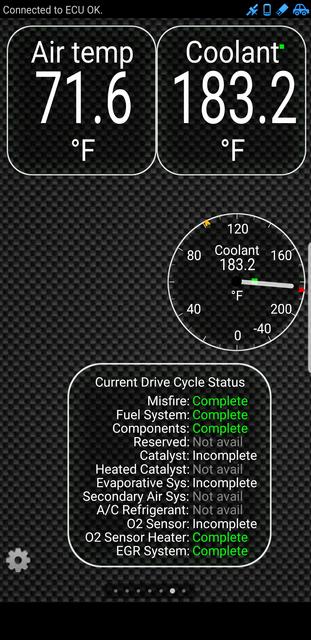

Get a obd2 Bluetooth adapter and Torque app on phone and get real time numbers for coolant temps... at normal operating temps mine range from 185-195 °F... sometimes creep up to around 200 °F..
ODBII - damn it - should have thought of that - yes I have one, a three foot extension cord and it's BlueTooth.

Guess I'll do that tomorrow....
Well, well - aren't you guys super smart.
Here's the reading from this morning - seems perfectly nominal. Hadn't been running it that long when I took the reading.
Thanks all!
Patrick
