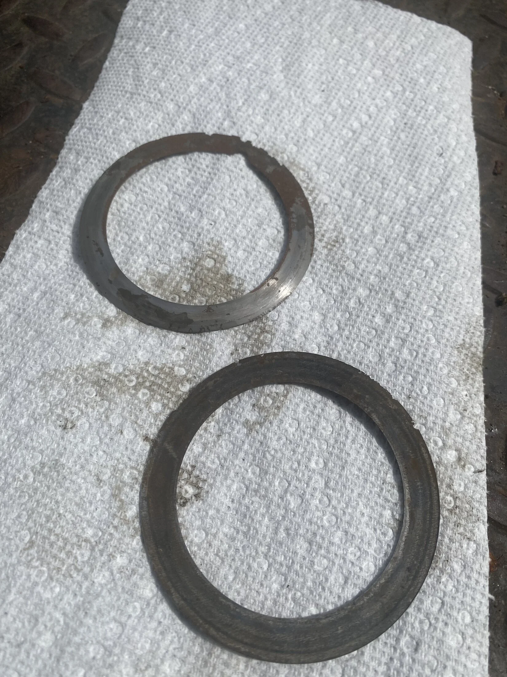

I Would like to replace these Two Shims, In my 3sp Fairey Overdrive. It’s the only two shims in this unit. All other parts look ok, I’ll post up Questions in FAQ thanks

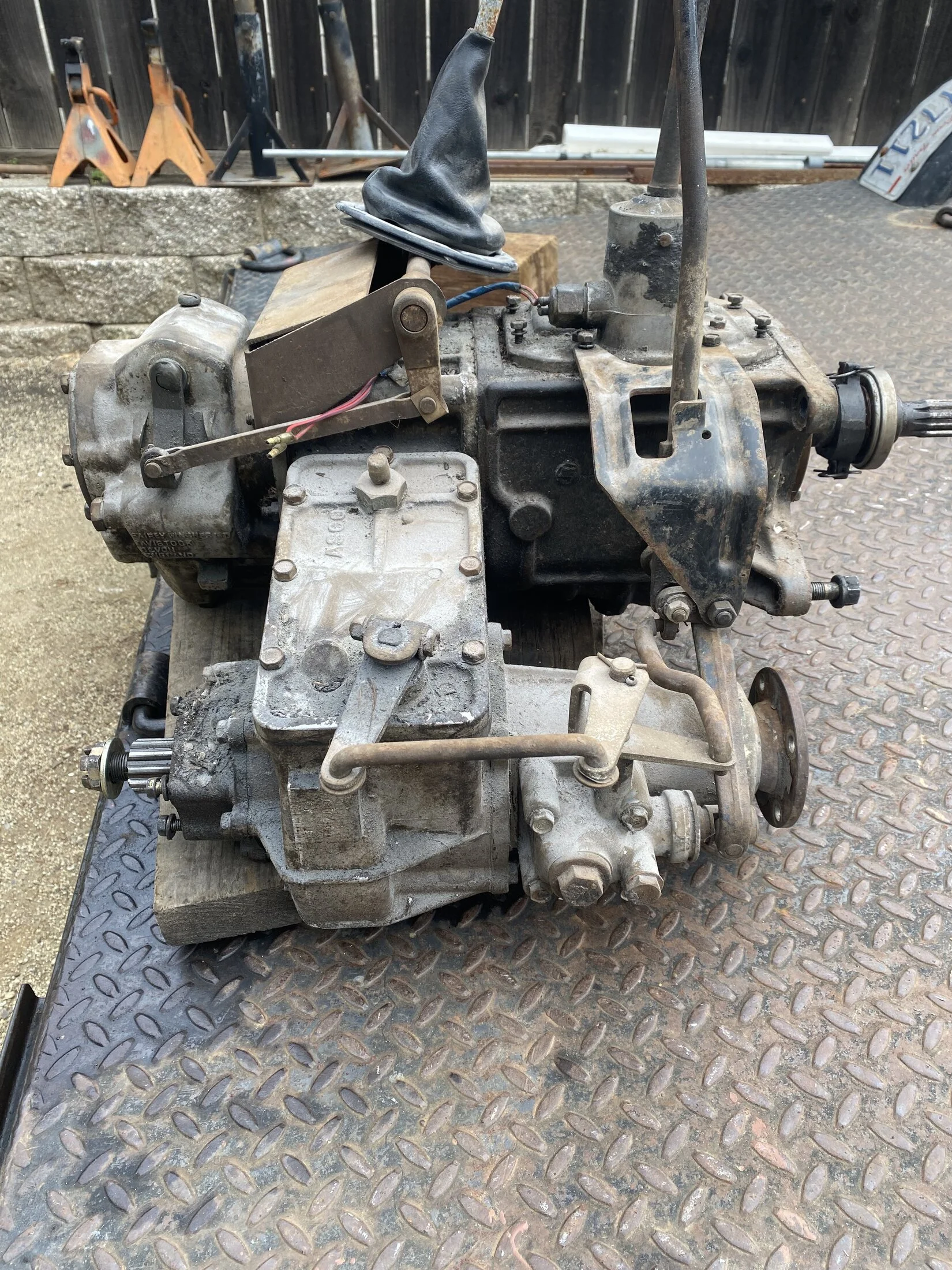

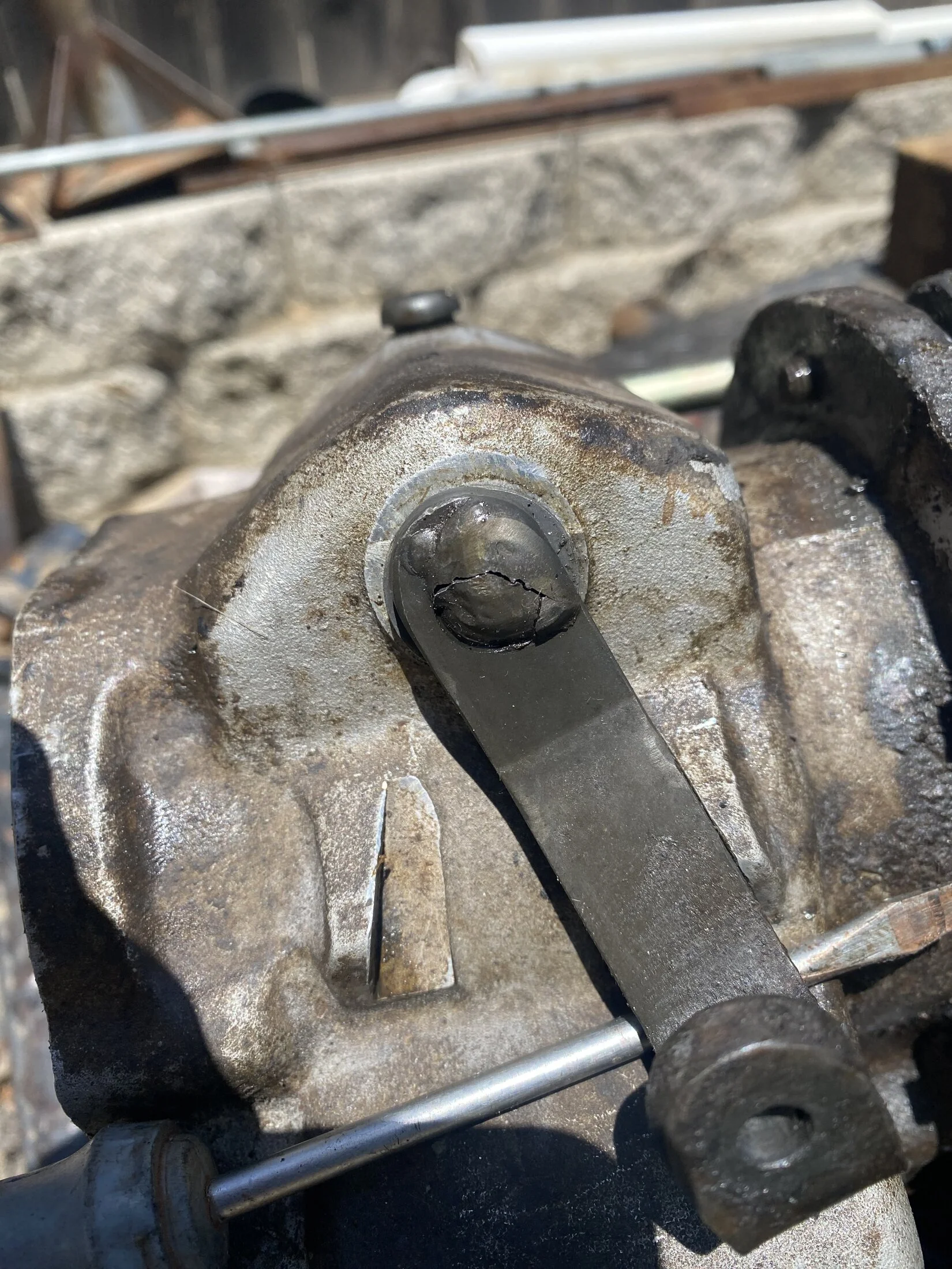

Hello John yes I have the two shims can you help me? Also everything looks good what part wears? The only thing that was broken was the shifter the weld broke, look at pic close, I have the complete setup. Iam hoping to fix and sell it

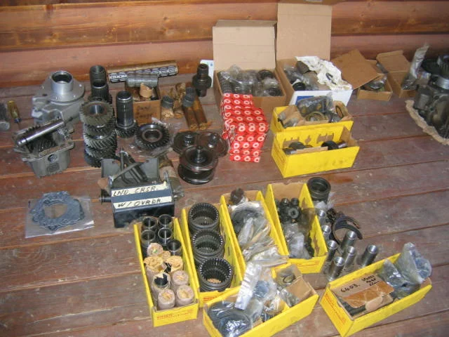

I acquired the Fairey Overdrive parts from a business who was no longer going to work on. That was because parts were no longer available from Fairey. In the parts there was a bunch of certain bearings but very few shims were included.
Hey @Half Wacked aka Split Pea why not get some shim stock, fold it in half and cut your own shim ring?
John, that is an EXCELLENT suggestion ! The odds are that whatever wore the originals out changed the tolerances, so just replacing the originals may not be adequate.
First class advice there.😊
