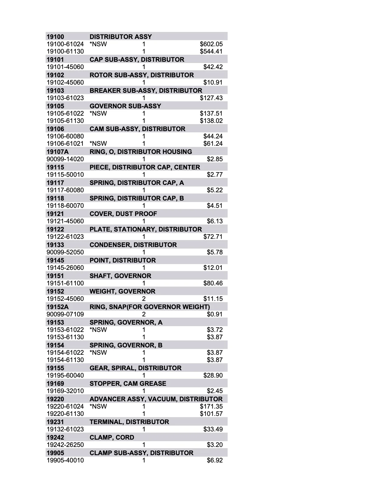

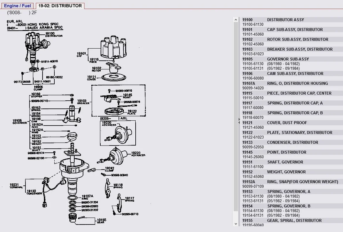

My copy of Max Ellery's repair manual includes a table that shows 19100-61024 (vacuum retard) for NSW and Victoria, with 19100-61130 (vacuum advance) for the rest of Australia. Also, ToyoDIY.com shows 19100-61024 for NSW.

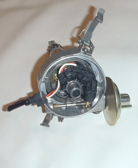

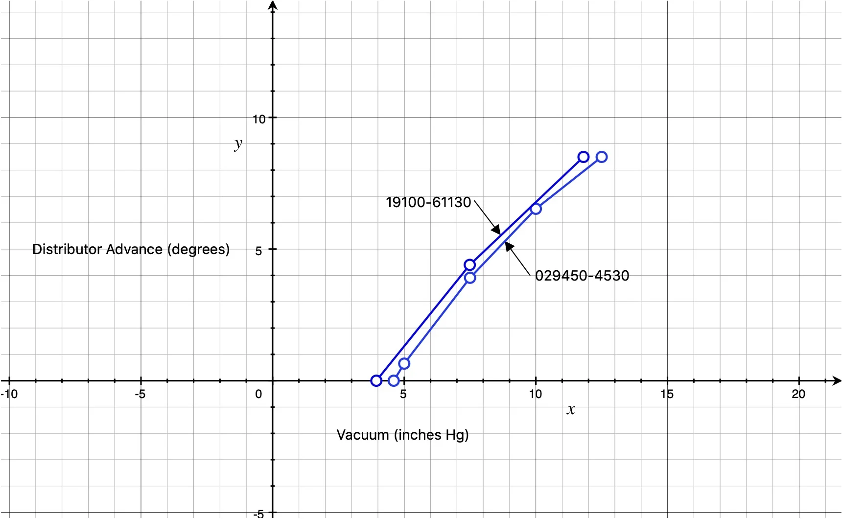

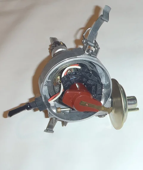

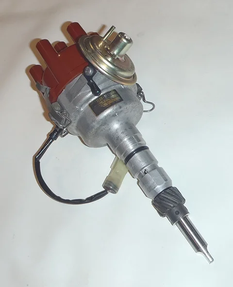

Well, you may be in luck! I have a newly refurbished '75/'76 2F distributor that I've converted to Toyota electronic ignition, but I could easily convert it back to points, with external condenser. And I went back through my tabulated vacuum advance curves and discovered that I have a good used NipponDenso vacuum advancer with almost the same vacuum advance curve as the 19100-61130 distributor. The advancer is from a '77 non-US 2F distributor I bought off eBay last year. With the exception of the governor springs, it would be very close to the distributor you're looking for.
Here are some photos of the refurbished distributor with a different advancer, and a vacuum advance plot comparing the advancer I have and the 19100-61130's advancer:

I guess I will have to look for 19100-61024 ?
If you see one let me know or even one will work.

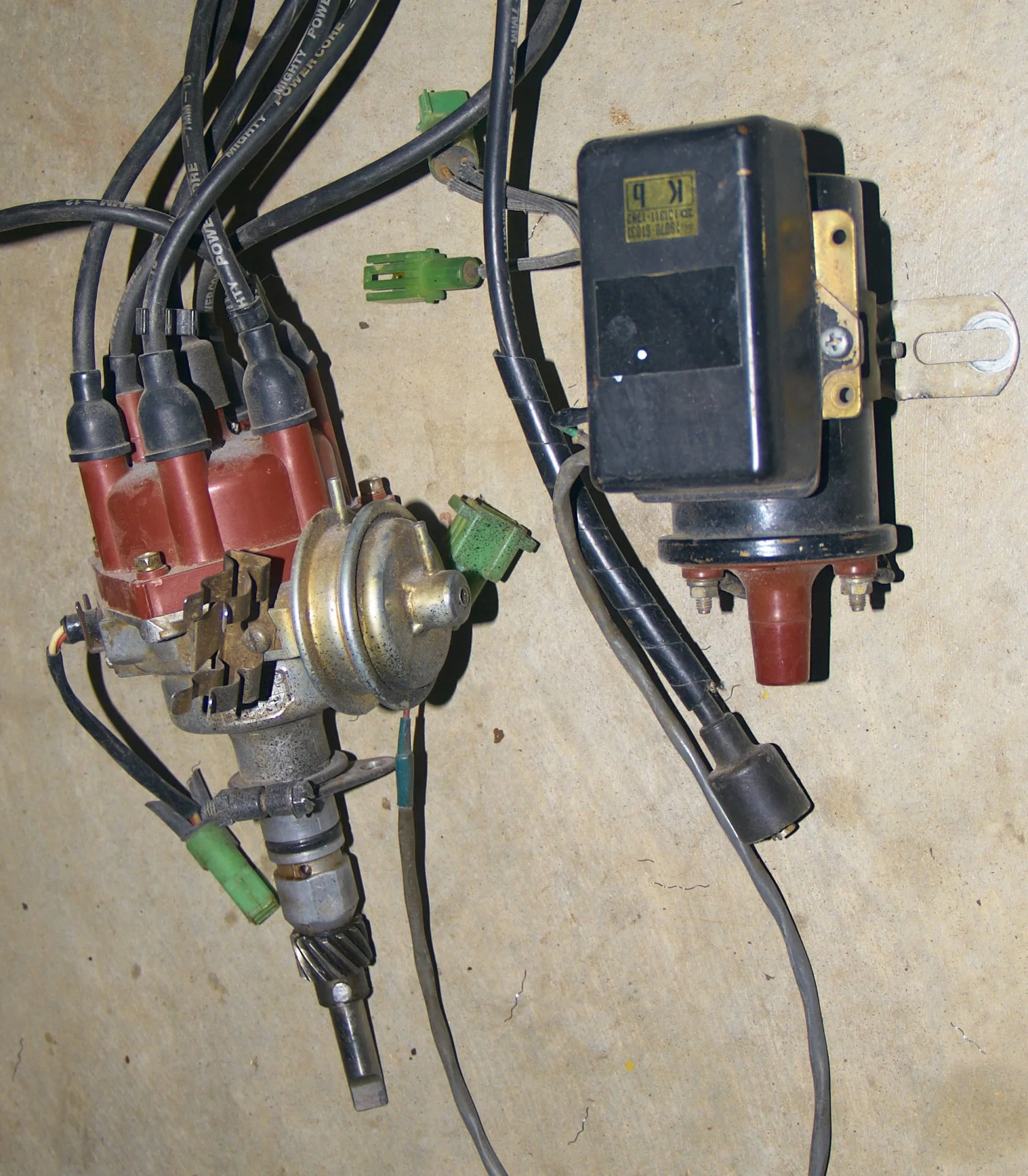

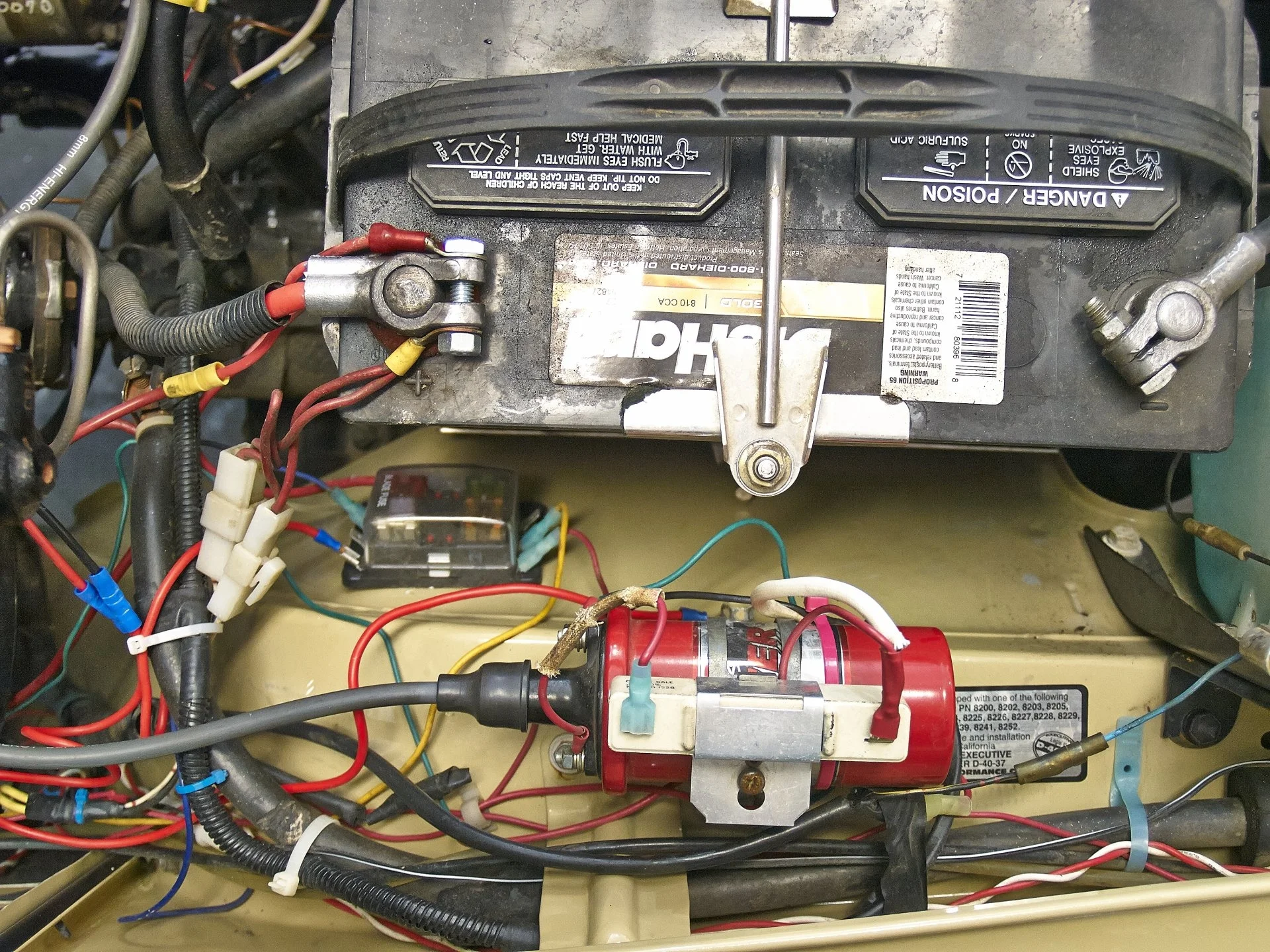

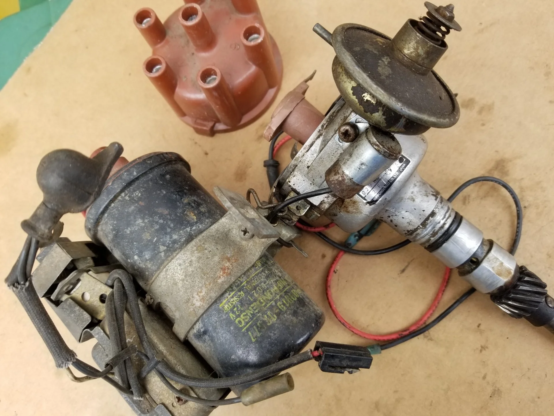

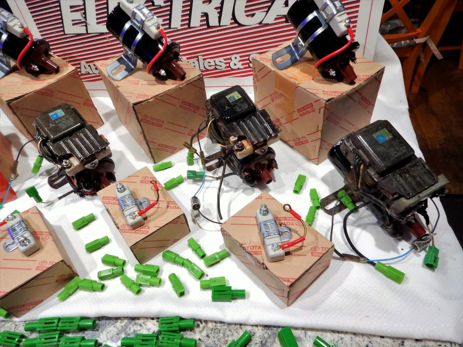

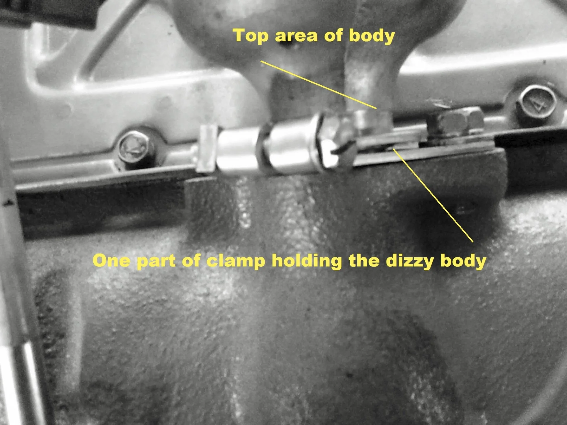

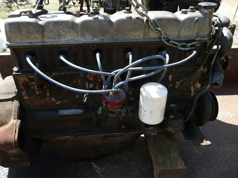

Pic-1 Coil am using, P-2 carb installed p-3 dizzy that may still have P-4 gat on dizzy now P-5 6 coil installed now
The gap above the clamp looks like it's excessive. It should be like the third photo. BTW, that looks like a '79 or '80 2F distributor.
EPC show OE dissy as 61024 or NSW 80-83

Hey anyway you can tell which distributor on this engine?
Price was too good to pass up. Mainly liked the cyclone air cleaner. Believe I dated to 11/83. Still sitting in Victoria where it was purchased. Would that put it in this odd distributor group?
Looking at the spreadsheet in the 2F Serial Number thread, 2F 759197 is August '83. The next number on the spreadsheet just so happens to be my (former, now owned by @mcguirejohnson ) '84 FJ60's 2F 792002 (December '83), so November '83 looks right for your 2F 768278. Your distributor looks like a 19100-61130 vacuum advance distributor - it has the same distributor housing as the US market 1/75 through 9/77 2F distributors, before they went to the three-screw distributor cap hold-down set-up.

Your Dizzy Photos show a USA SPEC. MED Cap Unit .............
the NON Circular 3 Sided type cap is a smoking GUN .....
you also have a Igniter Style Magnetic Pick up coil set up , this is a USA Spec ONLY design for reduced emissions requirements , and overall Reliable Life time NO POINTS to adjust ever Performance ....
see japan Toyota MR T viewed usa land cruiser people as lazy round eyes and likely to complain too much if points requiring periodic adjustment and replacement from normal wear were involved .....
so we got state of the art technology while the rest of the global spec market got WWII Vietnam era tech.
NOW your home work :

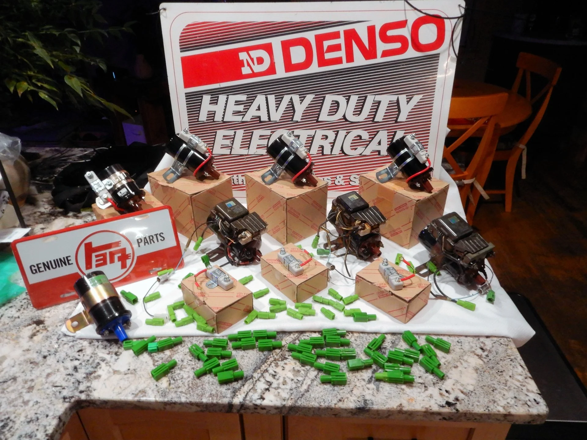

i see clearly , a original NIPPONDENSO Chrome Foil parts label in this photo under cap behind the double spring loaded tension clamp that will hold in place the 2 green igniter Splash proof YAZAKI Ignition Connectors inn place .........
take a close up clear crisp concise photos and report back posting them here
this will yield much info and what exact dizzy you have below here ?

- are these more example shots ?
the 89620-60011 and 89620-60012 are interchangeable units , both saddle a 90919-02077 coil , and same ballast resister too
