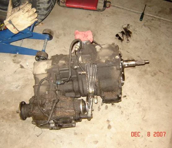

I was able successfuly remove the tranny and tcase. I just had to lift up my skirt get under the truck and put some ass behind a pry bar and poof like magic it broke free.

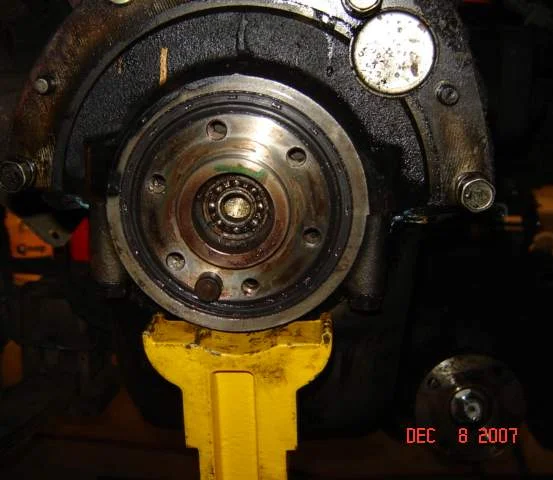

Next was the rear main removal/install. Can I say piece of cake here? It was the job that I was most worried about and it was the easiest job so far.

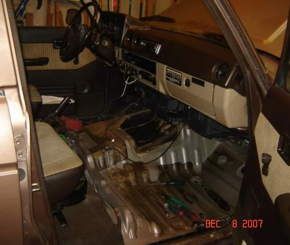

Note: 1. It is neccessary to remove the seats and carpet in order to access the shifter boot bolts.
2.There are 2 bolts on the top of the bellhousing that need to come off in addition to the four bolts on the inside.:doh:
Step 1: Was to access it.
Step 2: Put big screwdriver in the lip on the outside then jiggled it and it popped right out.

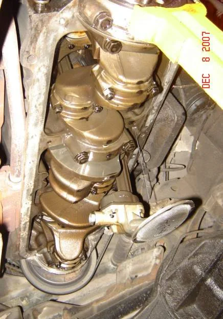

Next I removed the oil pan not to bad either just removed the bolts and then tried to pry it off gently wouln't budge so I grabbed my heat torch and about a minute on each side of the pan was all it took to come right off.

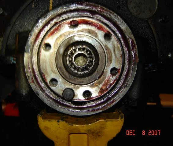

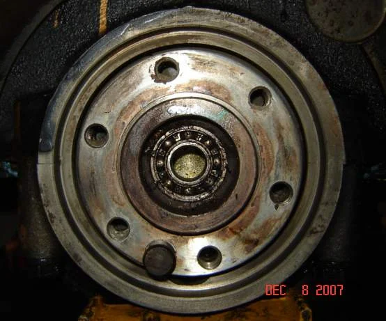

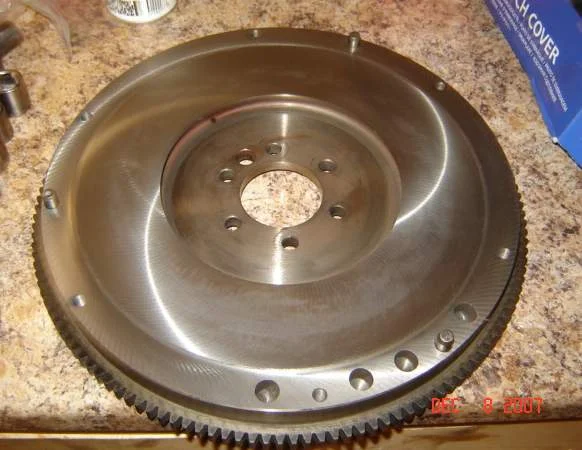

I also forgot to mention that I had the fly wheel turned.
It was only $35.00 @ Clutch service Wholesale Colorado Springs 719-598-9188.
Excellent job and only took 20 min with them pulling the pins.

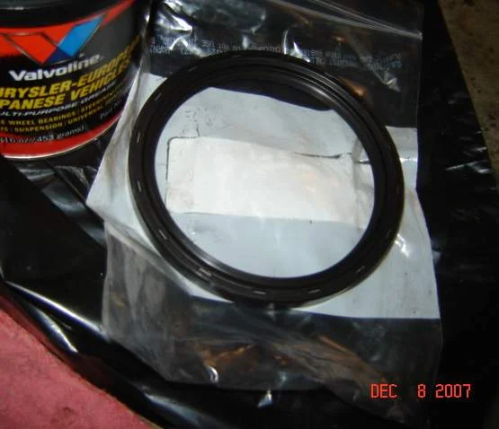

Here is the rear main installed.

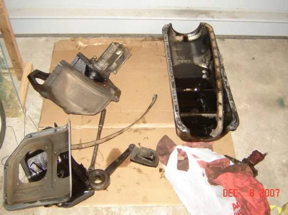

Here are a few more pics. Because I know it helps me when I am trying to do something and I have a picture to refer to.
