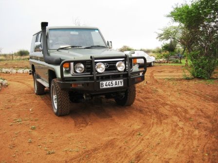

I was wondering if anyone has a electronic copy of a workshop or service manual for my vehicle, its a 1998 LX Land Cruiser HZJ77. I need to repair the electronic locking hubs and although i have some diagrams i thought a comprehensive manual might be useful.

We will look at them first and see if they can be repaired. There is a mechanic here that has an aexcellent workshop with just about everything. He has to make his own spares sometimes here in the desert - so we are confident we can repair them.
Will keep you posted though
