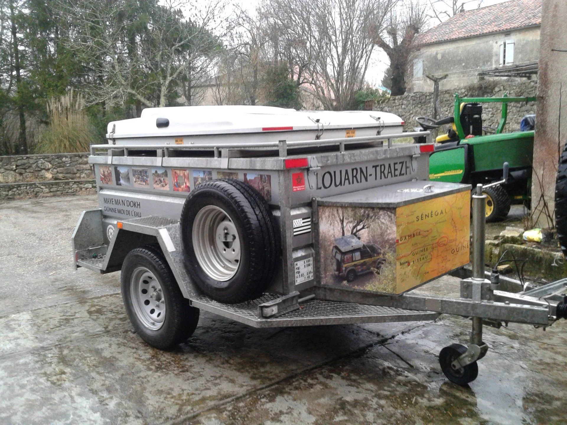

Hi everyone. We recently bought a 'new' off road trailer. Long story short, 4 years ago, this French chap had this made to measure, for running supplies down to Africa to a water project he was involved in - he collected it from the manufacturers 150km from his home and put it in the barn. He was then ill, the water project collapsed, and the trailer sat in his barn since then! It was fitted with a James Baroud tent, and was a price I couldnt ignore, so bought it!

Its just a box at the moment. Plans are Water tank, on demand pump, water heater, 12v electrics for fridge etc. All to be done during the summer, ready for hols in October!
