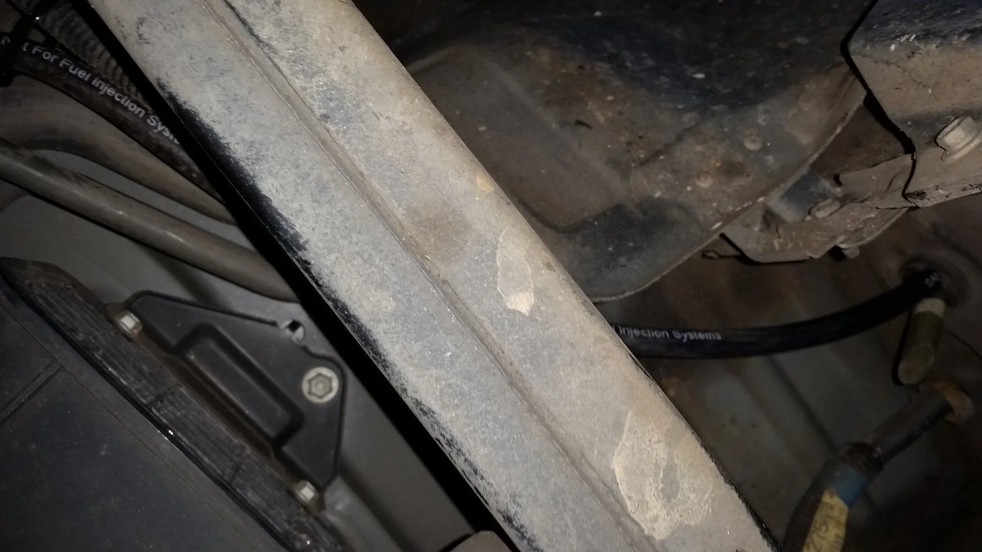

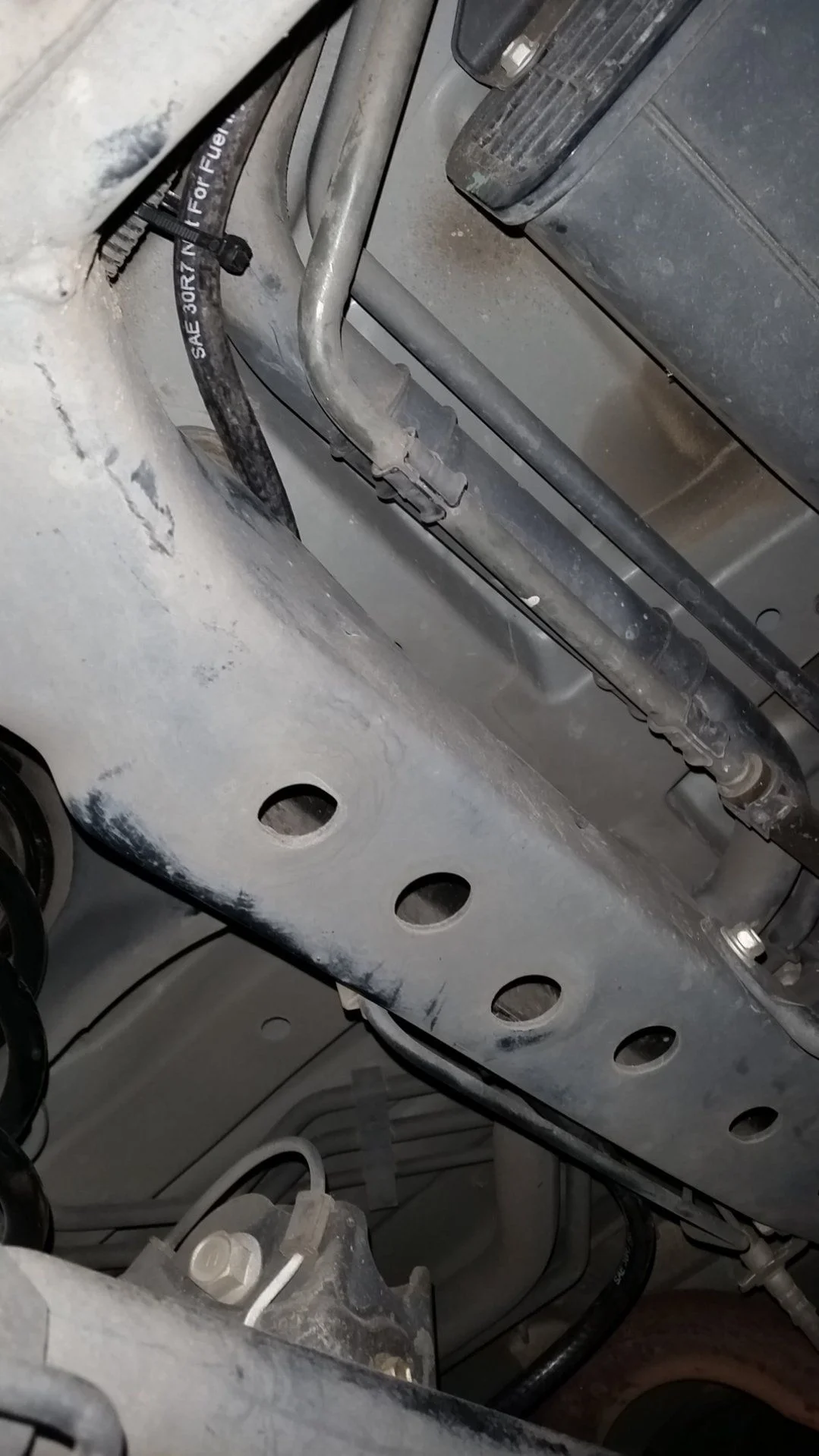

Extended the diff breather at the front. ended up on PS fender. Extended the diff breather on the rear up into the DS jack cover area through the same grommet the sunroof drain comes through. May add a 1/4" joint in the rear line so can extend further in future if I do a lift.
Front Diff
Rear Diff
