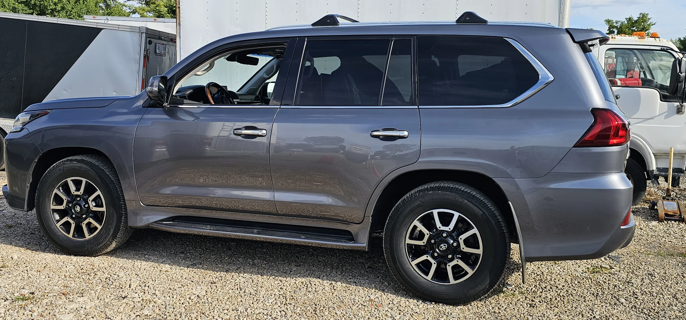

Thanks for all to their input, I pulled the trigger on this 2017, one-owner truck from TX. The undercarriage is clean! Living in the snow belt, that was important. However, there are a few issues and I was wondering if anyone had any input.

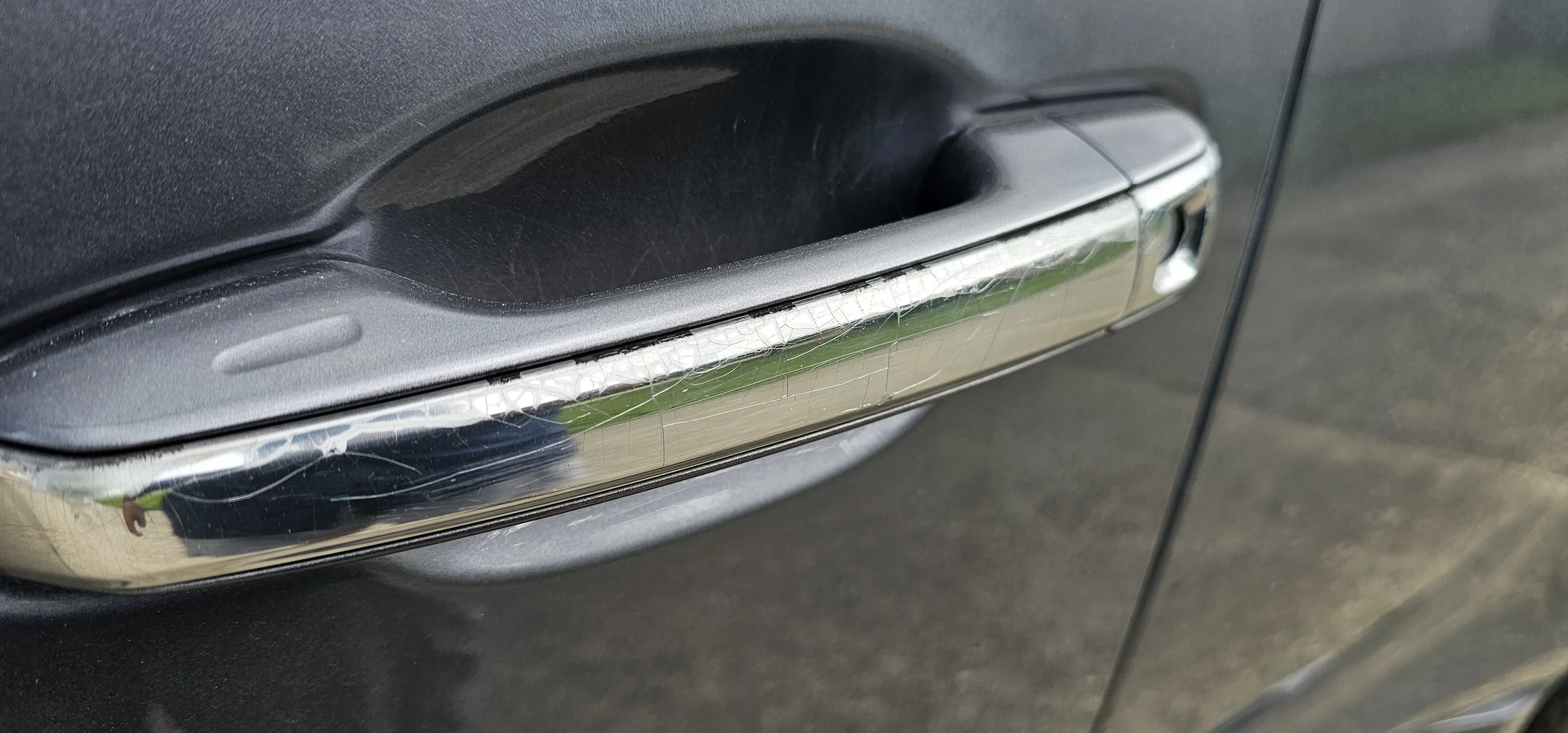

1. The exterior door handles are flaking and peeling. Any suggestions on how to fix this? I saw some people using the LC handle covers, but I'm not really sure what my options are.

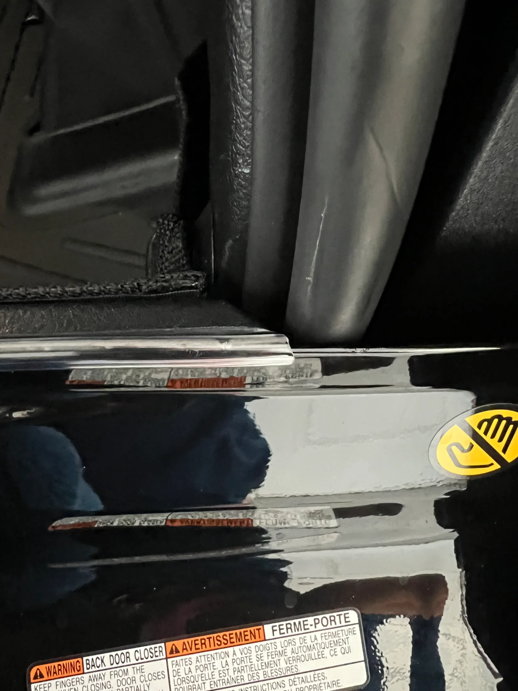

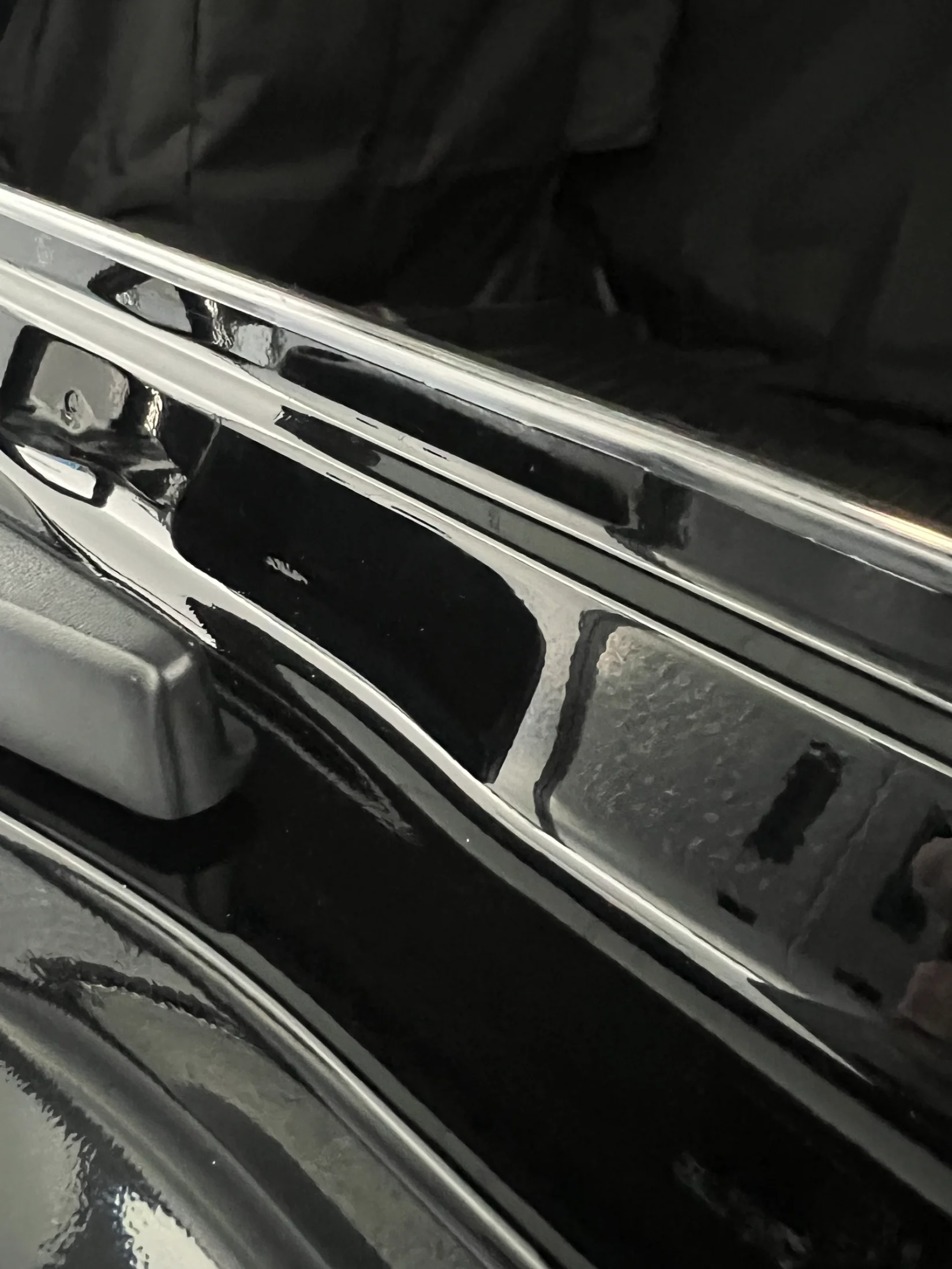

3. The top of the tailgate is worn down. The previous owner must have left the tailgate up when loading/unloading and scraped off the top lip of the tailgate. Any ideas of how to protect this area? I was thinking of something similar to a pool noodle, but much smaller.

For your tailgate, amazon sells XPEL paint protective film in strips of varying width. I'd start with that on a clean substrate (tailgate) if you're wanting to protect it from future loading goofs. Mine has helped save me from serious scrapes by sacrificing itself. I'd recommend this.

3. I'd suggest something more subtle like 3M protective film ( Amazon link ). Depending on the amount of wear, you may want to apply some touch-up paint first.

I bought this for the tailgate on the recommendation of another forum member. Have not gotten around to installing it yet.
Definitely recommend touch up paint on any bare metal before you install any protective coating.

If I were you I'd replace the door handles but I don't know what that entails.
I've had this on my tailgate for the last 4 years and it has held up great. I'd also recommend this from real world experience. Takes a few minutes to install.

Not sure what the finish is on '17 handles. But from pic looks like it is celar coat. Don't know if that is from the factory or previous owner applied it to fix scratches on the chrome. The sure simplest fix is replacement.
Depending on the damage you may try to sand it and clear coat it, but it looks to me beyond that. You cannot sand it completely without scratching the chrome. Maybe that is a look you are Ok with: brushed chrome and then clear coat. Or paint in the truck color.
Compare cost of new handles to the cost of painting. Maybe you can save a bit on painting by removing/install the handles yourself and have a shop do the spraying. For a clean look I recommend removal, not spraying on the car.
If the chrome piece can be separated from the handle, you may try a paint stripper to get the clear coat off, then a chrome polish to restore the shine and then clear coat again or leave it bare. If the trims are actually chromed plastic this may not work.

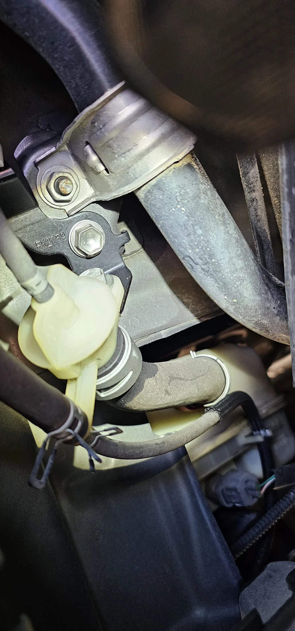

A few days ago, my wife and I picked up our travel trailer for an upcoming trip. At some point while we were disconnecting it, my AHC sprang a leak. There was a decent sized puddle near the passenger rear tire, maybe a 1/4 cup of fluid. What I think happened is this - the AHC and the trailer jack were working against each other and the fluid came out of the overflow. I cleaned up the area, cycled the AHC H-N-L-N-H multiple times, took a few test drives, and checked for codes with Carista (no codes). Everything seems to be working fine now. I'll keep my eyes peeled for leaks and a change in ride quality, but so far, so good. Any thoughts on this? Anyone seen something similar? I know the truck had a shock replaced prior due to a leak; perhaps they overfilled the AHC fluid?
Just got back from a few hundred miles towing our travel trailer. While I was concerned about the potential AHC leak and the 4LO/center diff error codes, the LX performed flawlessly. Not a hiccup, no leaks, no lights on the dash, nothing. I used 4LO all weekend in the campground to exercise it, switched the center diff lock on and off a bunch, and cycled the AHC every time I moved the vehicle, which was a lot. No issues whatsoever.
