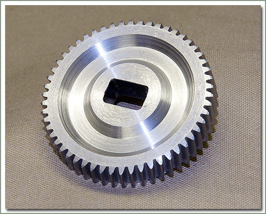

So looking at this motor and gear it appears the keys are built into the gear. The replacement gear Scraps pointed out above looks like its a smooth bore hole? Heres a couple pics of what I have. I also am trying some 3M adhesive which is really strong to see if I can buy some life but I doubt it LOL. .... any insight on this gear style? The PO said tailgate was off of a '78.
You need the SOR 138-18B-A, AFTERMARKET TAILGATE GEAR -Fits 1975-1980 FJ55 FJ55 - That unfortunately is, (Discontinued - Not available at this time)
Thanks JMac, was afraid of that after I read wardamneagles reply :-( Do you guys think a 3D printed part would stand a chance??
To be clear, the assembly will run on either shaft/gear combination. I might have one of the other shafts that will fit the gear that SOR has in stock. Might take me a day or two to remember where to look for it.

The picture you posted of the (let's call it the pinion gear) has a black piece on it. That black piece belongs with the plastic ring gear. When the plastic broke the black piece stayed with the pinion. Wareagle is right, you just need the different pinion gear to match the new (ring gear). I'll try to get some pictures up tomorrow. This is a fixable problem. 👍

I have found the round shaft and C clip. Let me know if you source a mating gear and I will give you the shaft.....in a manner of speaking. 😁
