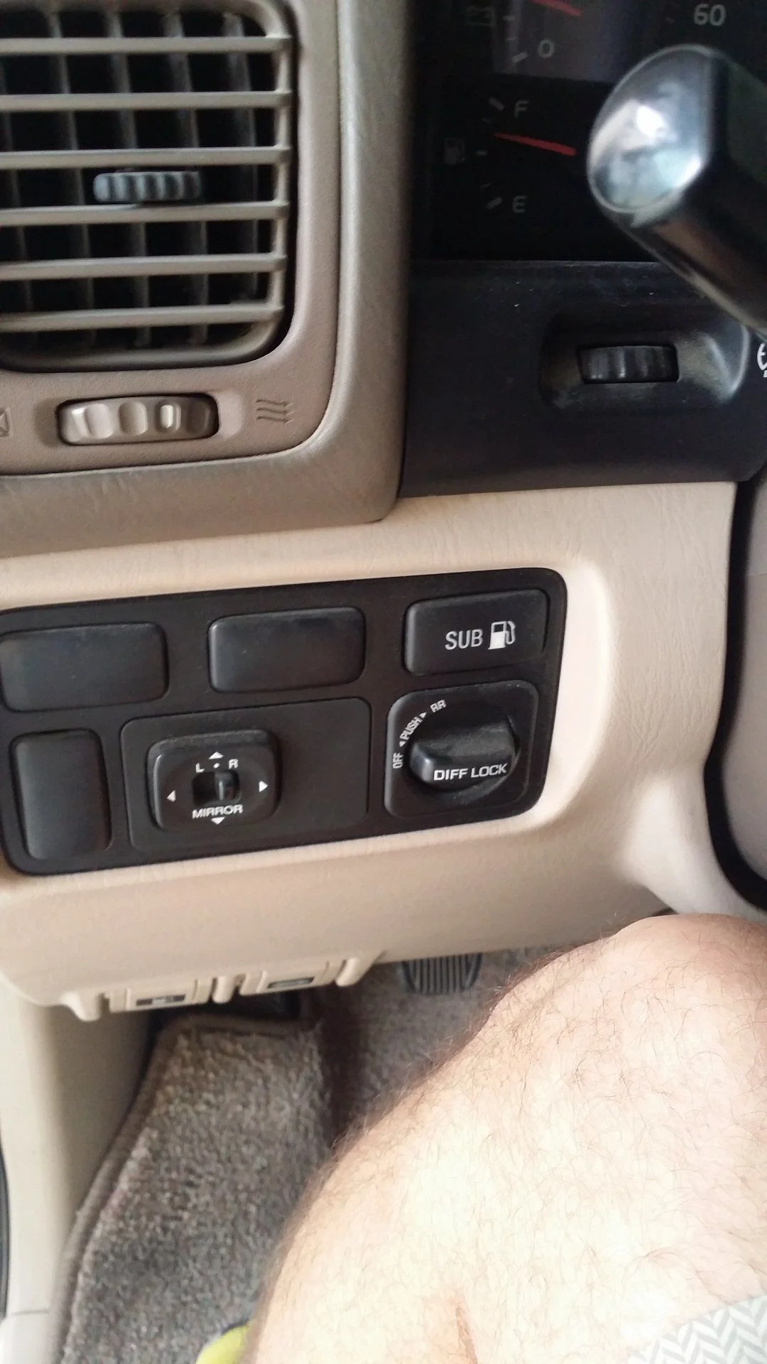

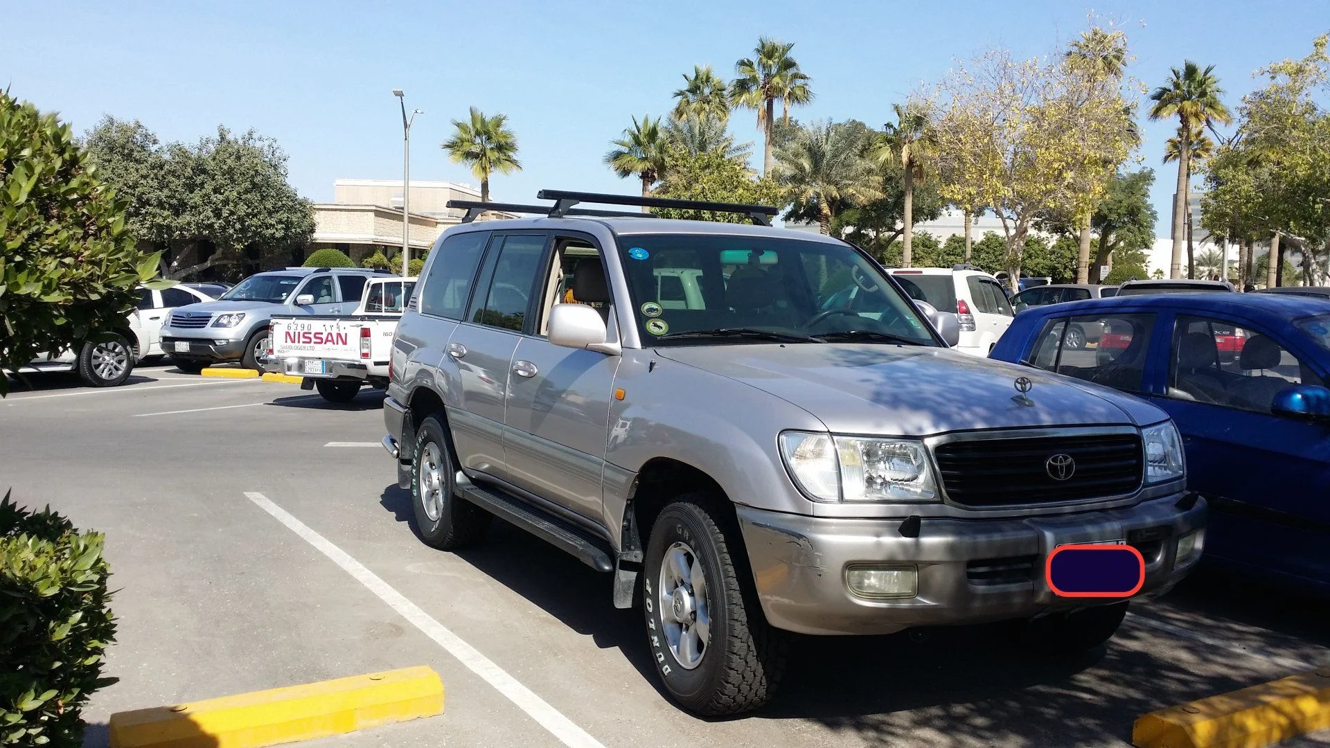

Gents, hope all is well back home! American here living in Saudi Arabia. I just purchased a GCC spec 2000 Landcruiser VXR it also has:
AHC
Toyota OEM winch
For its age it is VERY low in mileage. We have an hobby shop here that was started by we Americans 40-50 years ago. There are land cruisers all over the place here. I put it on the lift and here is what I had planned:
