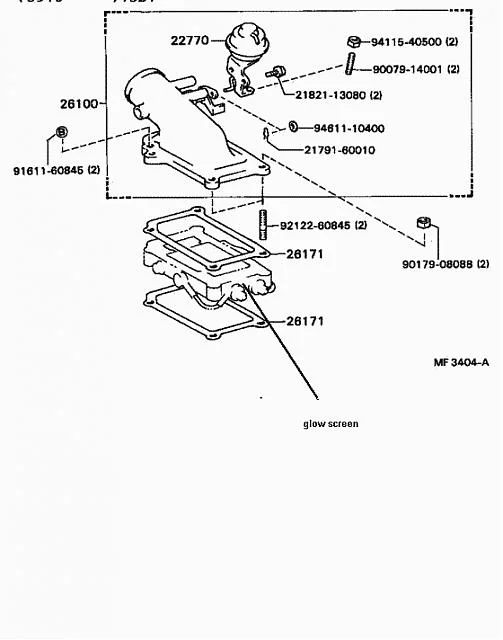

So the 13bt uses a screen to preheat the air before it goes into the head, is that what I'm seeing in the picture?
Now if the glow screen is preheating the air charge then due to the turbo doing kinda the same thing once it is running, then the glow screen would not have to work for all that long right. So am I off in left field or am I barking up the right tree?
I have been around Diesels but I thought that they all had a glow plug type system in the head much like a spark plug.

Ok now here comes the dumb question...................
Yes

Yes the 13BT is screen not a plug; my understanding is the screens are a more robust system and are easier to field service than a plug (IE why you see them in the 13BT and in some of the older utilitarian BJ40s.
Both plugs and screens are only used on startup, and even then often only in cold conditions. The basic idea is to ensure that the fuel being injected into the compressed cylinders will fire, when everything is super cold IE first start in the morning at -10, its unlikely that the fuel will combust. Its during this time that you would want to "glow" the engine for a few seconds before turning it over, after it's fired and there is combustion occurring the latent heat produced will be more than enough to maintain the engine so the glow system is un necessary. However this has nothing to do with the turbo, there is more than enough heat to maintain the engine from all those little explosions.

a turbine in your helicopter is a continually burning combustion chamber. The diesel is compression ignition. It's the compression that ignites the fuel. The glow plug doesn't ignite the fuel on a diesel. In a heli turbine it ignites the fuel.
On a diesel the glowplug warms the head enough to have the fuel start to ignite on start up. Once it is running the head warms up and the detonation becomes easier. The glows only glow prior to start up. And sometimes after for a short bit till the head is warm.
The glow screen uses warm air to help the compression ignite the fuel. Once the starter is off the glow screen quites.
Glow screens are generally on diesels that are called direct injection. Do a search to find out about them.
