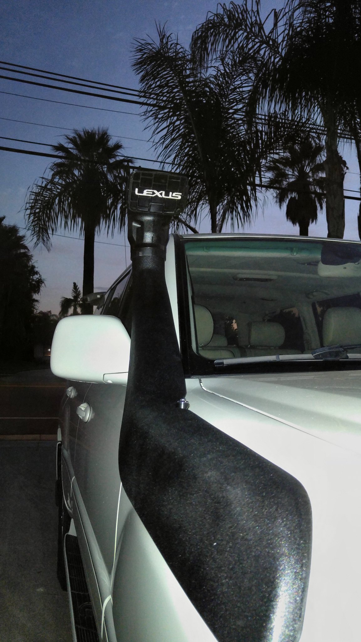

I got my snorkel with the horrendous lettering "power ful" so I decided to fix that. I just posted some pictures of it here:
TJM Knockoff snorkel fitment post #48 fyi.

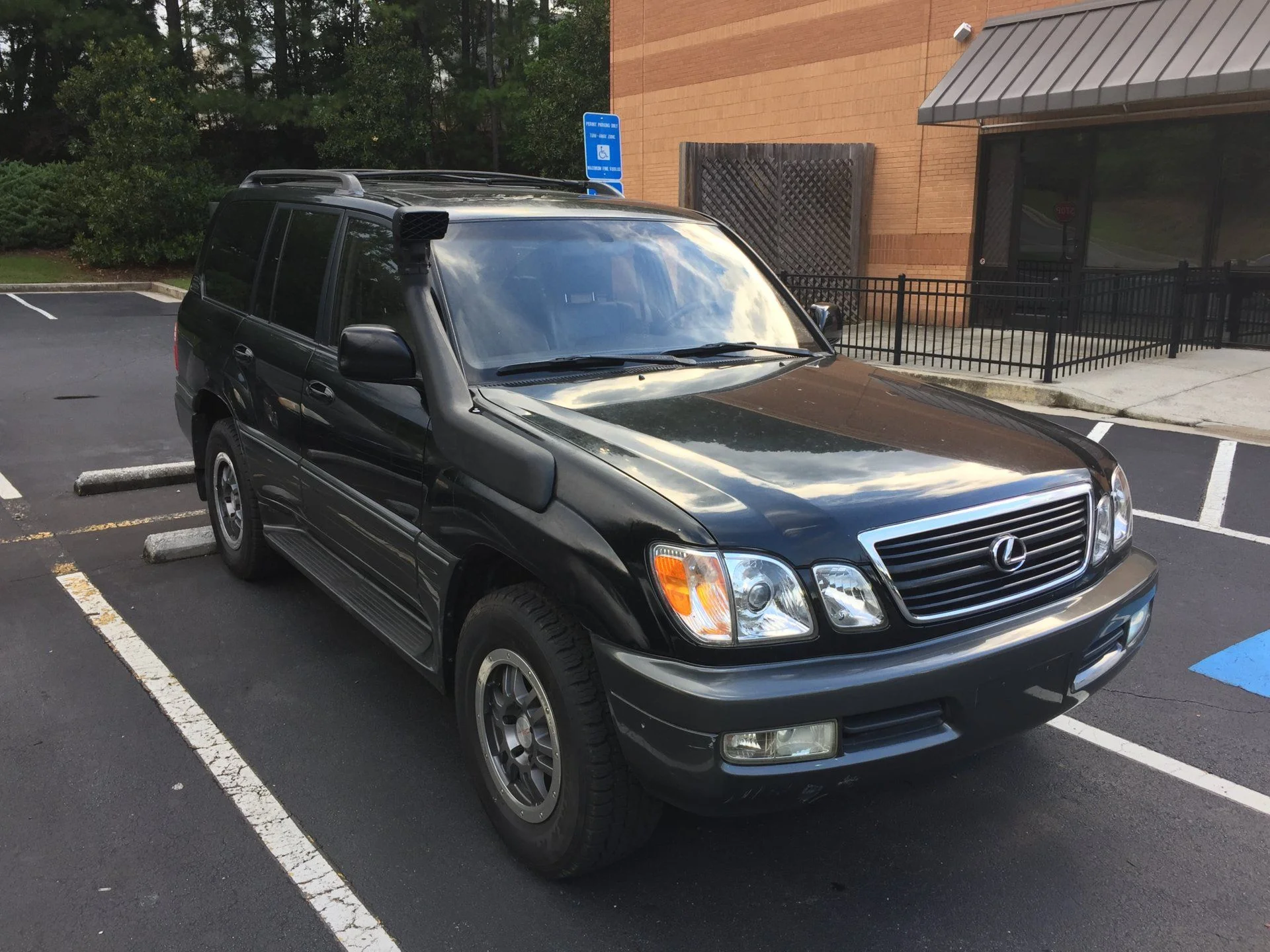

Hard to beat the trusty old nock-off I bought for $66.00 on eBay!
I love mine!
I was so disappointed with the surface finish I repainted. Also designed and 3D printed a custom grill for it.

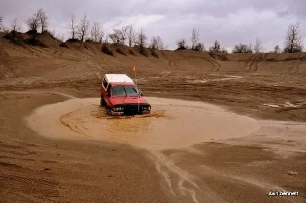

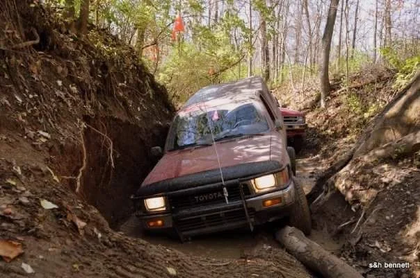

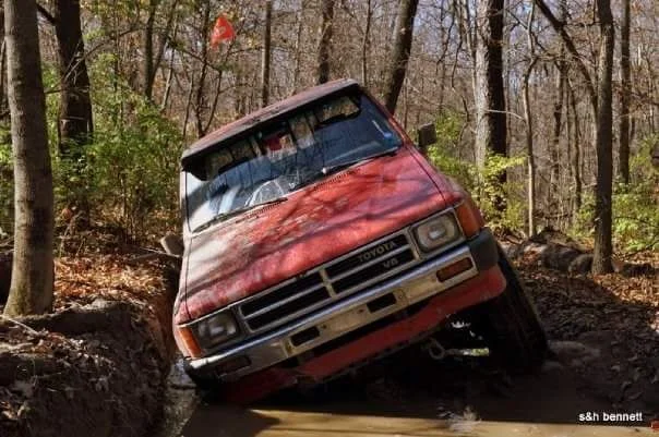

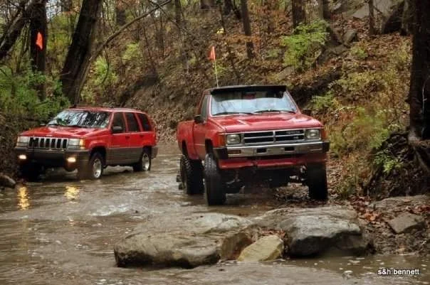

In engine pulls in air so fast it would pull in water and indeed hydro lock if you dropped your intake below the water line. I watched my friend Eric do just that at idle speed. He had a lifted toyota and dunked the front end into a deep mud hole at slow idle speed and the engine ingested lots of H2O. I was the one who towed it to my garage and drained the engine oil and turned it over with spark plugs removed and had tons of water in oil and water coming out of cylinders. So I don't think it would merely stall from lack of air. It would ingest water.
Some pics from that awesome day:
View attachment 1499812 View attachment 1499813 View attachment 1499814 View attachment 1499815 View attachment 1499816
How was his air ductwork done? Factory set up still or something else?
As you know water is heavy, a engine is not going to suck in enough water at idle with the air intake underwater. Otherwise our trucks would all hydrolock when we drove in the rain.
What I am talking about is the OEM intake opening behind the front wheel, NOT the one under the hood. If you opened the air intake up to only get air from under the hood and not from the duct work that runs through the fender then yes, it will hydrolock. But I am talking about the air intake that starts right behind the passenger front wheel, goes through the inside of the fender, where it is sealed from the engine bay, to the air filter box, then to the engine. As long as all of that is hooked up you're fine.
Now to be clear, I am NOT saying that if you stopped in water over the hood with the engine running and all factory air ductwork in place that you wont hurt the engine, what I am saying is, that water up to the wheels will not hurt the engine with the factory duct work in place.
I can vouch for this. I went into a short crossing I had tested and felt safe to continue. Little did I know someone with huge swampers had rutted the snot out of the middle.
I emediately sunk to chassis and tires spun free with atrac desperately trying to help me. I had muddy water coming out of the side of the PS and DS hood. And some water entering front area.
It took a while to get her out and I suffered a loose CV seal and dying alt. Drove home with battery light on. Very slight water in the air box. Insignificant to damage engine. Very thankful no major damage was done and we got the family home safe.
If you guys want to risk your motor running in deep water, more power to you. His airbox setup was stock. He was creeping along at idle along a deeply rutted trail, we had done a ton of water crossings earlier in the day so no one knew this hole was so deep. Water was above his hood. He dropped in. I radioed for him to kill his motor but it had already stalled. I pulled his truck out of the hole backwards and towed it home and drained water out of the oil and had water putting out of every cylinder. So if you're lucky, hats off to you. I just ordered a snorkel because I don't want to ever be my friend Eric who basically scrapped the truck after that.
