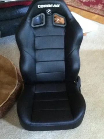

Mmmm. Suspension seats!
:beer: R
My fat ass cant fit in seats like that. They are pretty thoe.
Corbeau does make wider versions of many of their seats.
I had the suspension seats in my FJC, love them. They will be going into the truggy.
Let me know if you need anything else Ramon, I am a Corbeau dealer.
Stan
Stan
Hey, sorry about that Stan. 4ws.com had a thread on Pirate and quoted me a killer deal. Basically, I the 2 XRS seats and universal sliders shipped to my door for $675 total. That's less than MSRP for just the seats before shipping or tax. I should have checked with you but didn't even think about it - my bad.
