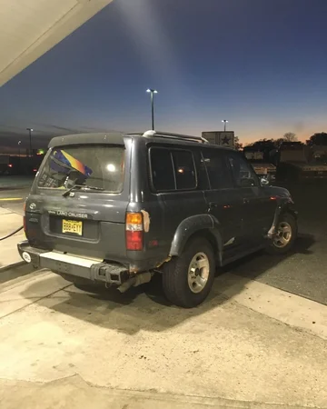

First picture: is on the way home

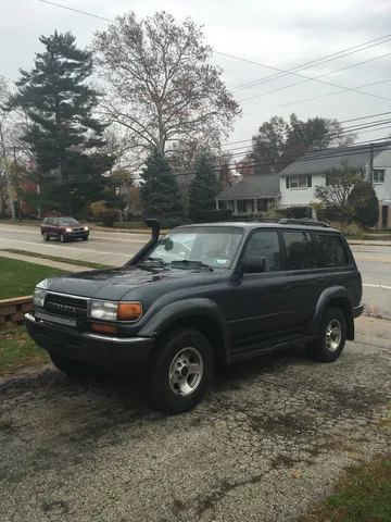

Second picture: the snorkel and light bar
