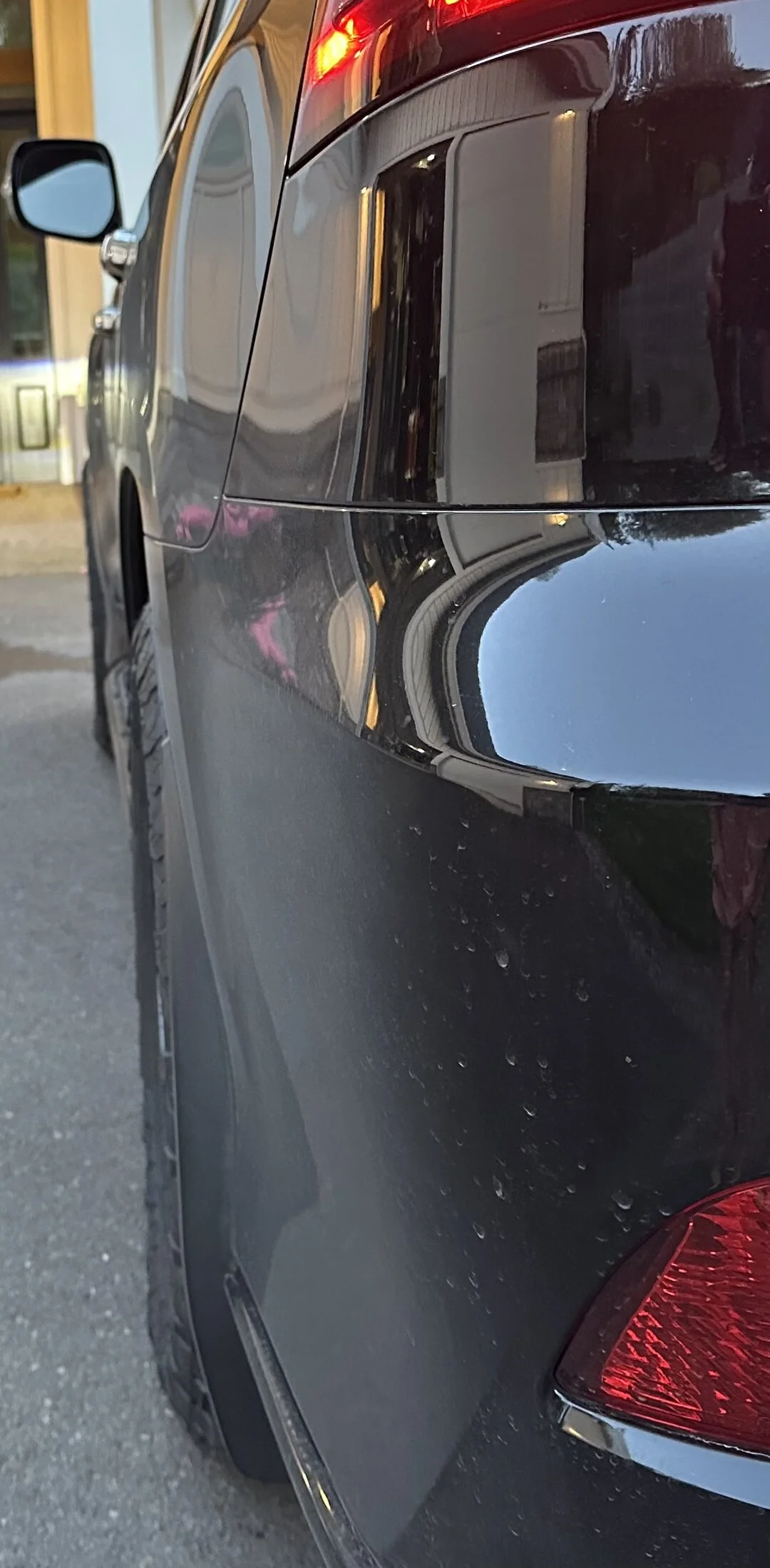

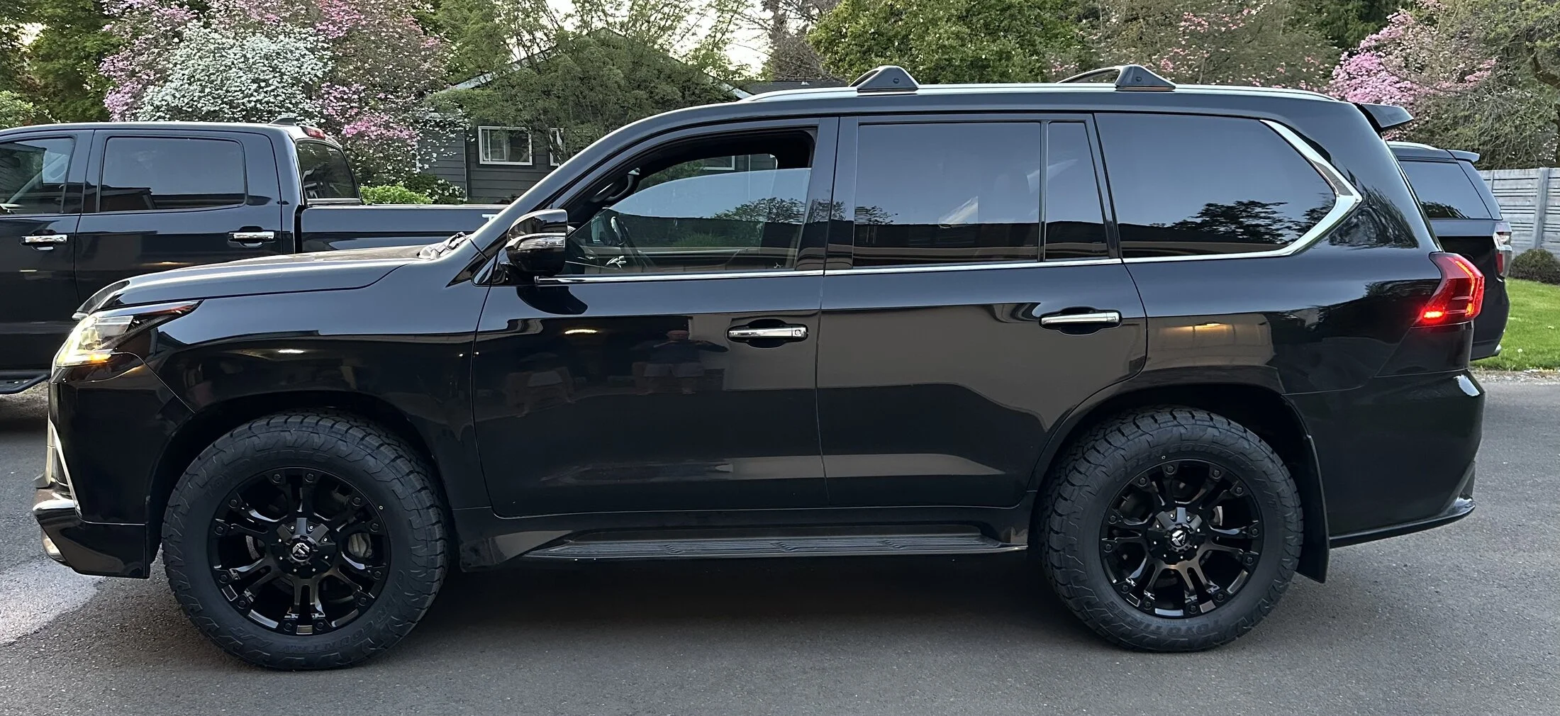

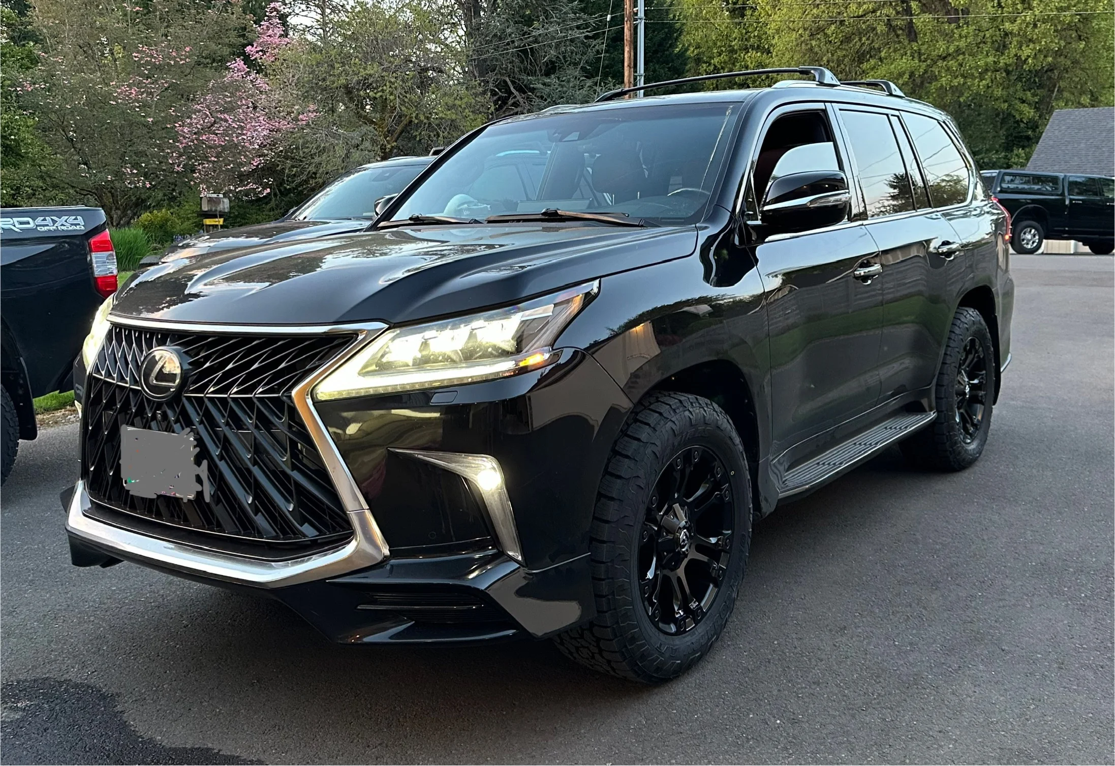

After install there was a good amount of rubbing on the front wheel well and the front mud flaps. I did the sensor lift and removed the mud flaps then did some heat gun work on the front wheel well. So far I’m clearing all around. Going back to for an alignment tomorrow.
For reference here are the sensor lift gains (measured from ground to fender):
Dr Front: before 34 15/16”, after 35 7/8”
Pass Front: before 35 3/8”, after 36 3/8”
Dr Rear: before 36 1/8”, after 36 1/2”
Pass Rear: before 36 1/8”, 36 5/8”

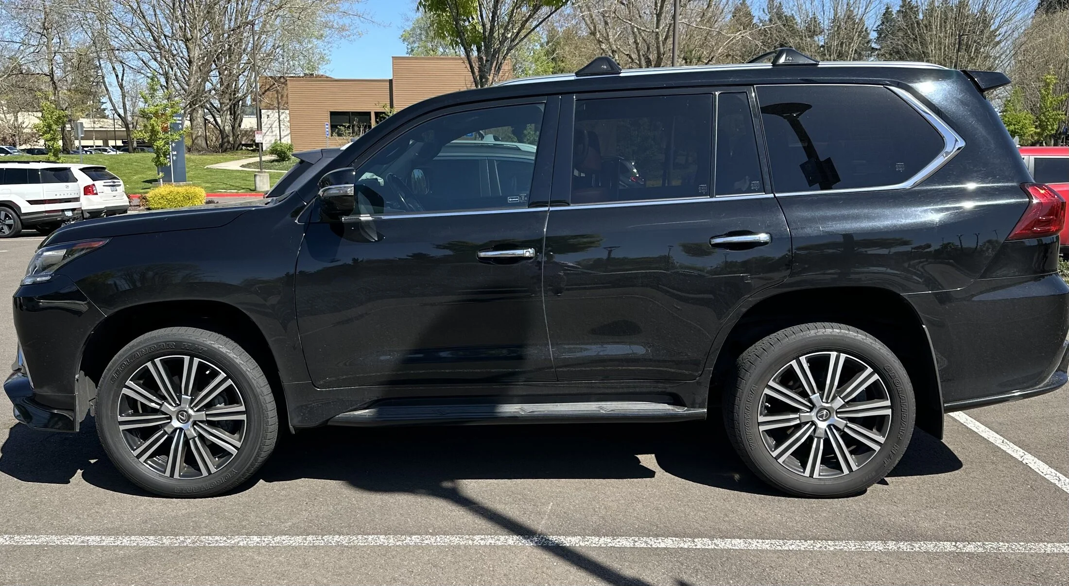

Here are some pics, first one is oem wheels and tires in high setting. The next three are all after the sensor lift:
