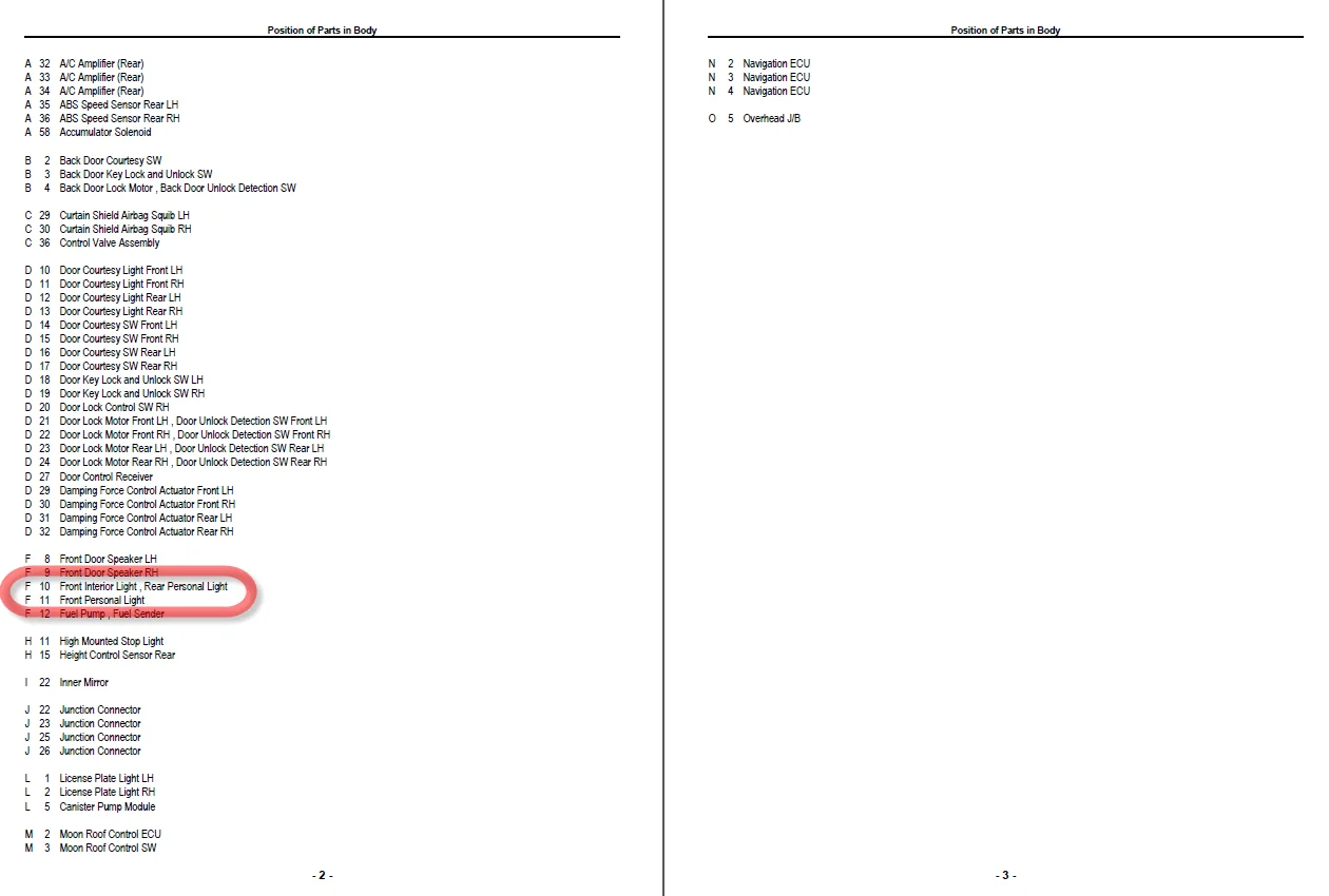

Download the EWD from the Resources section. Page (1) has the light circuits on it. Everything is connected to the Body ECU through the DOME relay. Check there first.
FWIW, the EWD has a circuit troubleshooting guide for every circuit in the truck.

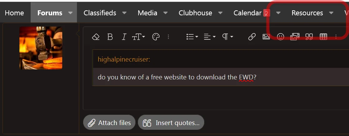

do you know of a free website to download the EWD?
