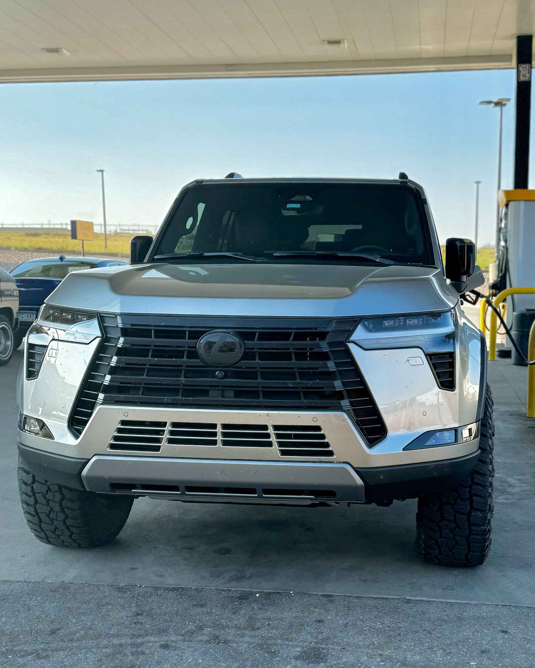

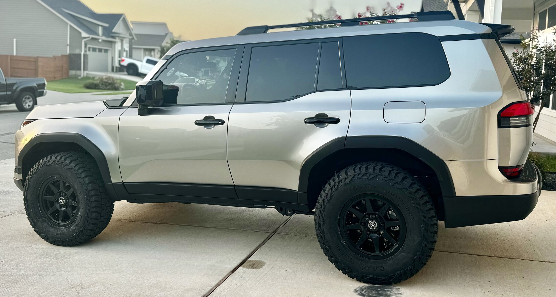

Long time listener, first time caller! I received my ‘24 GX550 Overtrail+ last month and am already deep into mods. Really excited to see what products get released for this new vehicle. This is going to be another all-out build for me and I really hope you follow and comment on the progress!! I’ve already swapped the OEM wheels and tires for 17’ ICON Rebound Pro’s wrapped in 35x12.5 Mickey Thompson Baja Boss A/Ts. This week ADGU (Air Down Gear Up) is finalizing the rear cargo platform system (pics on their IG and mine). After that? Bumpers, sliders, and rack from Dissent Off-Road! Oh, and hopefully ICON or Dobinsons gets a suspension system out there VERY soon, ha!

These are +25 and I think the stance is legit. Next week I’ll be getting onto some trails in CO and will have a better idea of figment….hopefully I don’t have any issues, or rip a fender off haha! Dissent Off-Road is running a different ICON wheel with +40.

Long time listener, first time caller! I received my ‘24 GX550 Overtrail+ last month and am already deep into mods. Really excited to see what products get released for this new vehicle. This is going to be another all-out build for me and I really hope you follow and comment on the progress!! I’ve already swapped the OEM wheels and tires for 17’ ICON Rebound Pro’s wrapped in 35x12.5 Mickey Thompson Baja Boss A/Ts. This week ADGU (Air Down Gear Up) is finalizing the rear cargo platform system (pics on their IG and mine). After that? Bumpers, sliders, and rack from Dissent Off-Road! Oh, and hopefully ICON or Dobinsons gets a suspension system out there VERY soon, ha!View attachment 3696604View attachment 3696603

Caution on the +25, folks. Here, starting at 9'30", is ICON themselves testing a 25mm offset on the LC250. They show that a 285/70/17 (~33x11) just clears the fender on compression but warn that a larger tire will have issues clearing at that offset without extended bump stops to limit the uptravel. In the earlier part of the video, they show that a 40mm offset clears wide 35s and below.

will need to take a look. the +25mm is also a 8.5" wide wheel vs 9" at 40mm
I reached out to ICON through our rep (I'm a dealer for ICON alloys), and they noted pure engineering opinion vs who is running them.
He responded with 18" +40mm ( 9" wide rim) and 17 +25 (8.5" rim). A bunch of customers run the 17" wheel. In the video, they refer more to a similar 9" wide 17" wheel but did recommend the RECON for its flat-face design.
