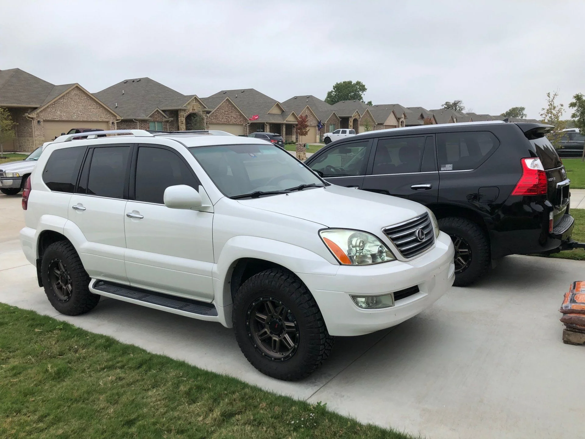

My pros and cons for each so far are below, and remember this is based on my experience owning both. In the end my wife and I love both and we are glad we have both. I feel like the GX is the perfect platform for about any need really, minus the go fast need that is. I'd kill for a roots/screw supercharger on either or both to fix that. ;)
470
Pros:
-Easier to work on (engine bay has more empty space) inside and out.
-Throttle/steering feels a bit more lively and direct. It feels almost like a jackrabbit compared to the 460--in a good way.
-Removable 3rd row seats.
-More rear cargo space.
-Cheaper on average comparing mileage vs mileage on just a few years apart. (eg. 2007-2009 470 vs 2010-2013 460)
-Slightly better fuel economy on the motorway and or on trips.
-Cruise control works better.
-With a more direct spritely throttle this contributes to almost no foot fatigue.
-LED light conversions less of a headache and rear turn indicator bulbs are pointed straight out instead of at an upward angle in the 460.
-Had an easier time with no rubbing when we got larger off-road tires.
-Significantly better noise dampening. The lack of road noise in the 470 is light years better than the 460. The doors are very well insulated.
-With a simple muffler change it can sound like a bloody sports car and sound extremely good. We get compliments from the MOPAR and Chevy guys on how good it sounds.
-Seats are comfy but lack a bit of side support.
Cons:
-Interior panels will inevitably crack.
-The lack of a hydraulic strut for the back barn door is a huge oversight. Aftermarket options are available but this should of been a factory option.
-Feels under-powered in the passing department. 460 has a better top end for passing.
-While the Mark Levinson radio and speakers are great they will eventually fail and or the amp fail which requires a solution that isn't cheap either way.
-Lack of a proper console storage / armrest combo. The 460 while not very comfortable here with its armrest the console storage is superior.
-Timing belt + water pump every 80-100k miles (to be safe) IS an expense to take seriously.
460
Pros:
-To me I like the 2010-2013 GX body style the best. I like the 470 but the 460 just edges it out on styling but only in 2010-2013 year models.
-Interior seems a bit more ergonomic and has more storage space.
-Rear barn door has a hydraulic strut, and a beefy one too.
-Rear barn door's top glass opens up separately from the door.
-Much better passing gear vs the 470.
-Driving position is more comfortable for taller and or heavier people.
-Interior panels feel higher quality vs the 470.
-Better headlights.
-Interior cabin space seems to be a bit better for passengers.
-VENTILATED SEATS!!!!!!!
Cons:
-Worse fuel economy on the highway because...
-...the cruise control and throttle mapping is poor. My cruise control hunts too often and sometimes even on slight inclines has to drop down two gears to catch up. If there's a large incline in a headwind and when its hot god the cruise control is useless.
-Need way more throttle pedal input thus causing pretty horrendous foot fatigue on long trips.
-Less vertical cargo space because of those useless 3rd row seats.
-Radio feels like an after thought.
-The interior trim pieces that are silver and or that have the wood inserts feel cheaper than a rental Chevy Cruze.
-Interior has too much road noise, and with the sunroof shade upon it can be slightly annoying on windy days. The doors seem to lack the insulation quality/quantity that the 470 has. It really is night a day difference between the two on road noise.
-Not a lot of room to work in the engine bay vs the 470.
Our GX's:
