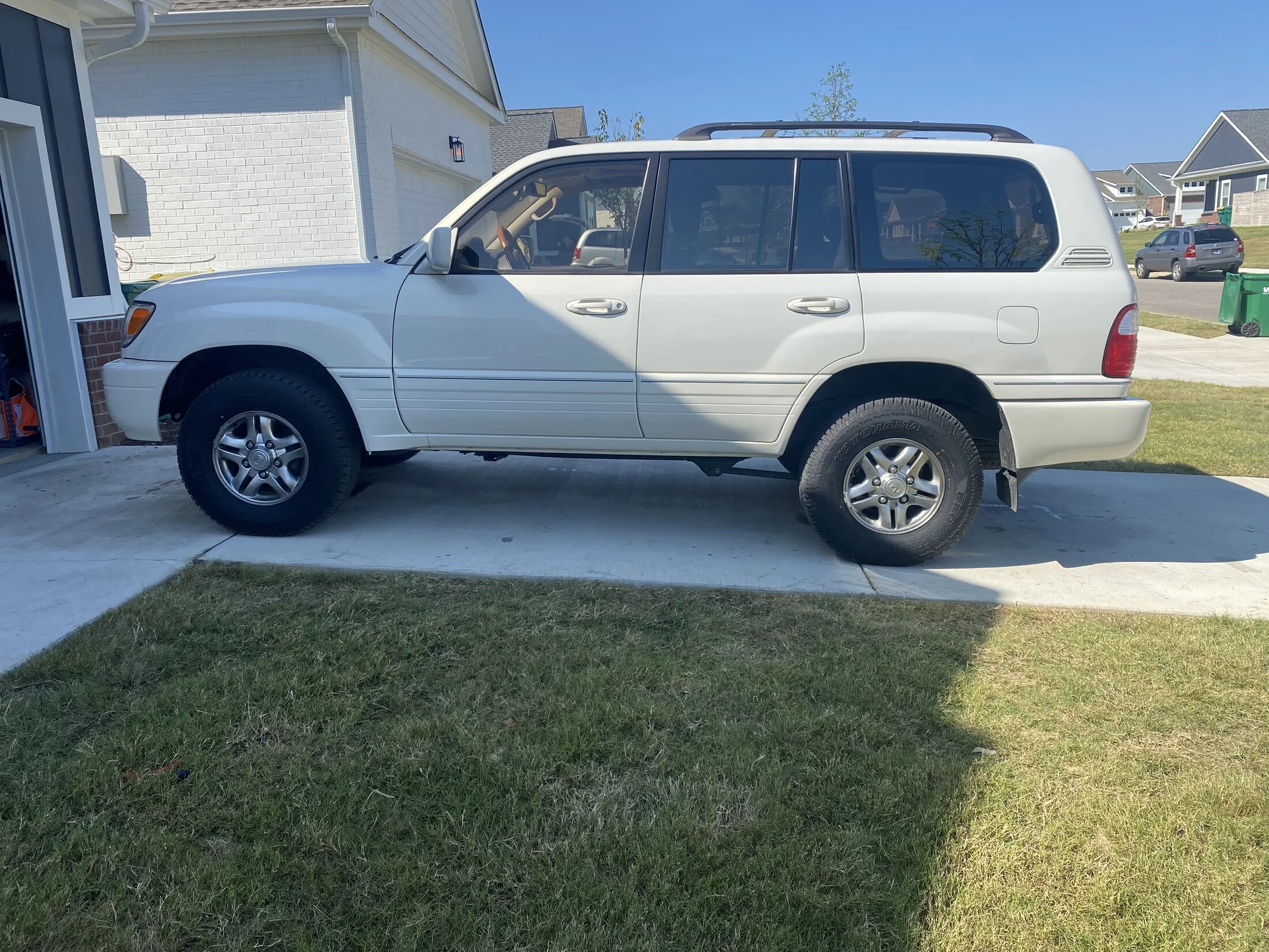

Hey everyone. I’ve been a reader of ih8mud for a while and have benefited a ton from a lot of the knowledge shared. I have an 02 LX470 with 150K. Timing belt was replaced at 125K and I just replaced the heater T’s. It still has a functioning AHC system (which could use some love). I’d love any suggestions as to what to prioritize next as far as maintenance goes. If anyone in the Nashville area ever needs help with anything, reach out and I’ll do what I can for a fellow LC enthusiast.
Sweet rig!
