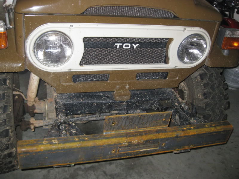

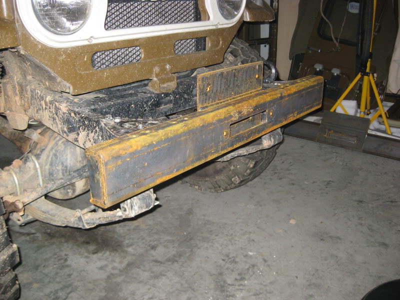

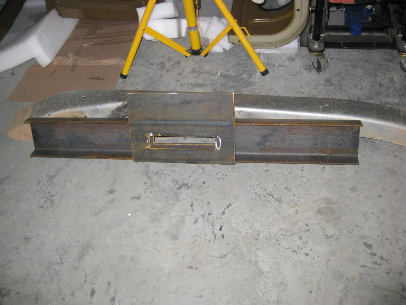

So last week in VA while I was on vacation I picked up a couple of bumpers I had a friend make for me.
One is 1/4" bent steel with the winch plate and end capped, I ordered some weldable clevis mounts and will have Eric weld them on for me when they arrive. I left them out in the rain for a couple of days as I was told new steel had a lot of oils in it that would cause paint to not take as well unless you let them surface rust before cleaning up and priming and painting. (since I do not know, I listened).

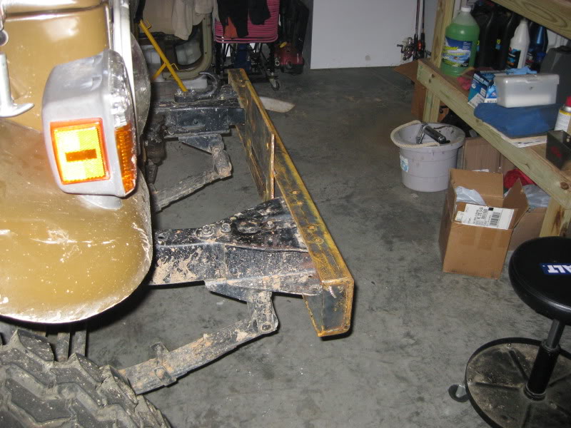

Anyway, the 2nd spare bumper is out of 5/16 structural channel and I will need to do some grinding then drill the mounting holes myself later which is why it is not already drilled for mounting.
Here are some cr@ppy pics. More as I prime and paint. If anyone has interest, he is able to make some on a small scale and the pricing is reasonable..around 150. Pending how much different they are from the drawings I sent him.
Mine are 42 and 5/8W x 5"H
This is the 5/16 structural one.
Slowly making some progress on the cruiser :D

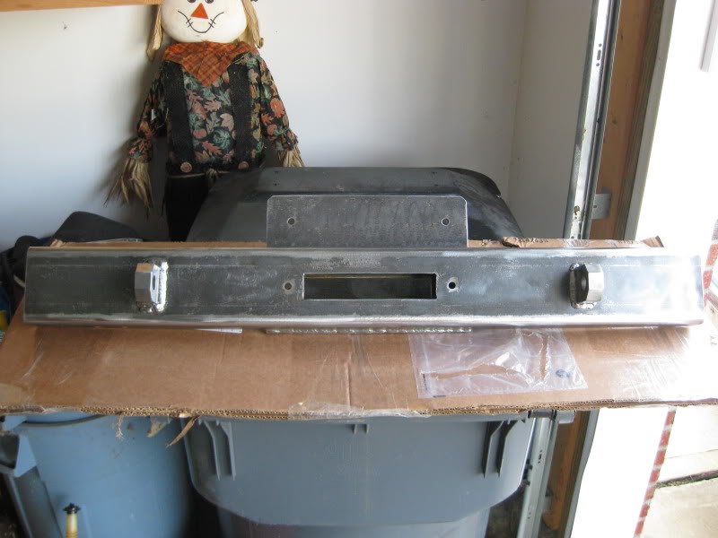

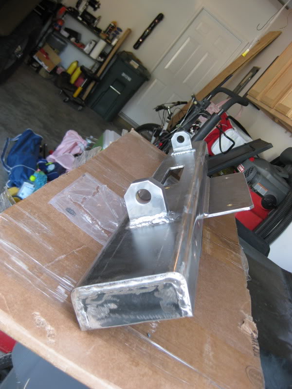

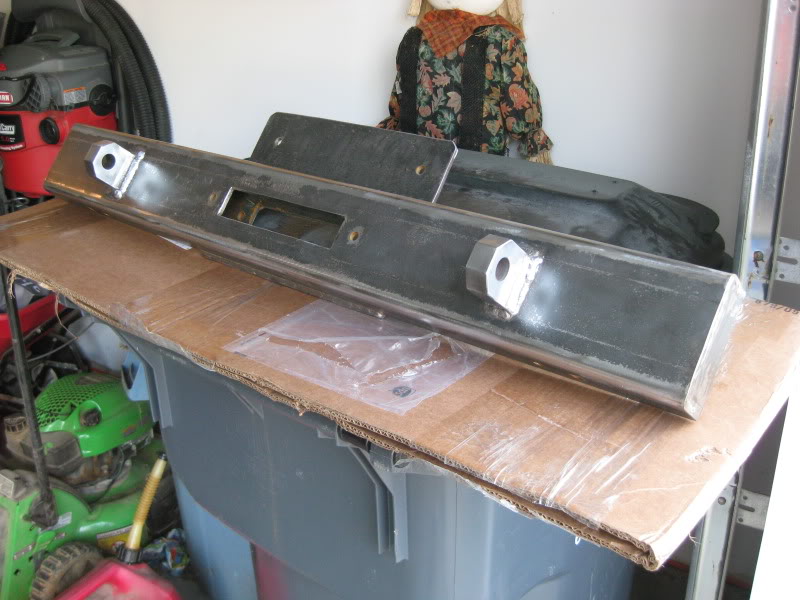

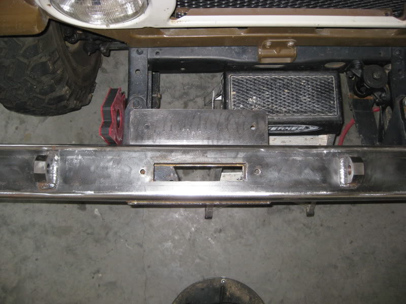

Hi All - been slammed at work and needed to plumb the new compressor, had fourtrax weld on my d-ring mounts and started grinding on the new bumper.
Couple of pics.
Starting to prime it today. slowly but surely.

I will try to get some more pics up in the next couple of days. I have just primed and painted the entire bumper, inside and out. No the cable passthrough is not closed up. cannot see a reason to.
