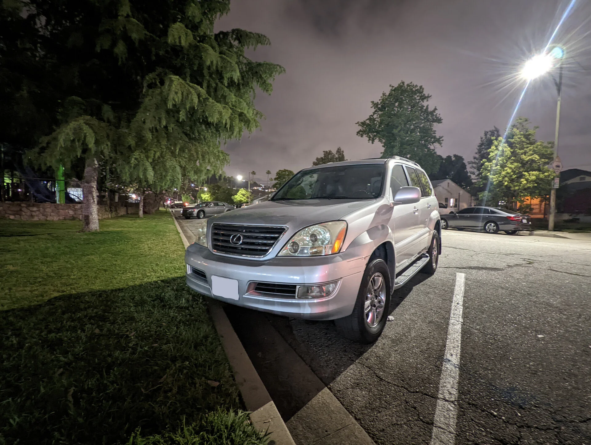

Hey everyone, I just bought my very first GX470 and plan to slowly turn it into an off-road/camping vehicle.
I bought a Silver 2008 model with gray interior and the red(ish) wood trim. I'm told that combo was pretty rare? I bought it off a Lexus master mechanic who had maintained the car beautifully. I mean, this car is mechanically immaculate. My mechanic came with me to check out the car and he said I'm essentially getting a brand new car.
Anyways, aside from going off-roading with my buddies in their cars I don't really know much about the world of SUVs and off-roading. I've always been into small lightweight sports cars, but I'm excited to learn more and dive into the world of all terrain.
Here's the only picture I've taken of it so far.
Cheers!
