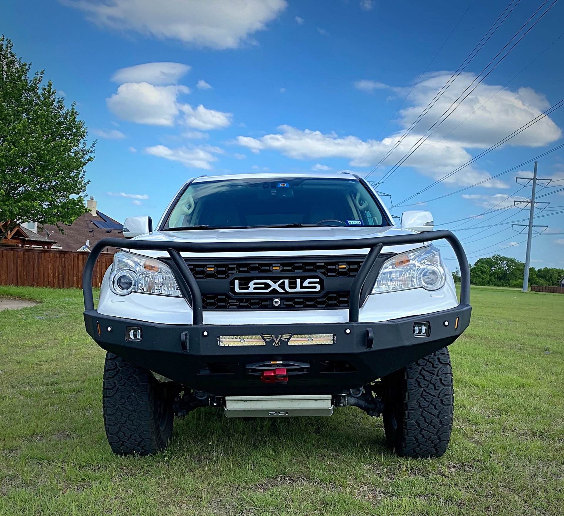

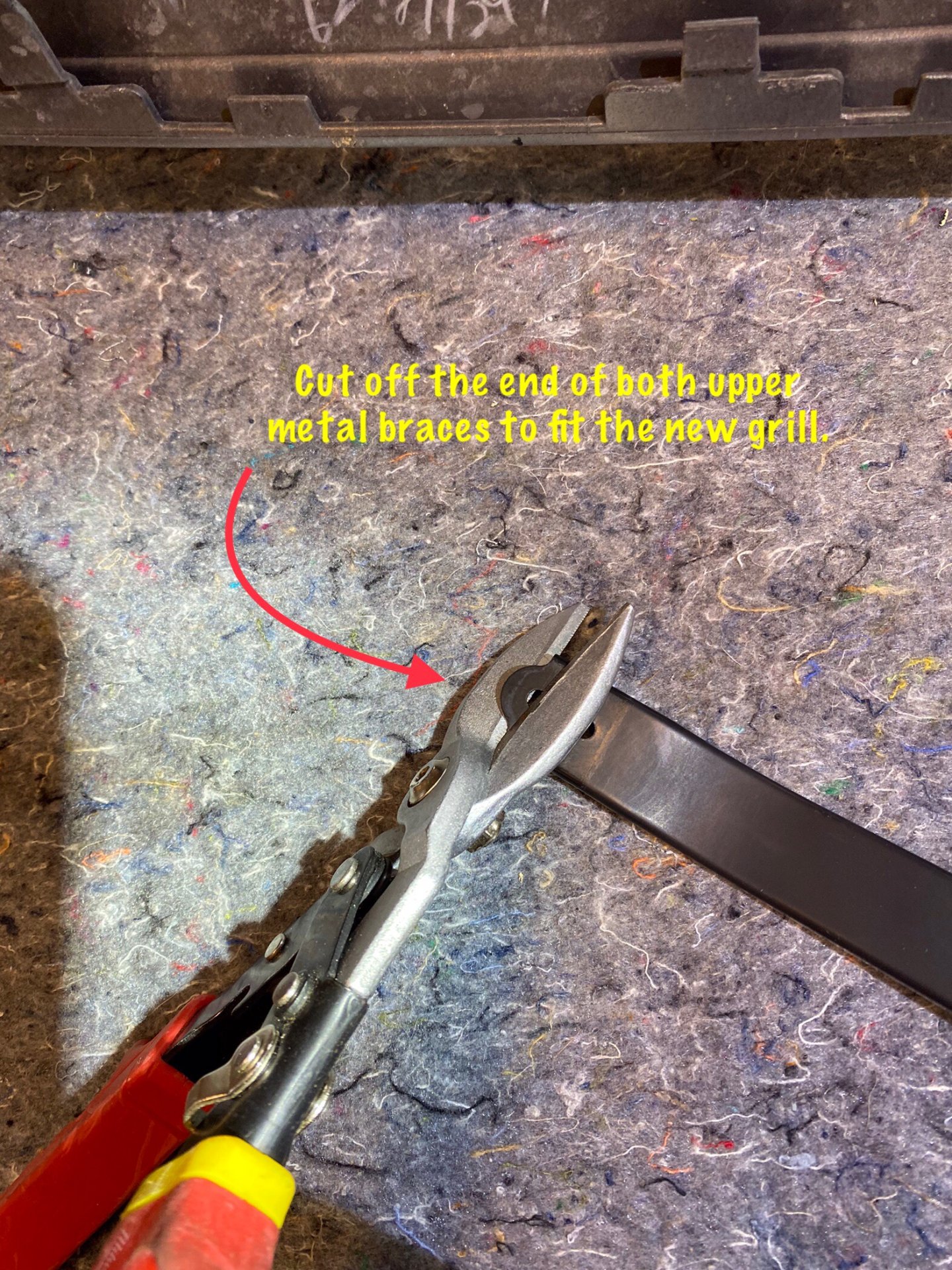

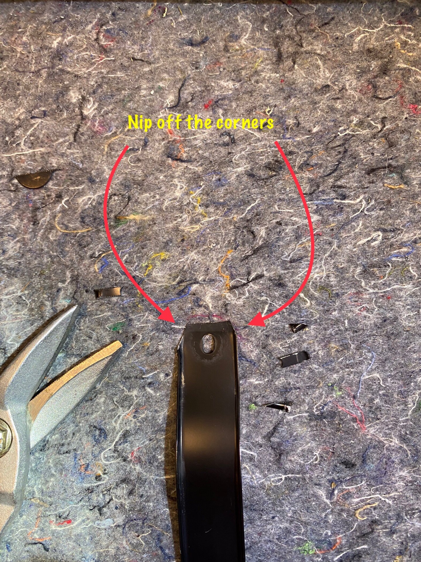

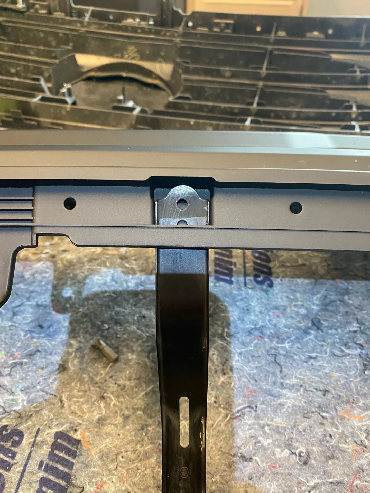

I came across this front grill sold by Garage Alpha.com I have a 2013 GX with adaptive cruise and the front camera for park assist. Below are some findings installing it. It’s just about as plug and play easy as can be. Just a couple of snips with the aviation tin snips and your done. I of course filed down the sharp edges but I over think most things. Check out the pictures below.

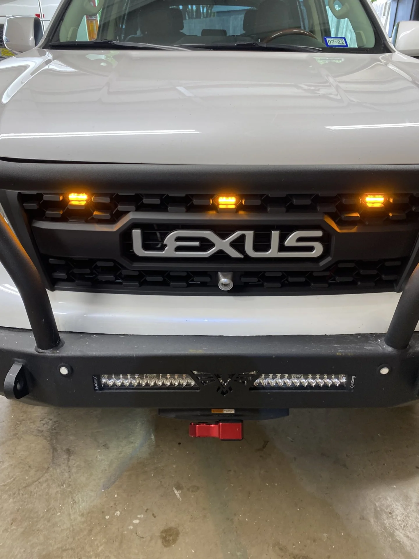

How long did it take you, before connecting the lights, and how much longer to connect the lights?
Also, where did you plug the lights into? Have any pictures?
Love that look!
It only took less than an hour to change out the grill. Super easy. 10 mm socket, snips and a pair of needle nose pliers.
I am doing the lights next. I will tie in the two marker lights that are in the bumper for the 14 & up models. I’m going to tie them into the drivers side running light. It’s an easy access point on the 10-13 models.
I will post a few pictures of course.
