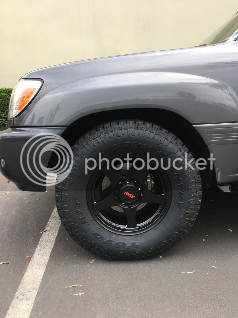

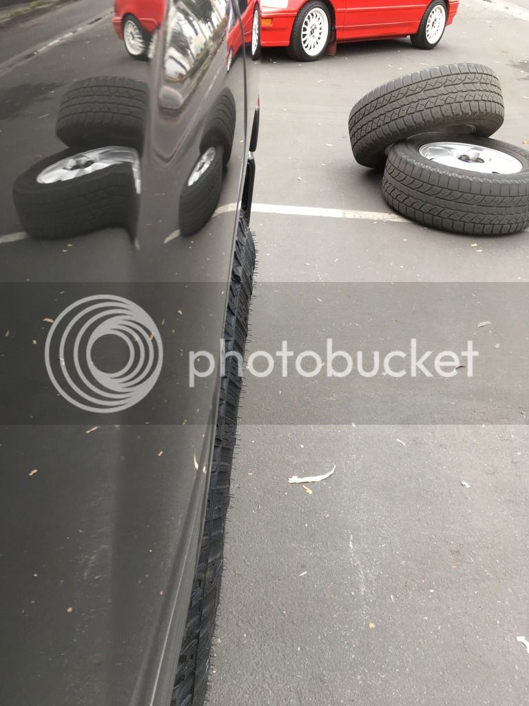

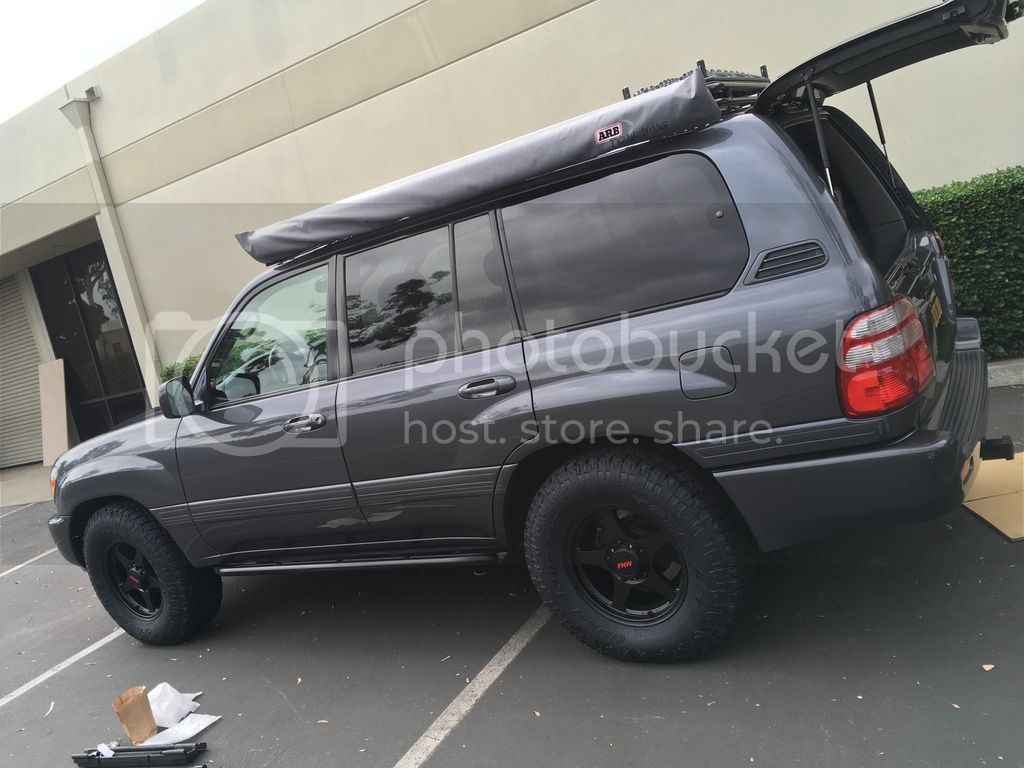

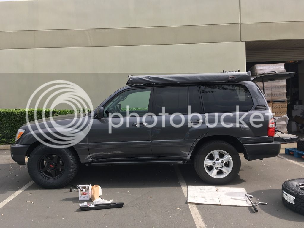

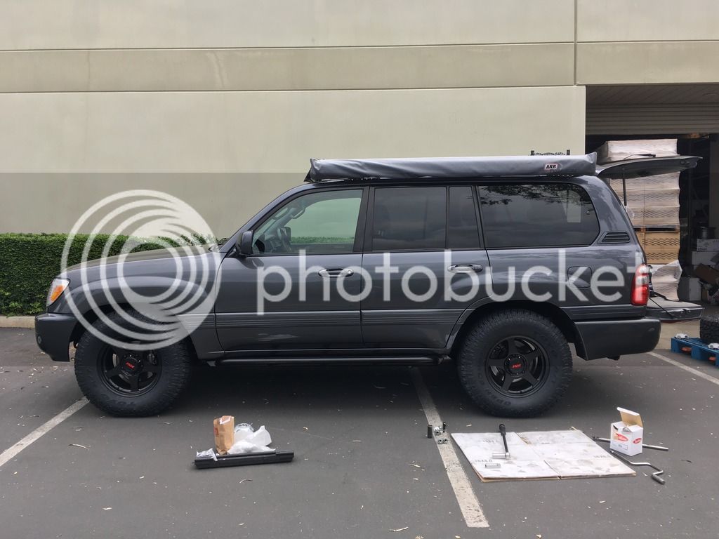

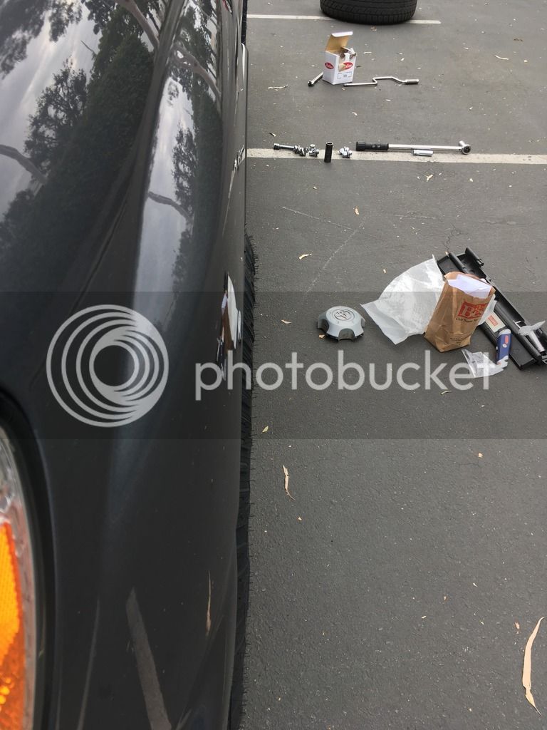

Just picked these up today. Dustin is awesome to work with. He can be reached at 855-WHEEL-00 (855-943-3500)
Wheel 17x8 5.7 BS. +30 offset Wheels weigh only 19 pounds each. Load Rating is 2500lbs
Tires Toyo AT2 285/70r17
Slight rubbing on the rear of the front fender liner when turning. Stock suspension.

Are they +30 offset all the way around?
Thanks!
Yes. They are +30 all the way around. The fronts stick out a tad more than the rears. Prob 5mm or less
Curious how you mounted the awning? I have the same awning. Do you have an aftermarket roof rack?
