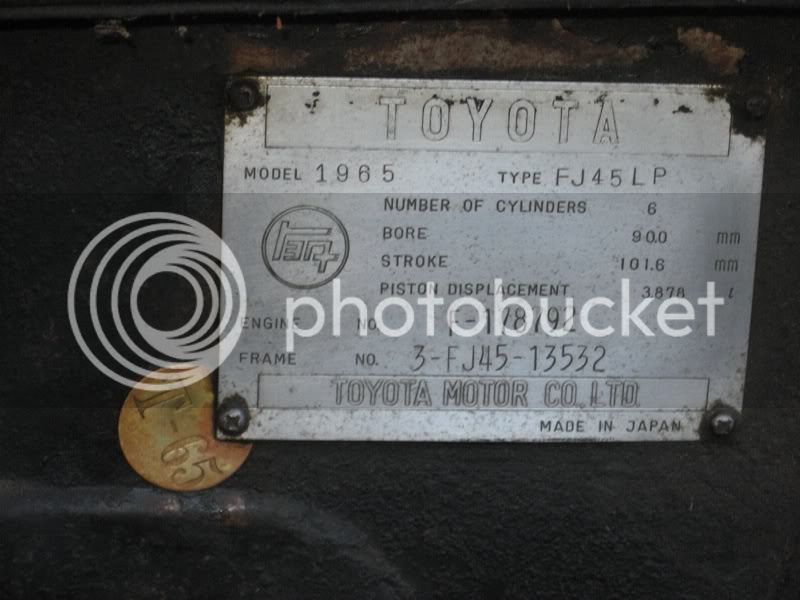

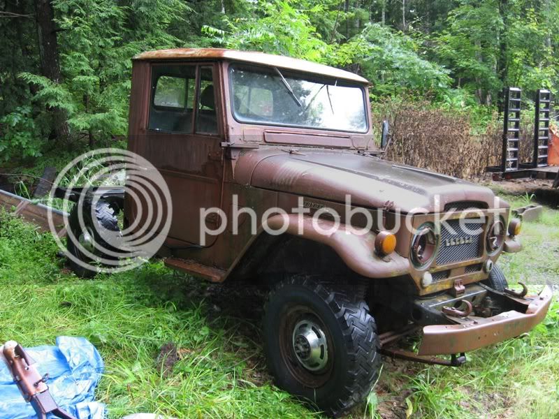

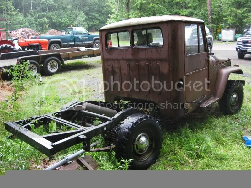

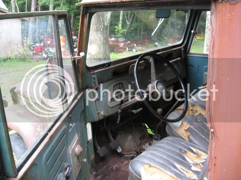

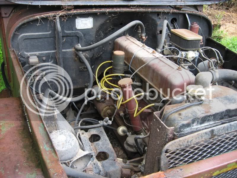

Here are the pics I promised, as well as a shot of the ID plate.
The spare frame VIN is 3-FJ45-136669.
Comes with a bunch of original parts from the stripped chassis as well. No bed unfortunately.
Any additional help ID'ing these would be great!
I don't know if it has been pondered or looked at seriously, but you might try to find a Toyota Stout bed to look at and measure. It looks a lot like a 45lpb bed but 3/4 length(ish).
might be closer to the crew cab version bed...

I believe that is a '63 short bed you got there...(the 3 in the frame number tells us this)...which is very cool!!!
The short bed on the '63 had the tail lights on the back "bumper" like the early 40s, and not on the back of the tub, and the spare is on the back as well! The biggest complaint I have read is that they are a tight fit for bigger drivers...apparently uncomfortably so :frown:
Looks pretty stock...apart for the floor shifter...so what are your plans for her...a rebuild with lift and all that, or a good/true restoration?

If you clean off the disc on the lower left corner, it should read T-65. I believe the brass tags were installed when the vehicles came into port and designated the year the vehicle was to be registered as.

Thanks for the info!
I thought it was a 63 as well, but the model# said 65 and it is titled as a 65.
Does anyone know why Toyota did this?
The frame # seems low like a 62 as well, but obviously doesn't have a "2" in front of it.
The good news is the engine body and frame #'s match.
After talking to the owner some more, I will be picking up an spare engine, trans, an extra pair of doors, original manuals and a couple boxes of loose parts.
Thanks rockcod, that info is helpful as to the frame# vs year discrepancy. I'll check that tag.

Turns out the engine was completely torn down and rebuilt about 10 years ago.. its got a new clutch as well. As I understand it, very few miles, if any, were put on it after the rebuild. The PO lost interest after that and it has been sitting ever since.
Also cleaned up the brass tag you guys mentioned, and sure 'nuff.. the T-65 plate is there:
